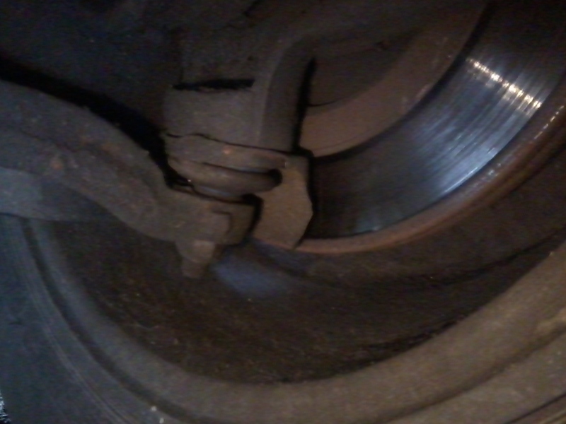

Re: ball joints - I've been thinking about them recently, perhaps because I've changed 5 in the last 10 months! Or perhaps because I'm an anorak? The ones on my silver BX were loudly knocking after only 12k miles, and the advisory BJ on Timex hasn't lasted very well either. Yet I fitted the same make to mine earlier this year, and have now done 13k miles on them with no detectable play. I was a little worried about the lifespan of mine after hearing about Mike's!
When I was at the garage getting them to remove the BJs from the hub (I gave up after ripping the large vice from the workbench at work They had been on for over 200k miles though.) the mechanic mentioned the disc heat shields on the hubs for my red one. He commented that most people chuck them away when fitting new BJs. The silver BX certainly didn't have them, and neither I think did Timex. It's just a speculation but I wonder if heat from the disc could be causing premature failure? Of course, it could just be down to lower quality parts but I used Lemforder ones, who are supposedly the OE supplier.
Re: Insert witty title here ...
So should there be shields like on the rear?
All Timex has is some sort of scoop arrangement to direct air to the calipers. I suppose that excess heat could melt the grease in the ball joint.

Not like the rear shields - they are much smaller and only protect the BJ. They are pressed steel with a ring fitting over the castellations, then folded in a simple right angle shape, possibly slightly curved around the BJ boot. Will try and get a picture!

Just for you Mike, here's a picture of my BALL JOINT protector:
It's kind of a good job I did take a look, as I noticed a small split in the CV boot which was new on this year
Ah - looks easy enough to fabricate, although I can see how they get discarded - I bet it's much easier to fit the balljoint without it
