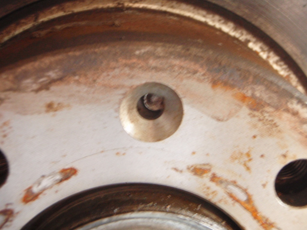

In other news, I managed to spend a morning down with my GT. Haven't seen the old gal for a while so it was very nice.
First job was to inspect the rear brakes and new bleed nipples, oh but I left all my stuff that I wanted to bring back at home, so straight back home again... Bleed nipples are too fat by a very small amount, and as the old ones were in such good nick I just put them back on. Rear pads have hardly any wear at all! You can see the new one on the right and two old ones on the left. They were so unworn I didn't even bother looking at the other side. So re-shod rear wheels back on and off with the axle stands.
I noticed that the rear passenger disc has sheared it's retaining screw too, this wasn't me but interesting.

The brake disc screws serve no purpose once the wheel is on, so not a big deal if missing/snapped.
