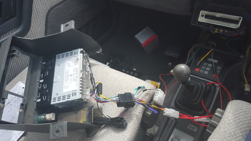

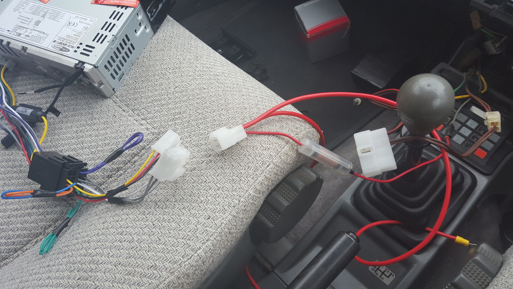

The first half and a bit of the day I spent wiring in the new head unit. As a wiring novice, I tried to get as much prep and planning done in advance so I, hopefully, knew what I was doing. I took a trip to Halfords to get some wiring essentials - namely a couple of connectors, some decent wire and an ISO plug to butcher so I could connect the headunit to the GT's loom.
I wanted to make the car friendly to future head unit swappage - I used a new ISO connector, cut the superflous end off and went about wiring it intot he GT's loom. The original radios supplies left a couple of wires outstanding, so I had to find an earth and a switched live feed. Thankfully Rich had recently put in a temperature gauge for me, so I used the samee earth and switched live points as that did (this head unituses the permanent feed as the main power source).
I ended up with this, complete with my sribbles as to the wiring routes. The two lower wires are the bluetooth antennae and microphone jack, and the folded taped wires are rear speakers and aerial-pop-up signal. I split the plug connectors into speakers (the 8 way white plug) and the power and earths (the white four way plug) for simplicity. Hopefully now, with future head units for this car will just be plug and play - although I like this one so far.
Other endes of the plugs, earth, switched and permanent live and draped artistically on the gearknob - the speakers wire. I think I went a bit OTT on the wire I bought, the live feed is fused with 10A, so I though I should buy wire with at least a 10A rating, all halfords had was 5A or 17A, so went for the oversized just because, puts the loom wires to shame! Is the biggest one there.
All plugged in and ready to start putting the dash back together, worryingly I had a screw left over or loose etc... Could not see where it came from!
The finished product, looks quite similar to the old radio, but it's a shiny finish which lets it down slightly. It does however have Aux, SD card, USB, bluetooth and CD inputs though - so a very useful piece of kit. It also has 4x75W pre-outs which should help with the sound quality and volume. Because it's a flip front, it unfortunately sticks out an extra inch which is less good.

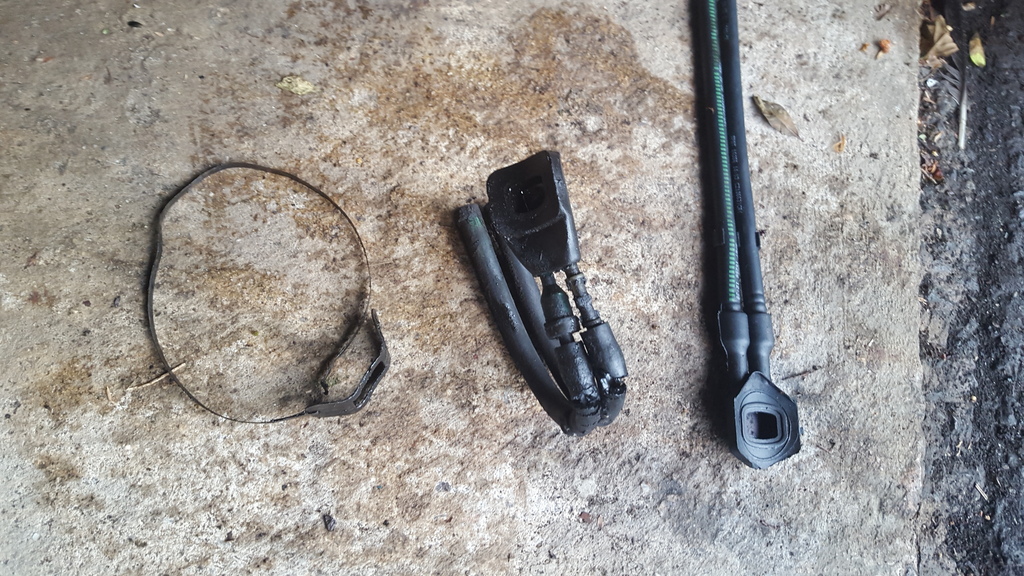

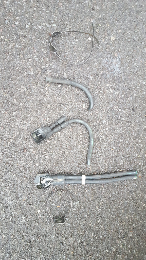

GT almost ready, strut returns now sorted - they were more than split, they'd actually broken off at the ends! WHat a fiddle to do, managed to re-use one clip, but the other is temporarily help with a cable tie (using the 'head' of the busted clip that the base of the return sits in, on the strut to stop the cable tie deforming the rubber and creating a leak).

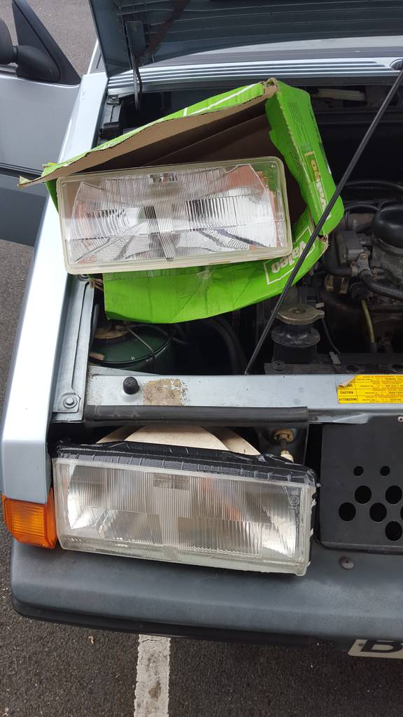

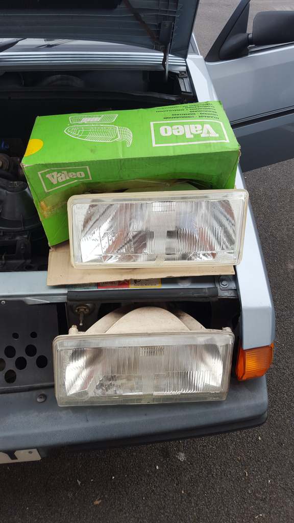

Meant to post a small update pre-national but computer was off being refurbed so couldn't. Been meaning to put the new headlamps on the GT for a while now! It came with 2 lovely new Lucas headlights, which is great. The light output difference between the two is marked! The old had about half-to-two-thirds of the silver stuff left, and the glass fell off the drivers light on the ferry back from the challenge...
