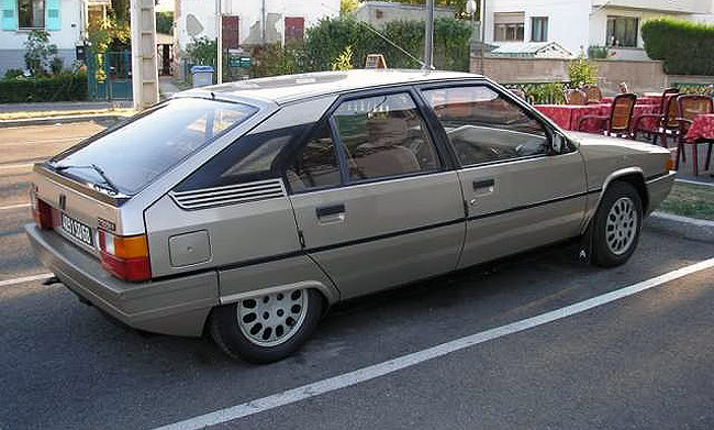

Post by Paul296 » Thu May 03, 2012 6:28 pm
Well, seeing as I'm not allowed Professor Pat Pendings car (thought not :( ), I've had my eye on this on Leboncoin for some time now . . .
Mk1 16trs 72k. lovely condtion. great colour, 3000 euros. A lorra lorra money (as Cilla would say) but if it was an auto with air con and metric alloys, that's about as near to my dream BX as I can imagine (probably has windscreen wipers as well for all I know!? :D )

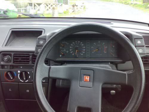

Post by electrokid » Sat May 05, 2012 10:01 pm
Get a temperature gauge. Screw originality, head gaskets are expensive!
Agreed - to retrofit one as Mat has done you'll need the instrument pod from another model - keep an eye on eBay or put a request in the For Sale and Wanted.
I suggest you keep the original speedo and just fit the extra gauges you want. The jury is out when it comes to which sensor is the correct one - I got one from a Citroen dealer which was inaccurate - unless you think that water under pressure still boils at 100 °C of course.
when I get to better grips with auto-electrics than just about being able to hold a multi-meter the right way up.
To test the sensors hook up to the DMM and dunk it in boiling water - at 100°C they should read 130°Ω - oil temp and water temp are the same.
There is one thing I would suggest you check first though - the fan operation. The temp switch is at the bottom of the rad - it's under the rad filler so gets any spilt water and also road spray in the rain. Wiring goes to a connector which is in an area under the NS headlamp - both these connections are subject to corrosion so it's worth checking the fan on a regular basis.
Get a knife blade such as a Stanley and use it (without shorting the knife to chassis) to short out the connections at the rad switch (engine running of course) - it uses a fair amount of current so it'll spark.
Another mod which may be easier is to fit a double switch (there are a variety of temperature combinations) and an extra fan - there is the space to do that and some models have 2 fans as standard.
