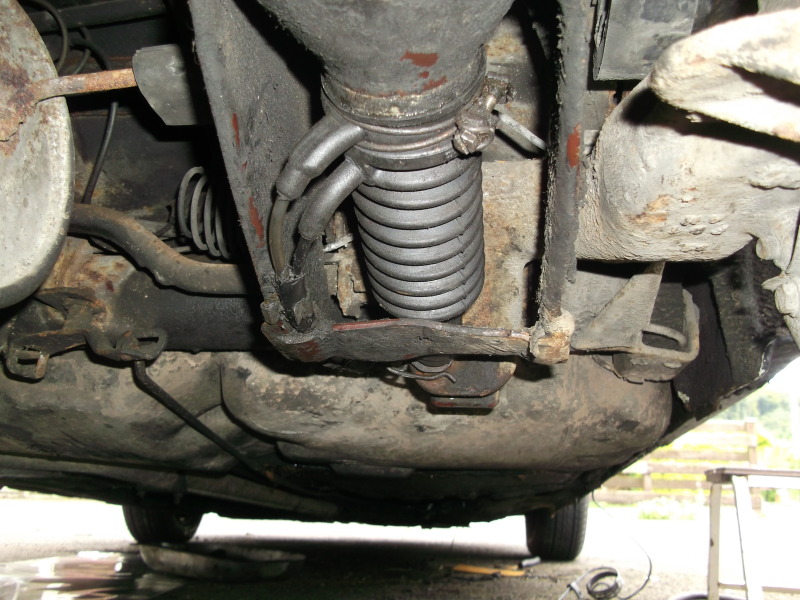

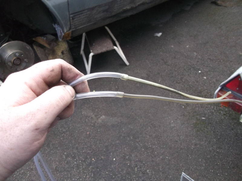

Spannering and painting day today! Started off by repairing the return pipes from the back of the car:
Basically replaced the damaged sections with plastic pipe from B&Q - not sure how long it'll last, so I'll monitor things.

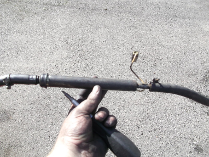

Then stripped out and replaced the fuel supply and return hoses that run up the back of the engine. Both were cracking where they fit the steel pipes running under the car, plus the return had almost chafed through in one spot. Removal wasn't helped by some zip ties in inaccessible places. Supply has this thing in it:
I'm guessing it's a fuel heater, but whatever it is it wasn't wired in - one of the connectors had come off.

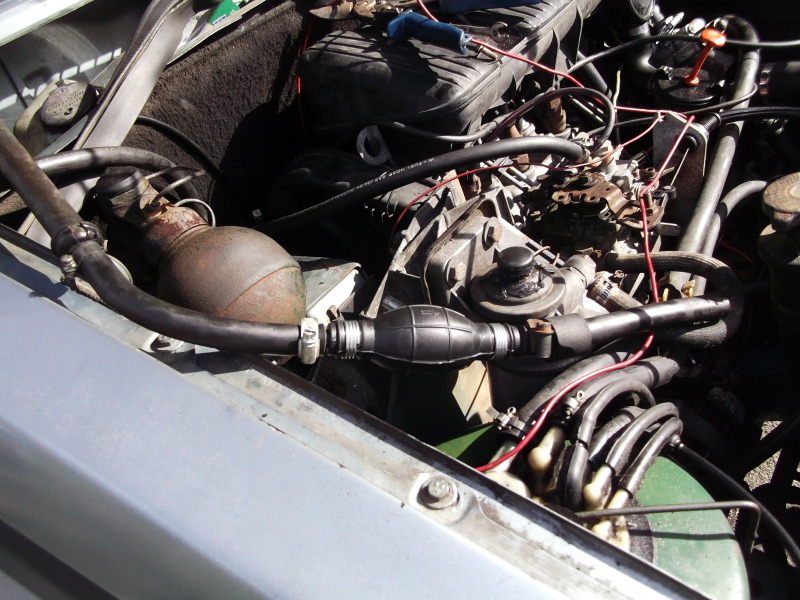

I also took the opportunity to plumb in an in line primer bulb:
This will avoid the risk of damaging the diaphragm in the top of the filter housing by using the primer in there.

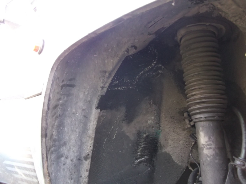

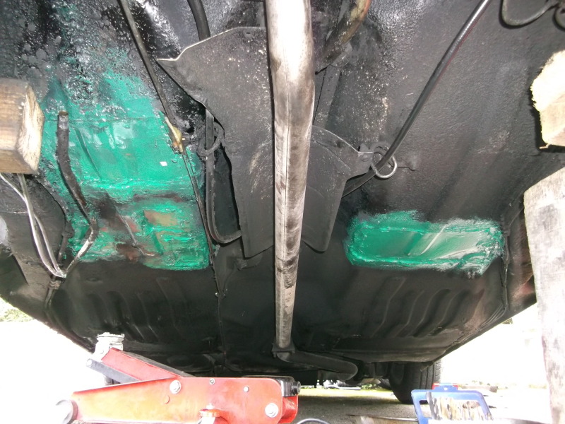

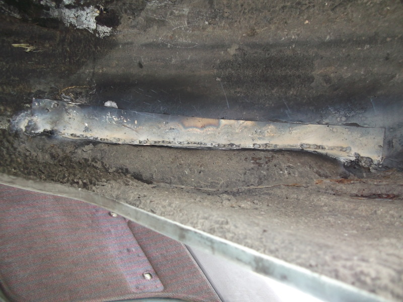

I then painted the underside of the welding repairs in Smootherite, simply because I was given the paint
This was followed by underseal:
Once this was done, the fuel and hydraulic return lines were mounted up underneath, the wheelarch liners refitted and the guide for the height adjustment bar fitted to the repaired floor.

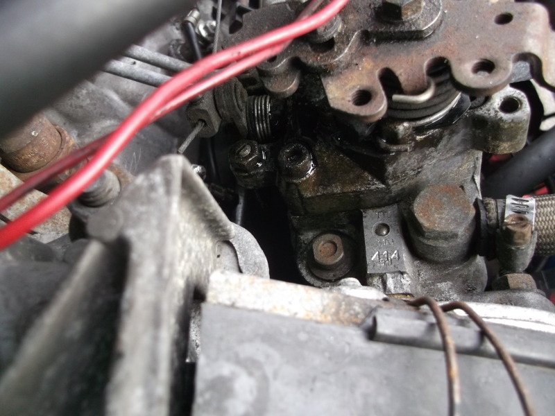

I primed up the fuel system, but noticed something odd - is there supposed to be diesel dripping from the back of the pump when you prime it?

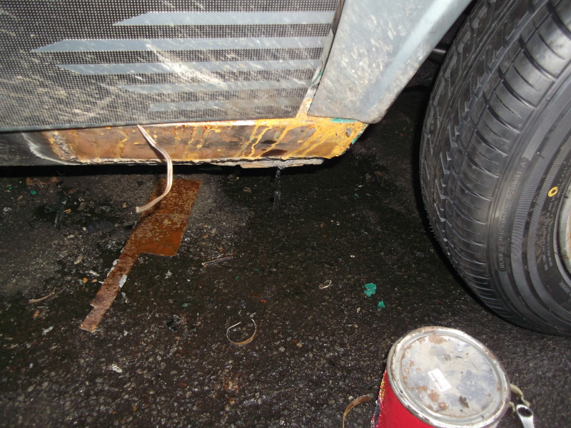

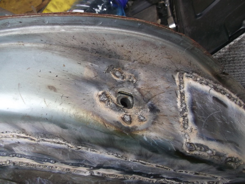

Front wheels back on (with trims), and I let her back down to the ground, to have about a litre of water pour out of the drivers sill where I'd cleared the drain:

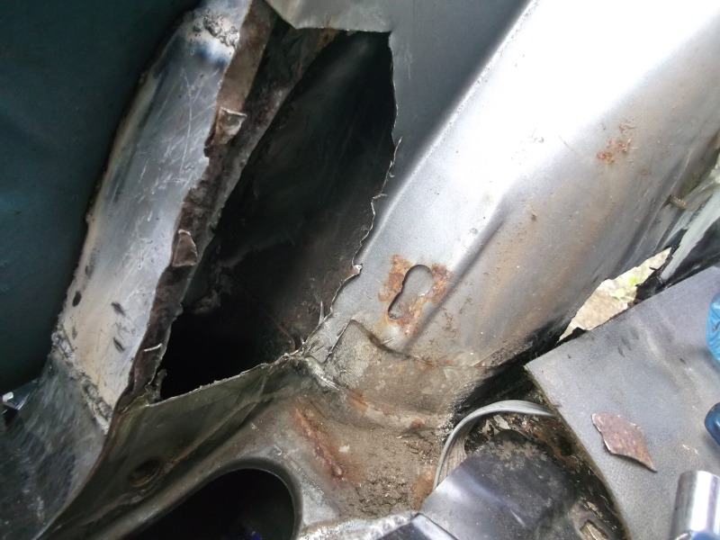

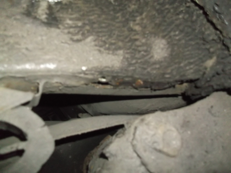

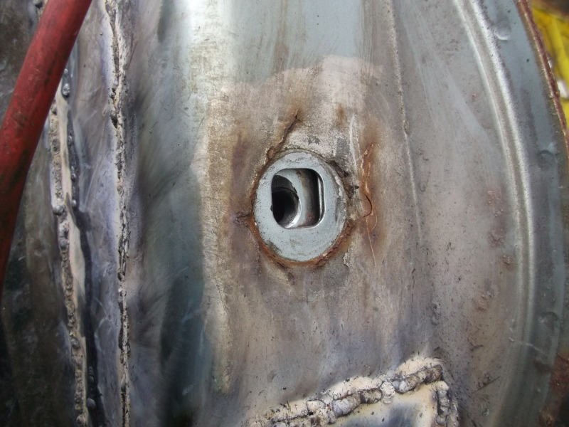

Next I jacked up the rear end in preparation for replacing the rear cylinder cover. Of course I had to go poking round

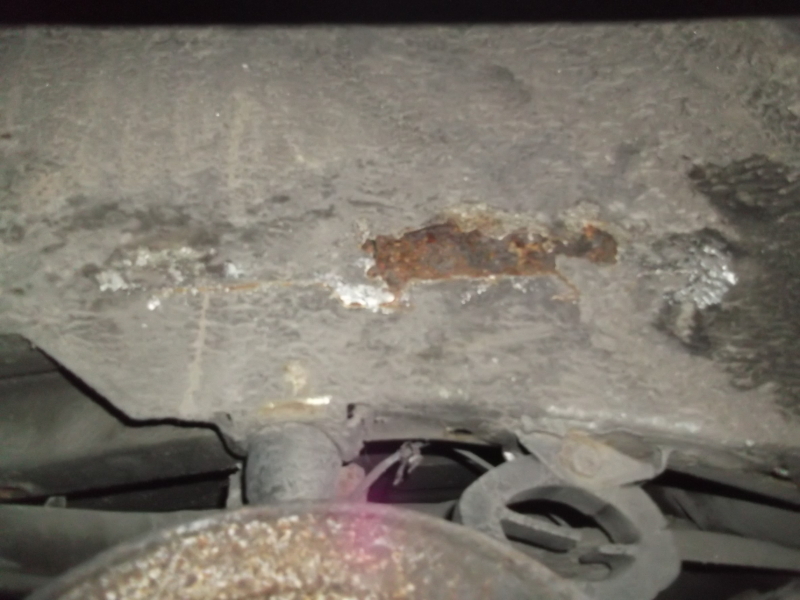

This will all need welding then:
Finally - it looks like there was some kind of stoneguard here?

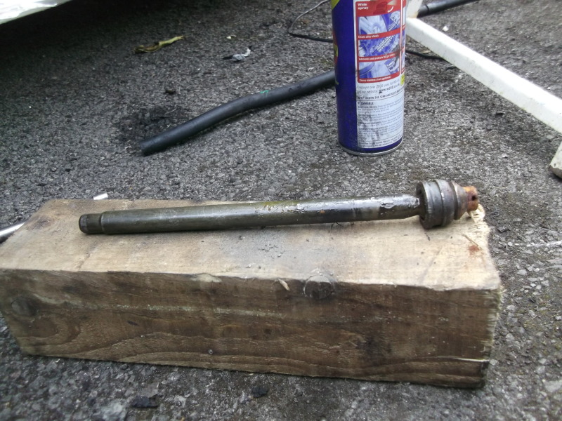

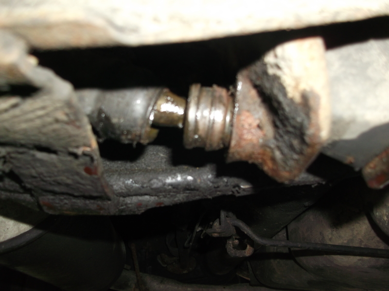

Started on the rear cylinder cover this morning. Needed to spray both the front clip, the end of the rod and the cover clamp with WD40, but it eventually started coming apart:
Luckily everything under the cover seems to be in really good condition:

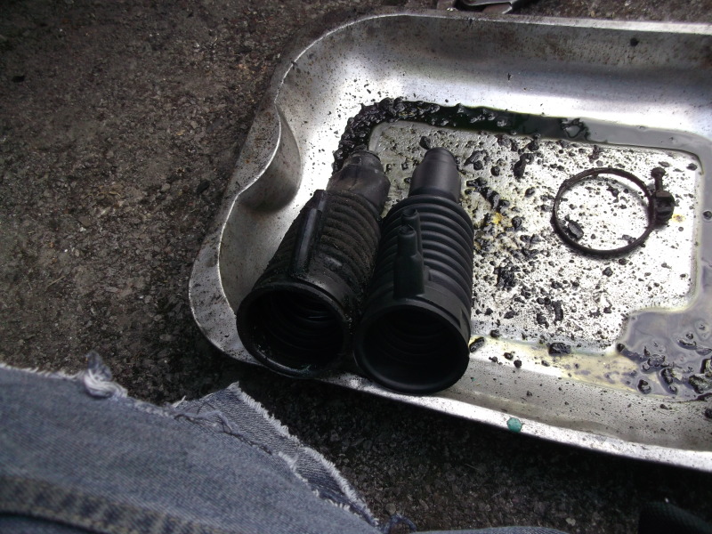

The new cover is slightly different to the old one, with a beefed up outlet where the old one split:
After a bit of trial and error, got it all together. Best way I found was to fit the cover to the rod, then assemble the lot onto the cylinder (making sure you remember the clamp
). Jacking up the arm helped compress everything in to enable the refitting of the clip:

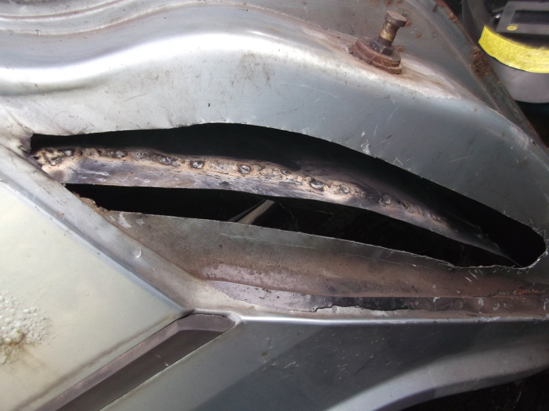

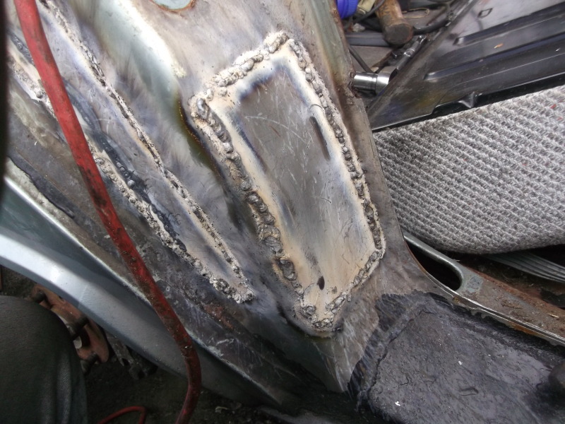

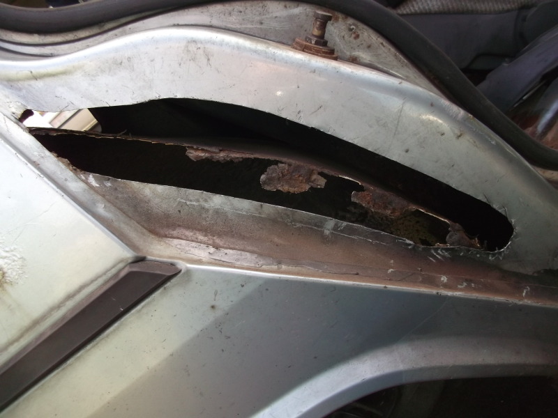

Then started on the C post, cutting out the rot in the outer face:
This piece of foam was in the bottom of the C post, where it had soaked up water then rotted the C post from the inside out:

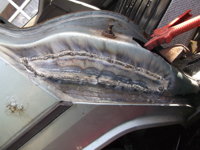

I trimmed back then repaired the arch panel, before welding up the C post and tying both panels together:

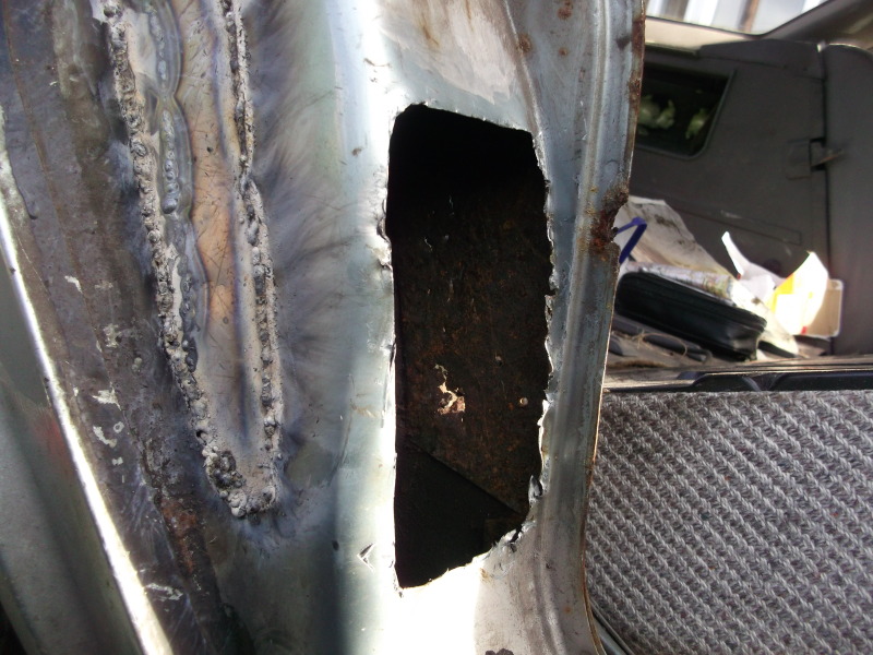

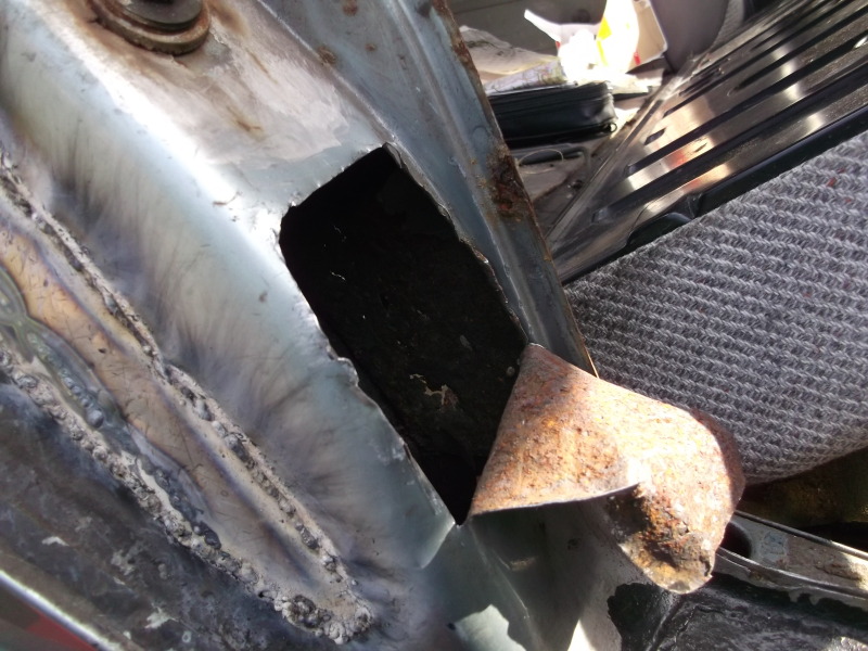

Next came the forward face, where the foam had rotted it:
There were also stress cracks around the door catch pin, which I welded up:
Finally, I cut the rust out of the inner section of the C post, cut the repair section then painted all the surfaces about to be closed in before rain stopped play:
