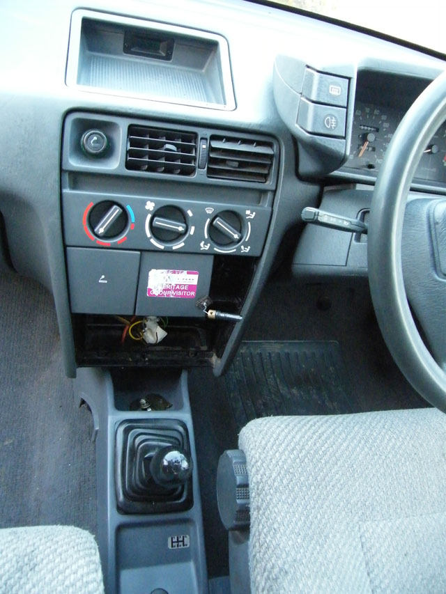

I had suspected the weird knob on the dash was the heater control. What's the missing panel in the centre console?

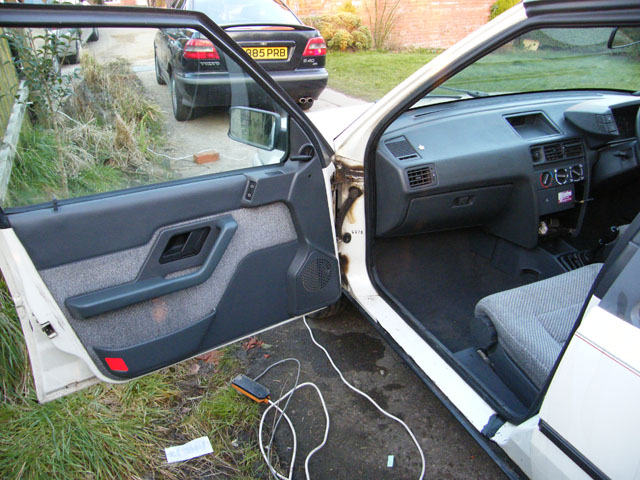

Put the dashboard back together so I don't lose any bits and gave the driver's area a proper scrub, vacuum and clean. Still have to repair and shampoo the seat, but it's good enough.

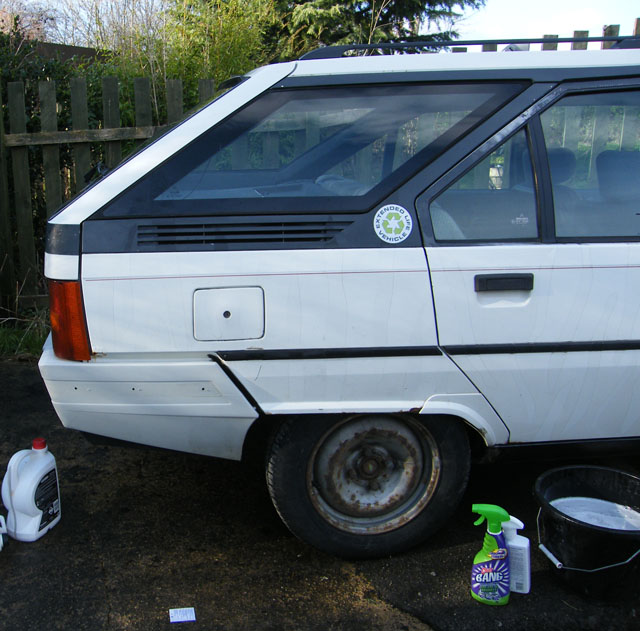

Turned my attention to the outside after that, starting with scrubbing the rear bumper with a stiff brush and some Cillit Bang that has listed 'wheel rims' as one of the cleaning uses. It's very good.

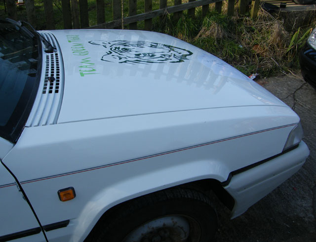

Gave the front wing and door a claybar workover, being able to put the suspension to where I want it makes those lower areas much easier to work on.
There's one or two dents appearing on the bodywork as I work through it as is to be expected, but they are difficult to photograph.

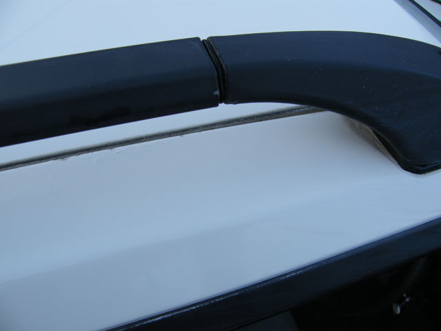

The whole roof has black tree sap spots on it. This comes off with the claybar and G3 just like everything else. I need to get some tar remover for the stubborn bits lower down the bodywork. I did get a good portion of the roof done.
I can't quite shift this bit of muck, I need to figure out how to do it.

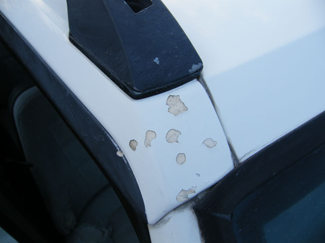

I'm also not sure what to do about this damage to the fibreglass, can it just be sanded back and touched in like you would on stonechips?

Easiest thing to do regarding the dirt around the roof bars is to undo the 4 allen bolts holding them on, then you can clean away! Two in the middle and one at each end - they may be under rubber plugs but they've probably turned to mush by now.
The chips can be touched up as normal.

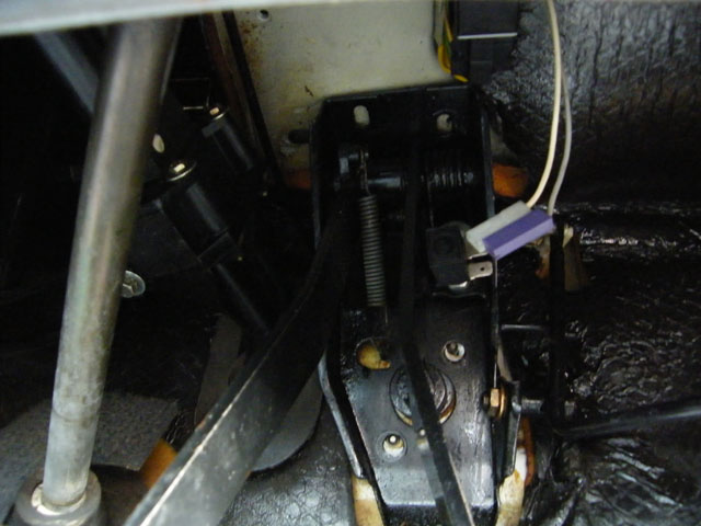

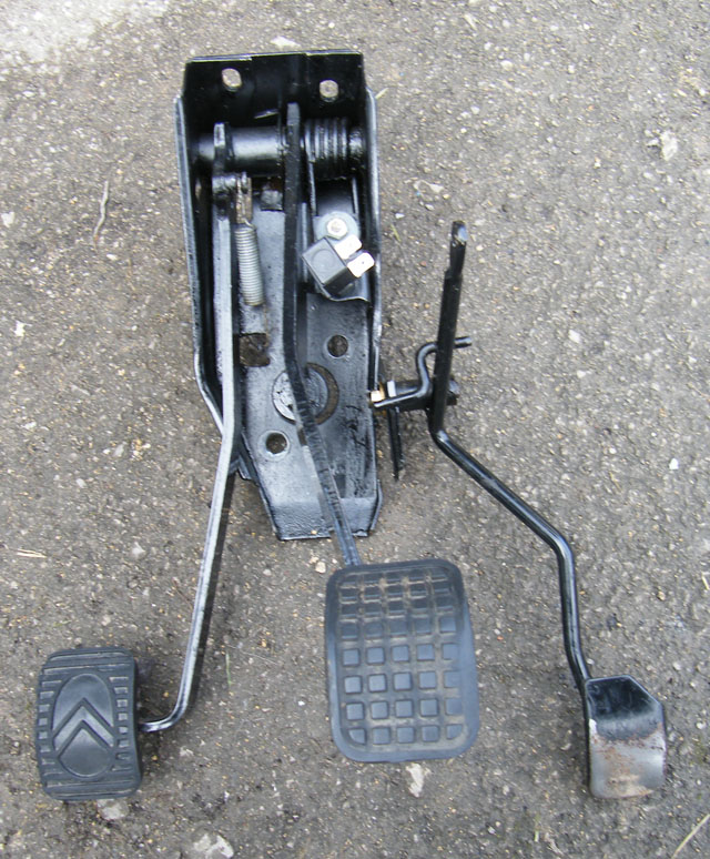

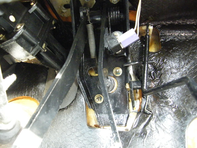

Today's challenge was to remove the pedal box so that I can get it repaired. Doing the repair in situ was not going to be possible, access is severely limited and there are too many meltable things that could melt too near the pedal box. Last night I hit the allen bolts a couple of times with a hammer and doused them in WD40 so that they might soak overnight. This is a method I've used on other stubborn bolts to good effect.
The two bolts that wouldn't budge yesterday put up no fight at all today and were a doddle to remove.

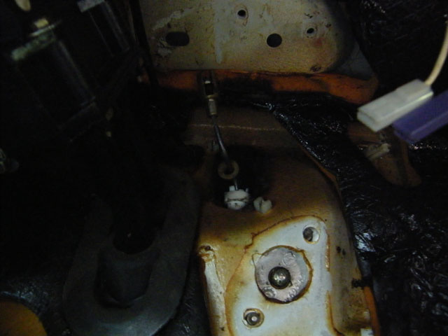

I couldn't find any definitive information on how to proceed from this point. The pedal box was now loose, but wouldn't come out and I couldn't see what was still attached. Dad disconnected the clutch cable (I didn't look to see exactly how he did this) in the engine bay which gave me a bit more play and then I just wiggled and the box carefully until it eventually came free. The plastic 'arrow' clip on the throttle cable came out very easily and cleanly, but then pinged one of the tines off without me touching anything so I'm going to have to fix or replace that now.

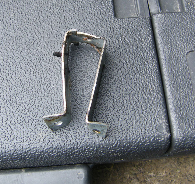

This little metal bracket was squished into the soundproofing under the accelerator pedal and I don't know where it should live. Any ideas?
One liberated pedal box, finally! I'd like a rubber tread for the accelerator pedal too, always feels nicer than plain metal.
It's quite badly damaged, there's no wonder you couldn't get any pedal travel on it. I've got some suitable bracing material after having seen someone else repair a pedal box this way and thinking that was a very good idea.

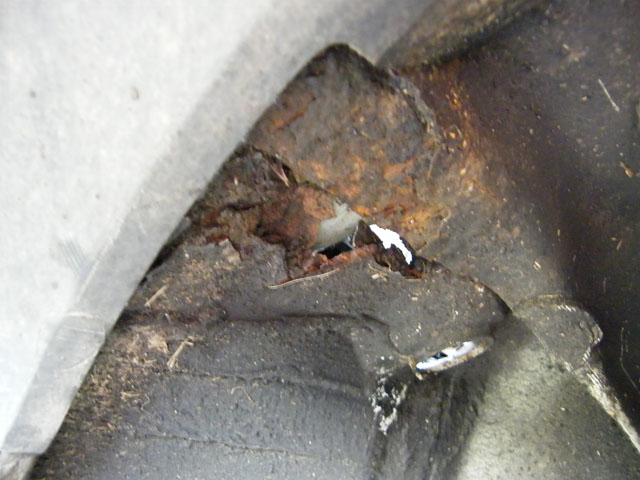

I wanted to have a look at the inner arches too, they're bubbling in the engine bay in the usual place. Some loose underseal had flaked off to reveal a couple of small holes, one each side, in a different place to the bubbling up top. I anticipated this so it's no great surprise, but the holes don't look as big as I was worried they might. In the meantime, they'll get cleaned up and Kurusted until I can get the welding paid for in a few weeks.

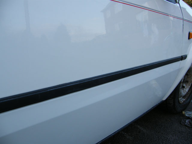

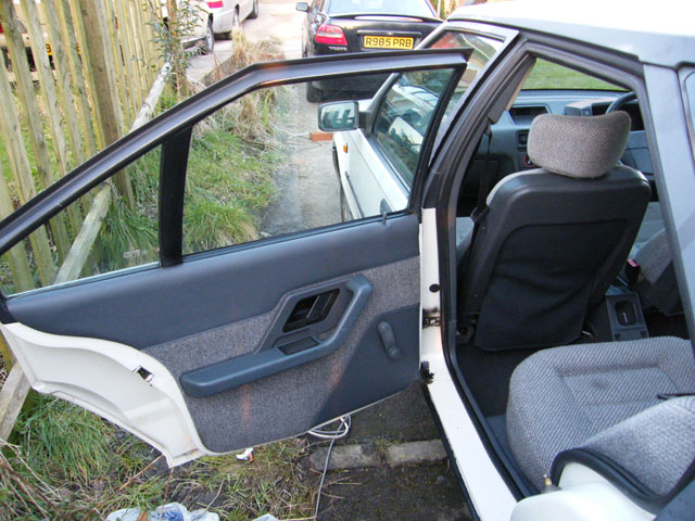

Rear driver's side door shut likewise cleaned up very easily needing little more than a quick wipe over with a soapy cloth.

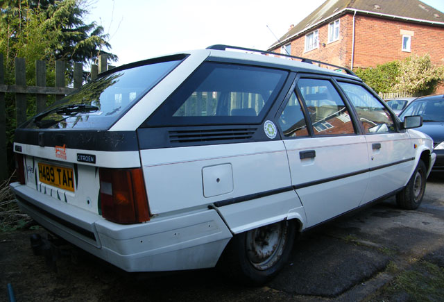

Here are some pictures of one (almost) finished side of the car. There is a lot more cleaning to do, but the stripes are gone and the true length of the car is much more apparent. The window surrounds (I'll be repainting those) and the wheels let things down a bit now.

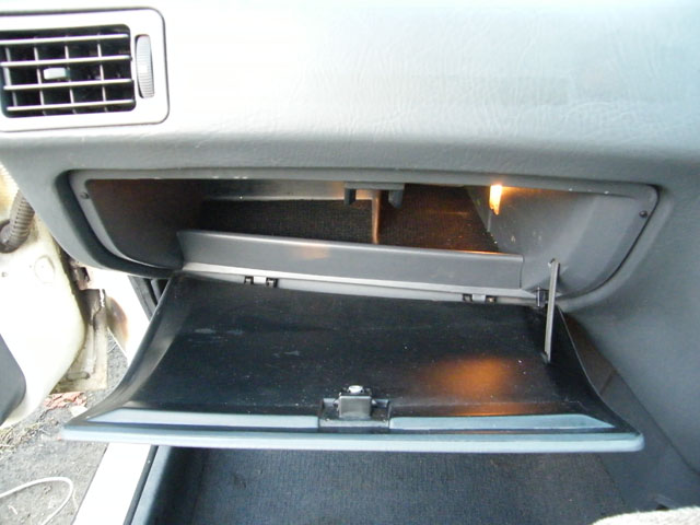

Glovebox hinges that still work! Apparently, these are usually constructed entirely of cheese.

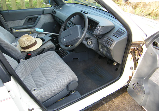

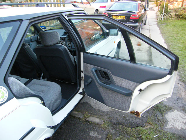

The centre cubby thing has the heater control bodged onto it, I need to take this apart to fix it properly. That cubby also doesn't touch-open like the ashtray does. The right hand cubby is completely missing, I don't know what should be there. Oh, and there's no radio but I do have one to go in.

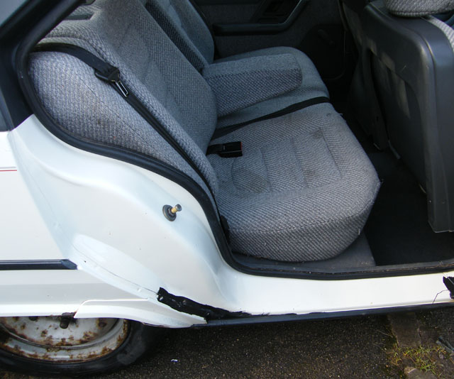

Back isn't too shabby now. I'm not sure how to reattach the vinyl cover on the front seat, it's come away somehow and has two rubber bands on it that I presume are to fix it in place. I'll remove the seat at some point to sort this out.
Ideally, all the seats need a shampoo and some loose threads catching, but overall they actually responded very well to a vigorous vacuum. The seats now smell a lot more like my Dad's old Peugeot that was similarly upholstered rather than like trees.

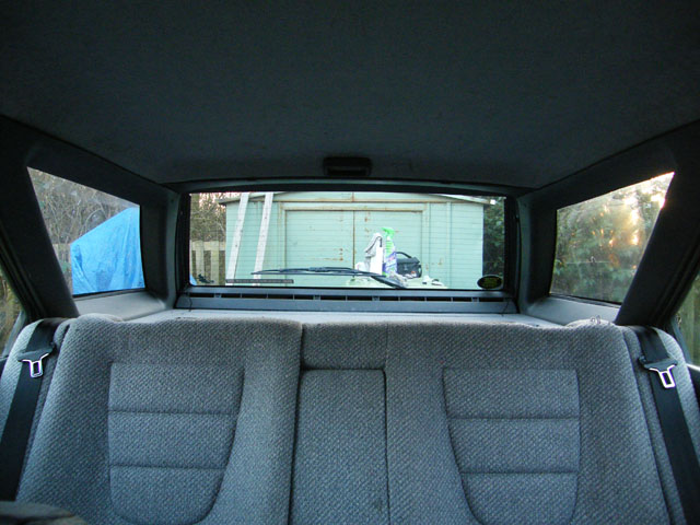

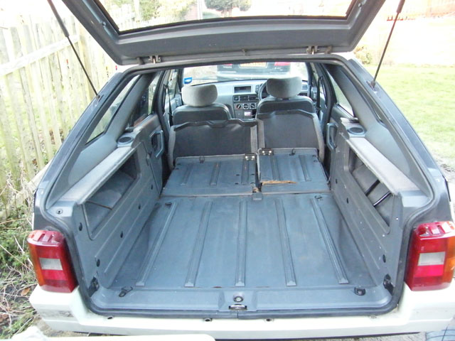

Cavernous loading area fully scrubbed. There's some areas that could do with further attention and some minor damage here and there as is to be expected so it's not perfect, but is tidy.

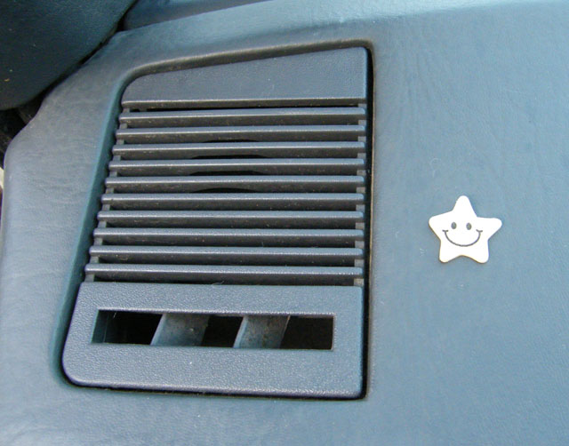

The dash had some stickers on that have left ghosting on the vinyl, The ghosting reduces every time I wipe the vinyl over so I'll just see what happens with that. I like the little star so that's staying.

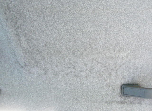

One thing I didn't clean was the headlining. The fabric of the headlining appears to be a patterned flock over polystyrene board so I don't want to scrub it or get it too wet. There's some black mould on the headlining which could do with being removed for the sake of aesthetics, and possibly health, but I'm not sure of the best course of action.

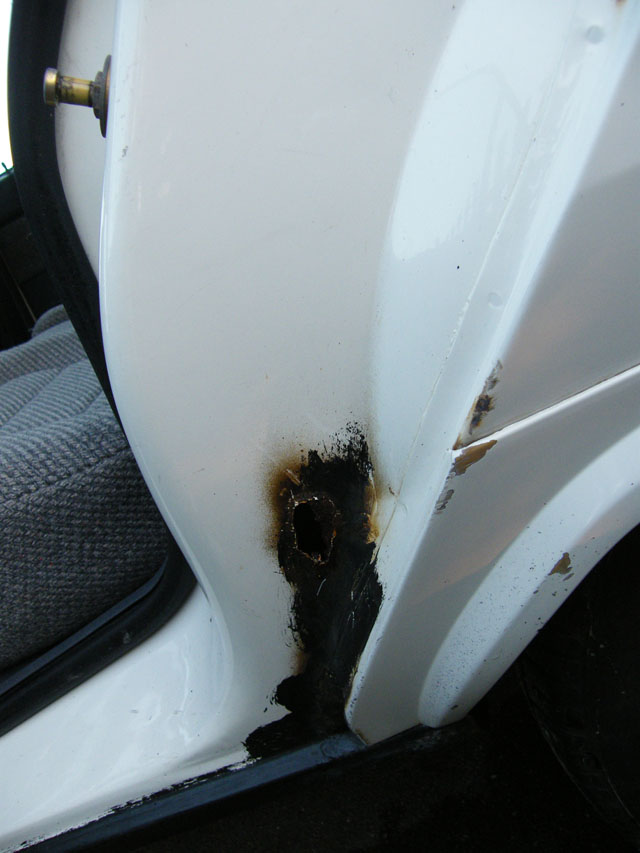

While cleaning the rear arch I found another hole that had been treated. It's quite small so should repair okay, just another little bit to add to the list of small holes that need plugging.

The rubber bands on the seat back covering attach to hooks on the underneath of the seat base, near the front. Looking forwards to more updates!

The panel missing from the dash next to the coin tray is just a blank, on the top spec cars theres door opening display etc which you could fit but not wire up. Howevere I expect theres plenty of blanking plates knocking about.
