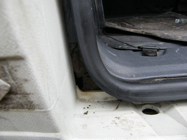

This gave me chance to use the camera as a second pair of eyes to have a proper look underneath. The flat metal sheet that joins the wings and bumper to the structural elements mostly has the consistency of wet cornflakes, what's left of it, but it does at least look easy to replace. All the structural bits look scruffy but solid and certainly don't seem that willing to bend or drop off when handled. Have some pictures of some rust.
And now you see why I daren't take the back bumper off to investigate further; I doubt it would go back on. You can just make out two little holes where the seal, light cluster and bumper meet in each corner.
