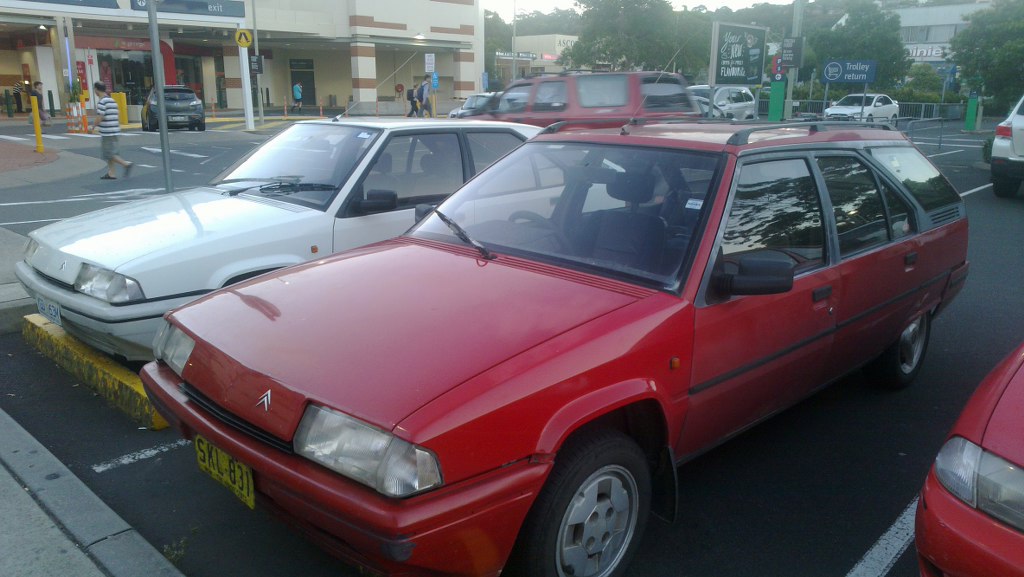

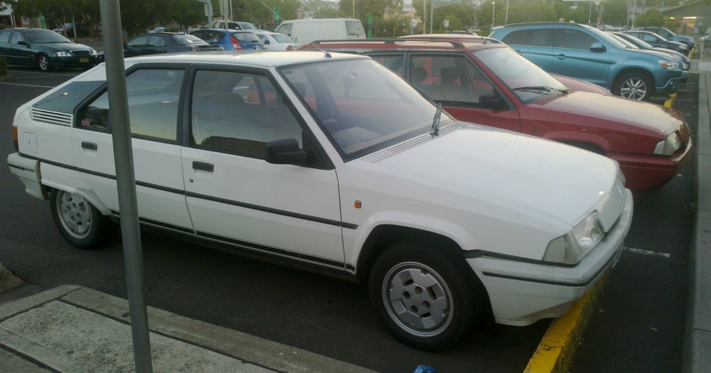

This white BX 19TRI is coming together quite well. Lots of elbow grease has it looking much better but the cooing fan is still running... I got a replacement switch, but the wrong one was supplied!
The thermostat certainly improved things however a head gasket replacement is a definite now so collecting the parts necessary. Any traps to look out for?
The car is driving quite well. I took it to the shopping centre today and remarkably found a handy parking spot in good company!
