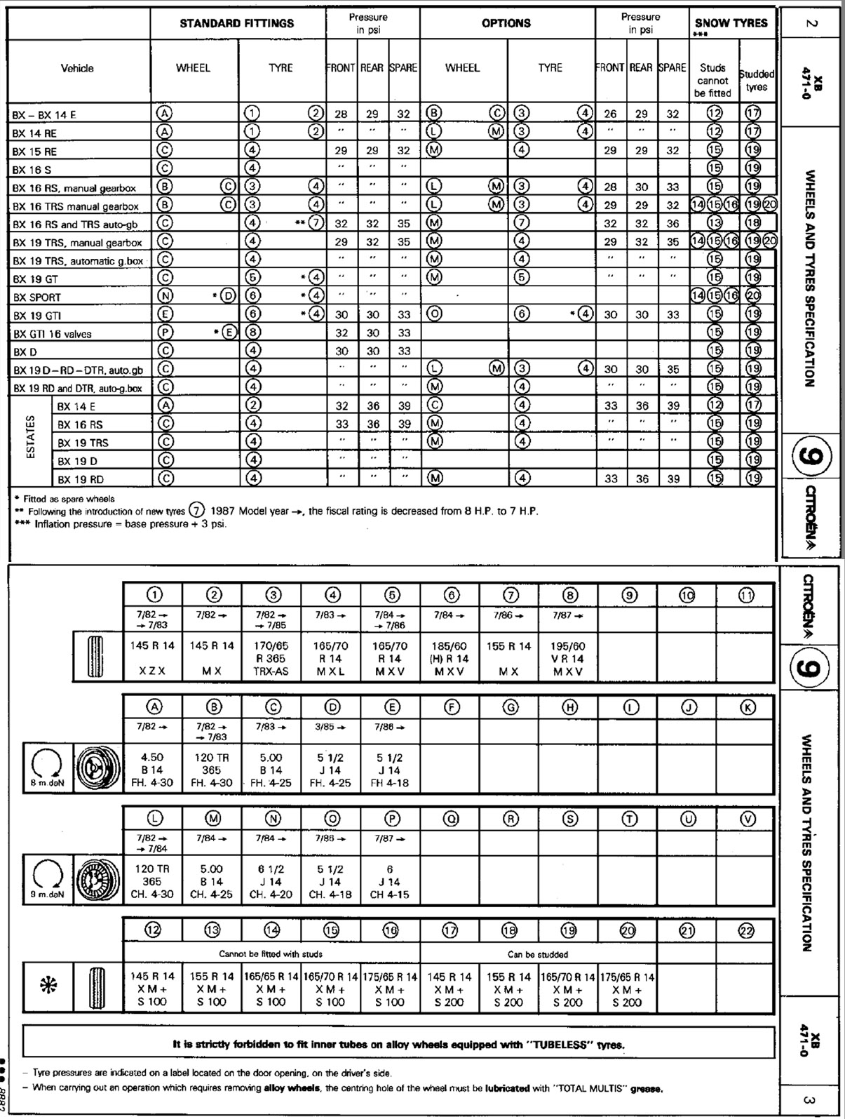

this might help:
this might help:
Re: BX wheels and tyres
But surely if you are using the alloys off a GTi (5.5J) or the 16V (6J) then you need to use the appropriate tyres as specced for them irrespective of the fact it's a diesel?
From the chart above the Alloy Option for a diesel is M which is a 5J. The designated alloys for GTi & 16V are O & P respectively. This surely must change the plan?
The late hatchback model "Pallas" (="Ourane") (Turbodiesel with aircond., Gti Spoiler front and back, front foglights, green-black velours) was delivered with 165/70 tyres and the silver 5.5J alloys of the GTi . Like mine e.g.!
