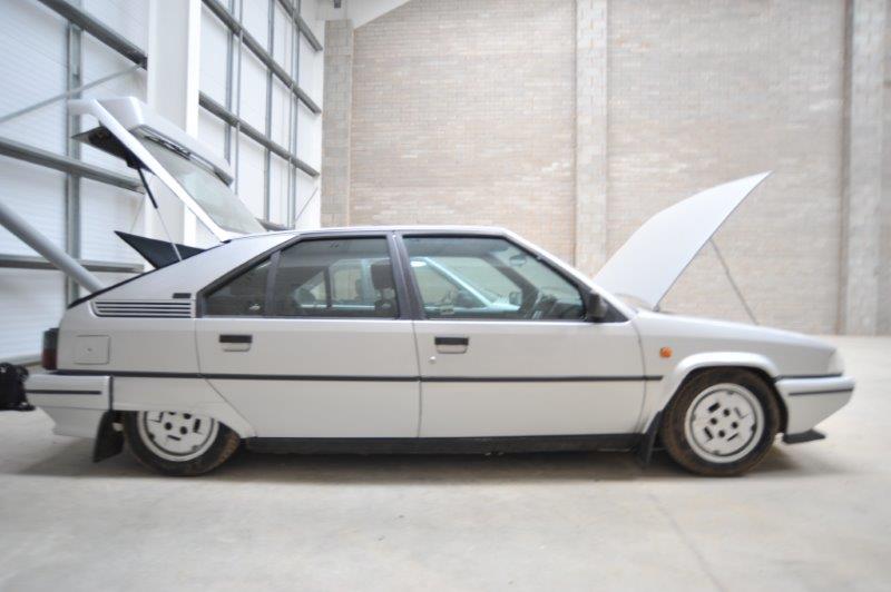

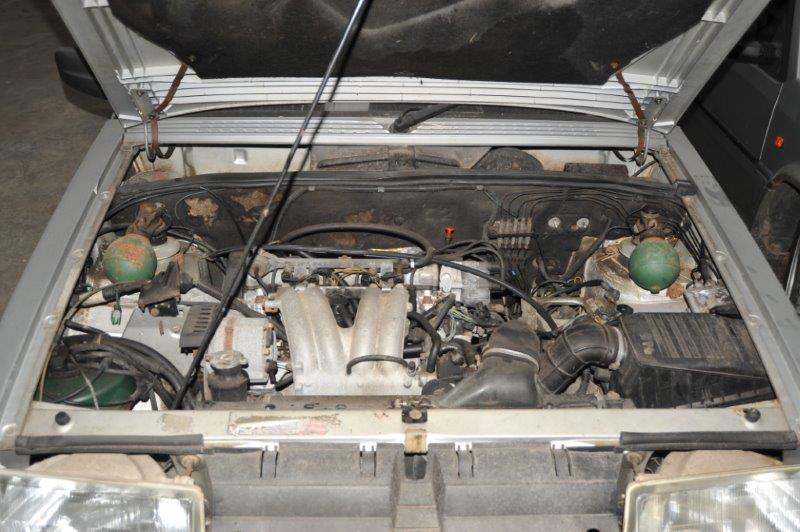

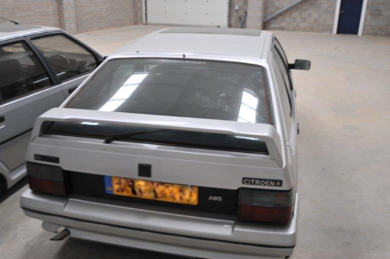

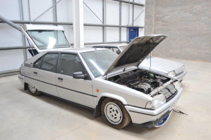

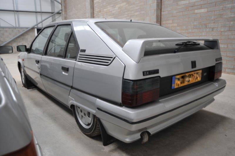

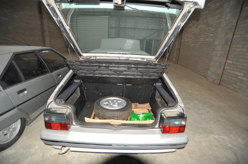

Here are some directly-embedded pictures of the 8v to finish with - Jack, I hope you don't mind me posting these. Someone save it...
We finally set off from Thornbury at 7PM about an hour behind schedule, having had to do a bit of trailer fixing. We were also thwarted on the way by a complete failure of Google to find the warehouse where we were going, but we eventually got there about 9.20PM. Jack met us on site and we walked into a very empty warehouse apart from two silver BXs.
In the end we didn't need any of the extra bits of kit for the 16v. I think maybe there is a loose connection somewhere but I put Jack's charged battery in place, wiggled the leads around a bit and the dash lit up. After about half a minute of cranking it came to life and rose, which was a big relief as I wasn't quite sure how we would have got it on the trailer in low. It would have been possible (the whole trailer bed tips, otherwise I think it would have been impossible) but difficult.
We then turned our attention to the 8v auto, which really is in lovely condition. If anybody is thinking about this one, I urge you to go and rescue it. The body work is super. It needs a downpipe, as it's a bit loud at the moment.
We couldn't get it to start on the key, so we opened up the airbox and sprayed in some Easystart. It would run briefly on squirts of this, so we then removed the fuel feed to the FPR, and discovered that it doesn't seem to be getting any fuel. So it might need a fuse, relay, cleaning out a blocked filter, or a pump. Sadly by this time it was getting late, so the warehouse was almost pitch black, and facing a long drive to Bristol didn't really allow any more 8v investigation time. If there's any way that someone can save it, or store it, or relocate it and ebay it so it stays on the road... please do. I would love to have moved it/taken it on myself, but time and space just doesn't permit right now.

they almost look like art, sitting in such a clean warehouse!
