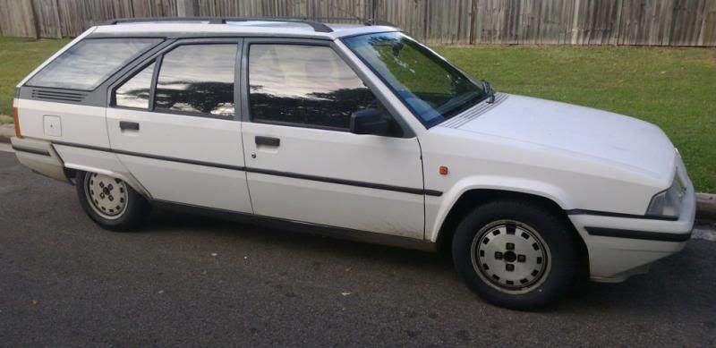

Lou dropped round to my place today and let me drive his newly revitalised BX. It does go well!
Looks good on the "new" alloys and tyres too:

Re: Lethargic BX
Rare alloys :)
Posts: 15578
x 148
Re: Lethargic BX
All those lovely rust free cars!
