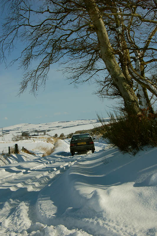

The BX is BRILLIANT in snow by the way. With the suspension raised it can negotiate quite deep snow and ruts that other cars just get stuck on. My snow tyres, Michelins are excellent too. I have only had to get the shovel from the boot once to dig the car out of some deep stuff on a bend.
I attach a couple of pics of the BX with raised to intermediate height suspension in the drive to my place showing the 4-5 foot depth on the field on the right of the car.

Posts: 2031
x 116
BTW, do you have to put weight in the car to help traction in the slippery stuff?
No I think part of the BX's success in snow is due to its light weight - it does not sink into the snow far enough to get stuck.

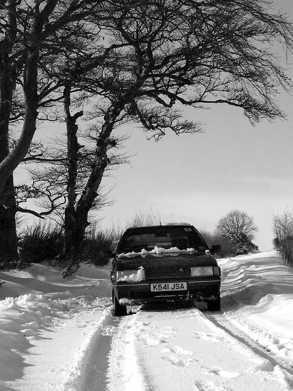

My bx got me up and down this road in the snow this week no trouble

Nice photos Mr Polaris,welcome to the BXClub.Like Philip says I think they'd make a nice christmas card :D
