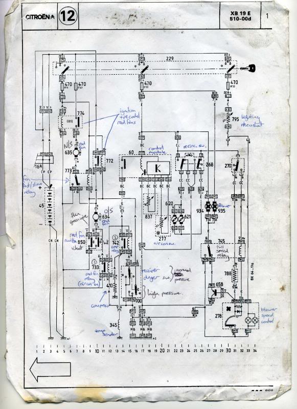

The problem here is that without a wiring diagram it is not possible to check each wire
There is one in the Haynes manual if you have one - I have posted the one for the AC equipped cars below. There are some extra components, and there are two blower motors but the principle is the same.
658 is the transistor in the blower housing. Ignore 270 and 288 - they won't be fitted to yours.

All my manuals are packed somewhere in a shed full of moving stuff. However I found a Petrol Manual in the 1.4 so used that to try and understand the wiring, much as you can with the diagnostic diagram you just included, thank you. Not studied it yet, as only just got in and off to Evesham later
