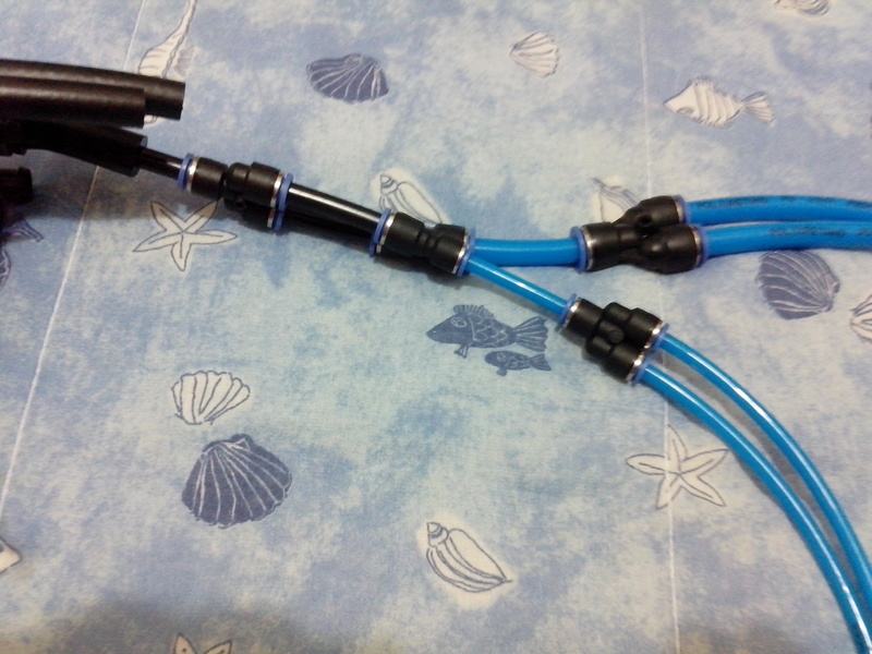

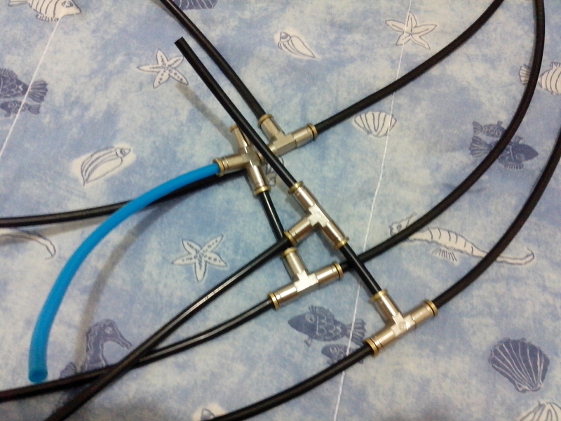

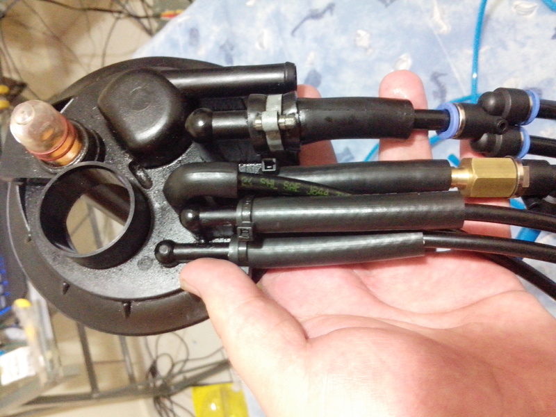

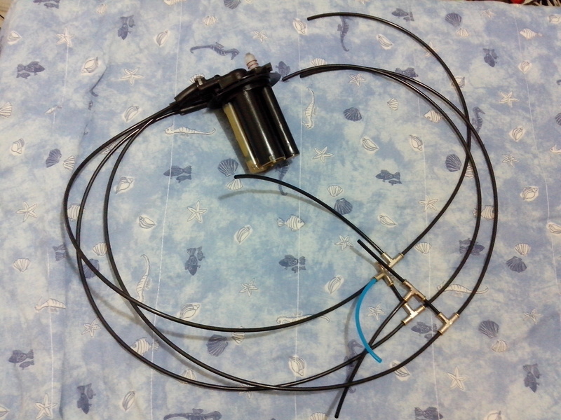

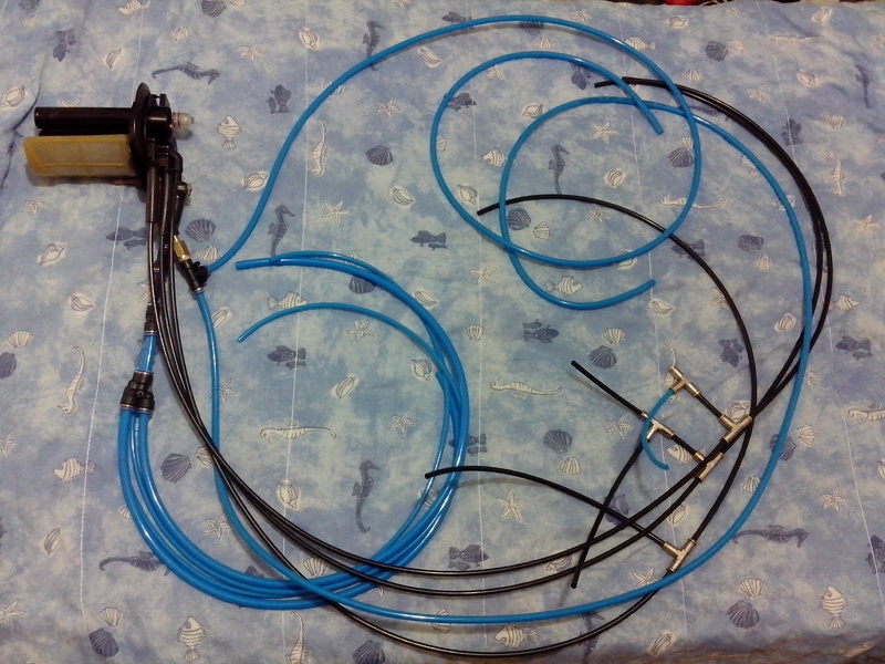

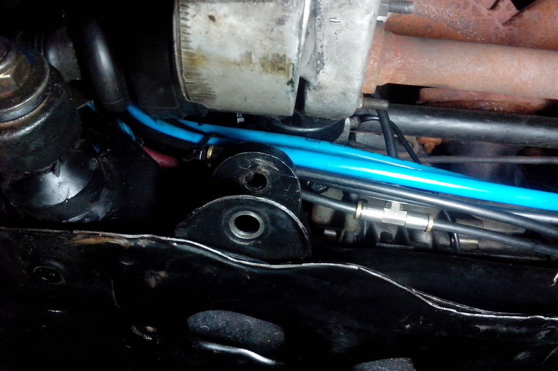

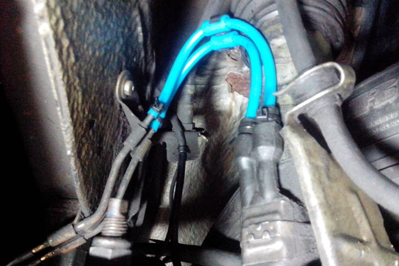

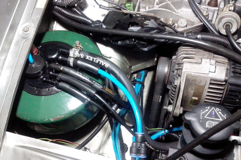

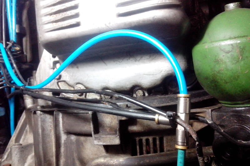

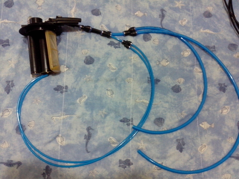

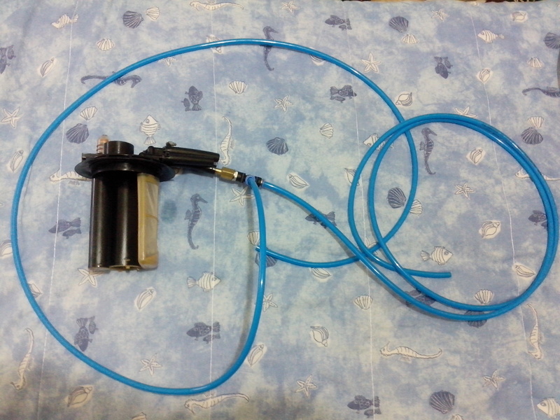

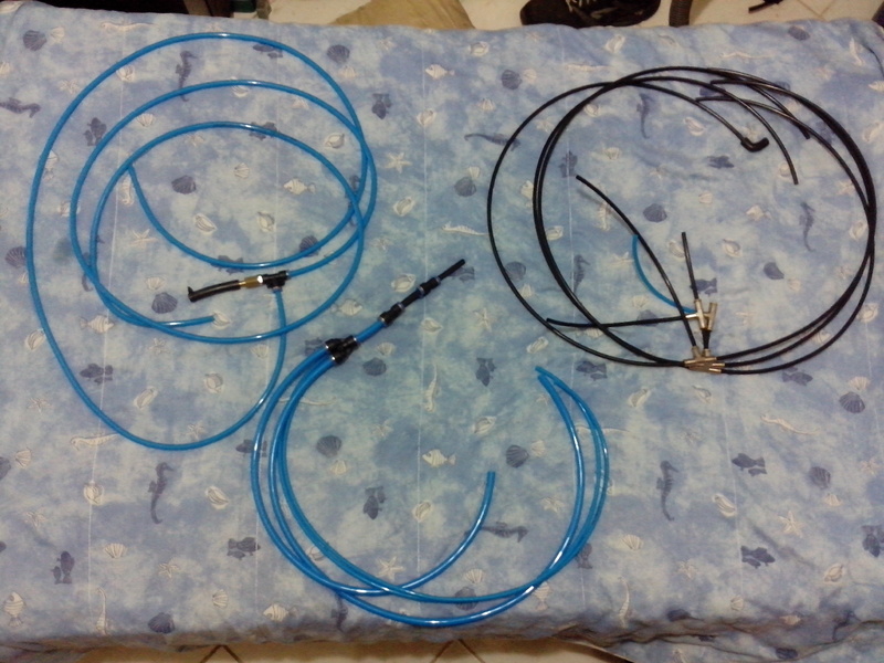

Finally! Done ALL return hoses!
Complete set

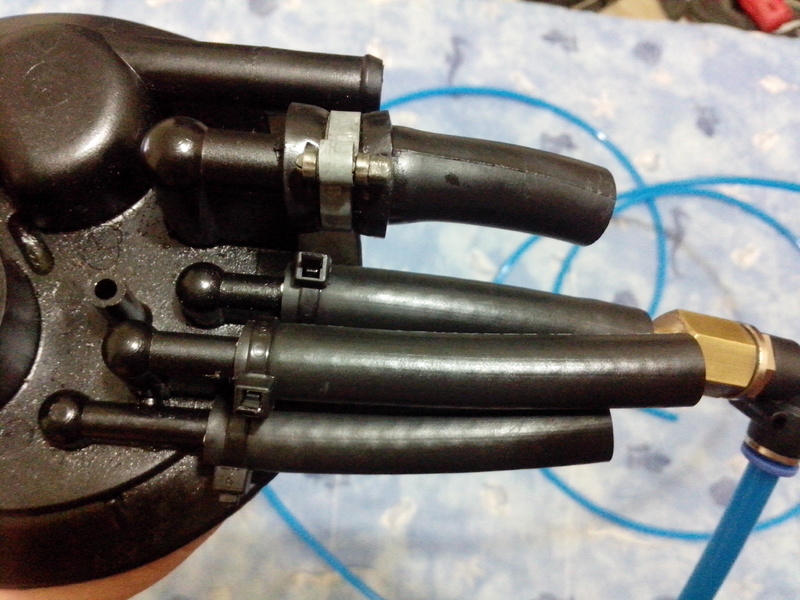

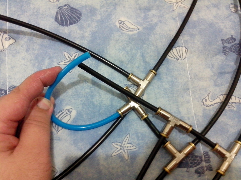

Hose manifold made with fuel hoses
Functional return group
Manifold detail. I couldn't find a 5 way distributor at the time, so i made this.
Brake group
Detail of the manifolds
Suspension and height corrector's group
Detail of the quick fittings. Can endure up to 80º C
More flexible hose for the front height corrector
The three groups of return hoses
That's it!

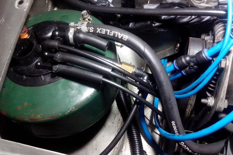

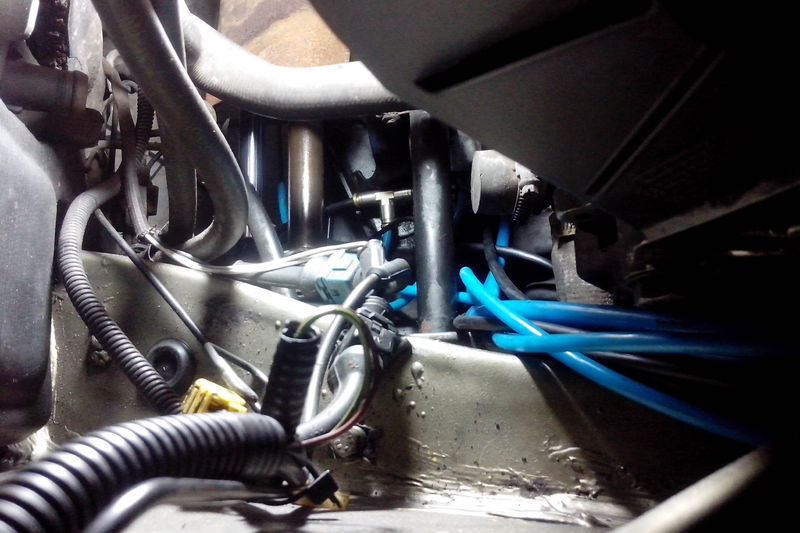

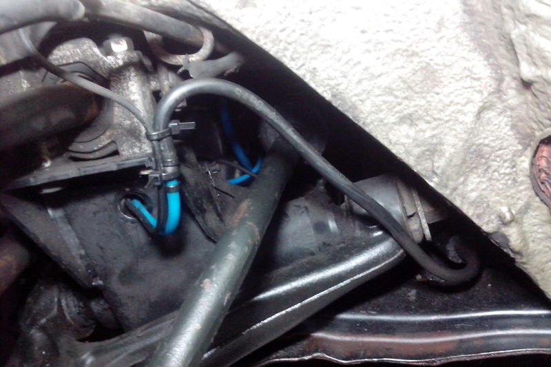

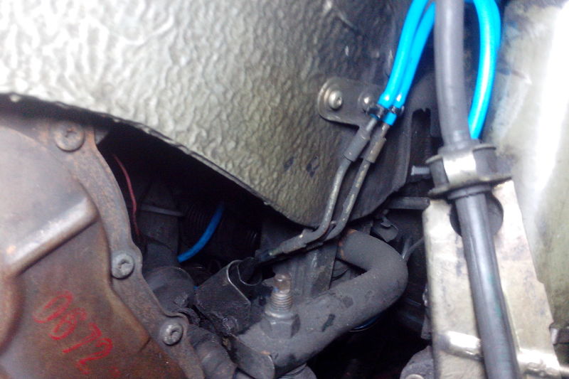

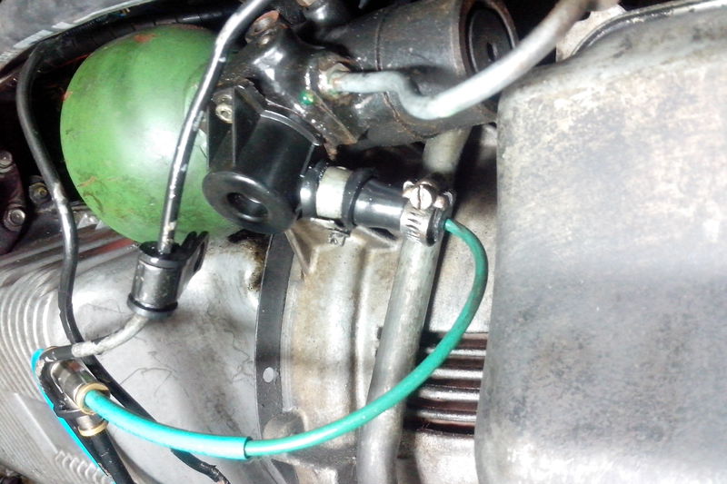

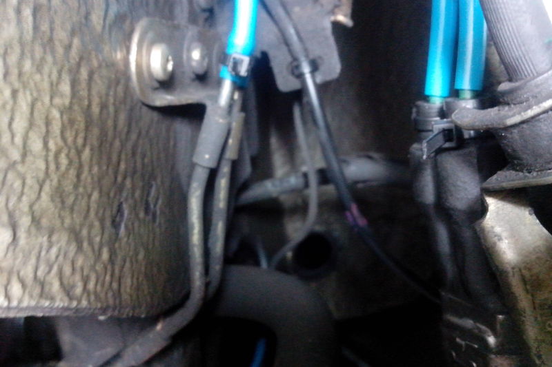

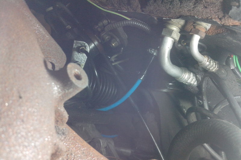

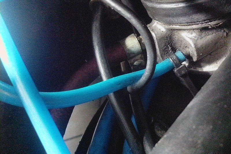

So, after x-mas, new year's party and all, finally started installing the hoses.
It's happening :o
Need a couple of adjustments and testing

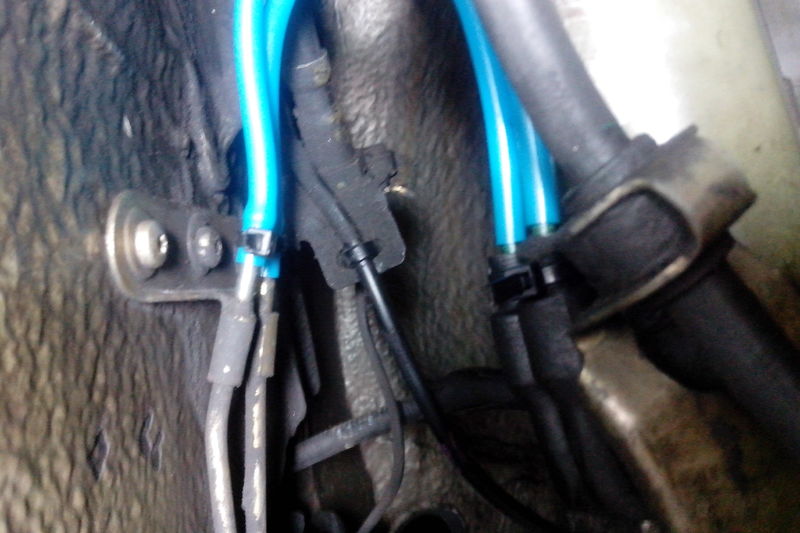

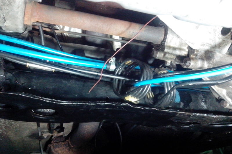

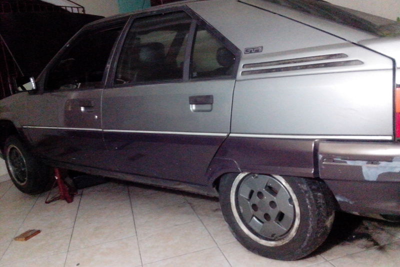

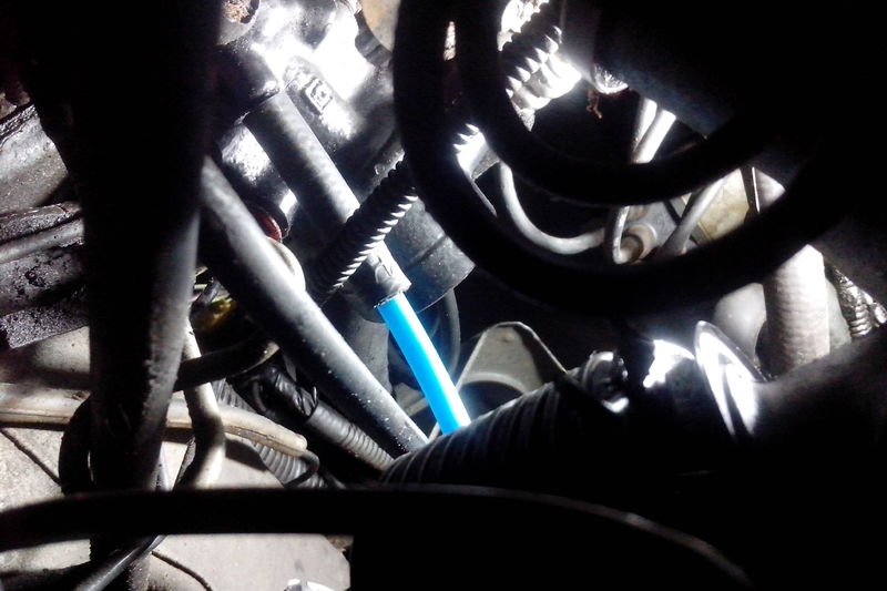

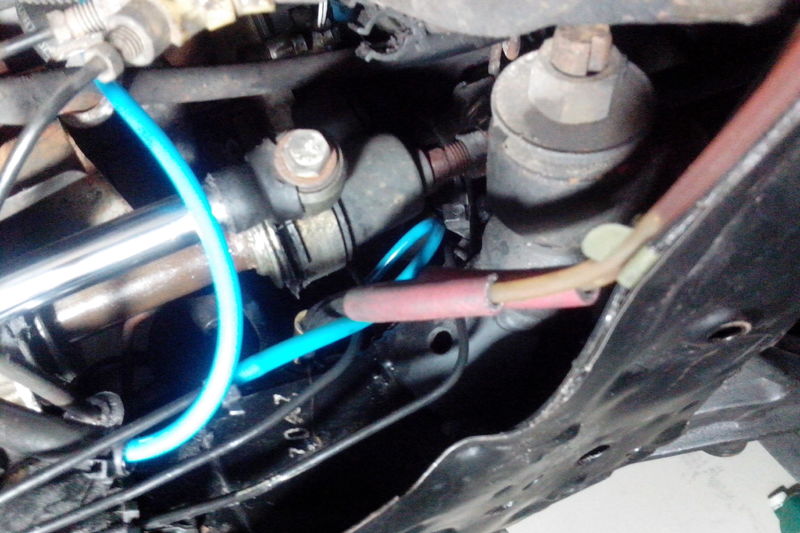

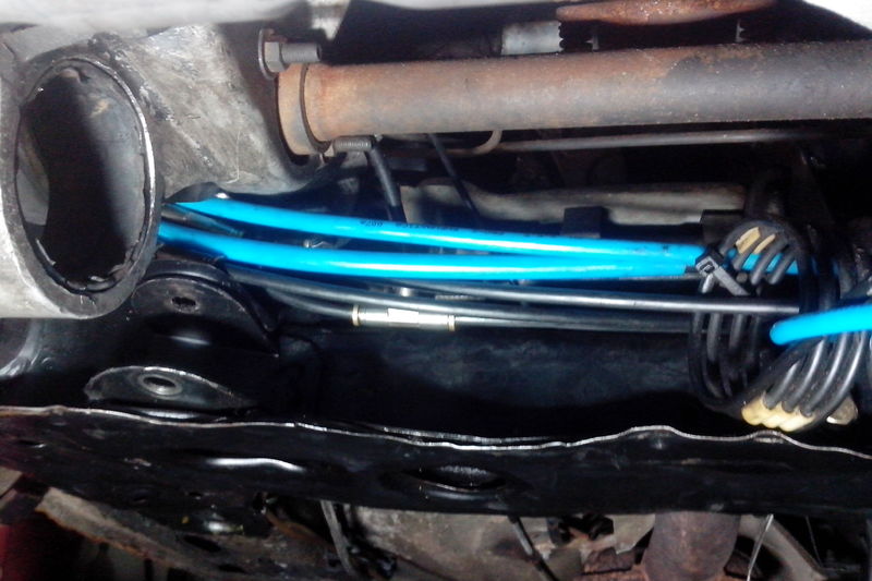

So, the results!
Missed seeing it up
Hoses manifold
No leaks at the suspension leak return and breather
Minor leak at that 11 nut
Everything dry from the rear returns!

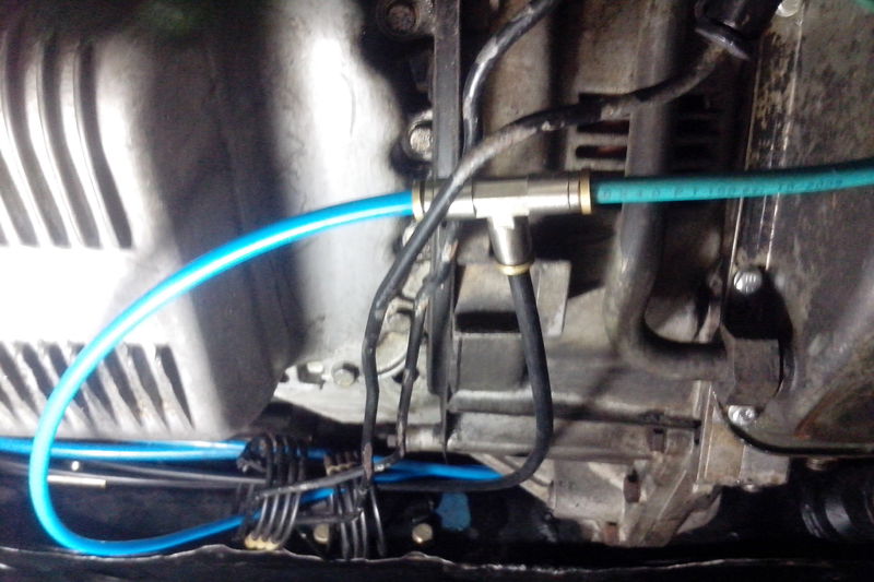

Detail of the area

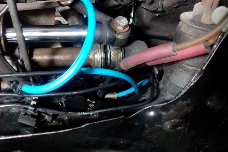

PS Return ok, no leaks.
Octopus area, dry.

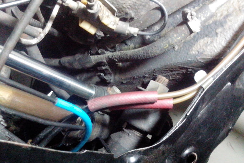

Brake hose ok

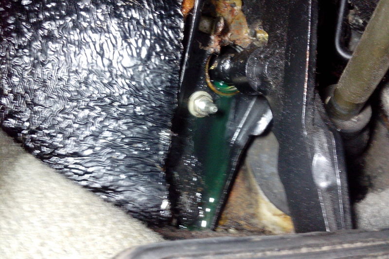

And there, my main problem: HUGE leak at the brake doseur when i press it, looks like a cascade.
Incredibly, only two leaks weren't from the hoses, so it passed the test!
