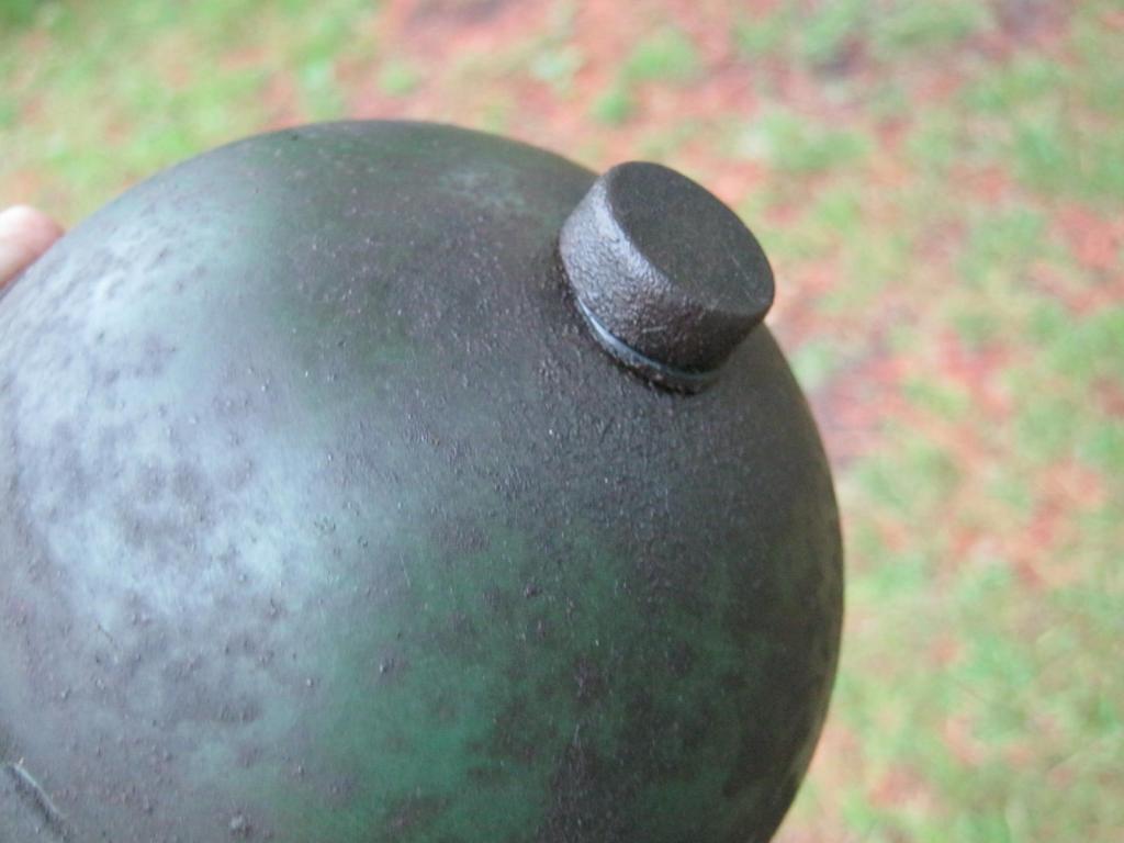

Post by stevieb » Tue May 27, 2014 11:25 pm
I've actually got off my arse and got something done about it.....there is no way I could muck about under the car or move it to my hard standing area at the rear of the house. After a bit of searching, I got the car collected and sent to an independent citroen specialist on a flat bed with a set of spheres in the boot BX55FB/BX40RB. They reported back today....all done.......The massive loss of pressure/leak was the back of the OSR sphere blowing open.......never seen or heard of this before....will post pics when I can. Four new spheres fitted and a new LHM....
