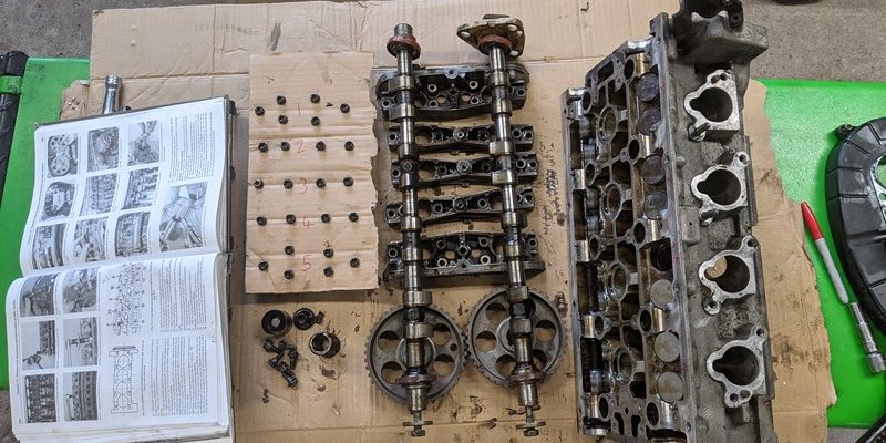

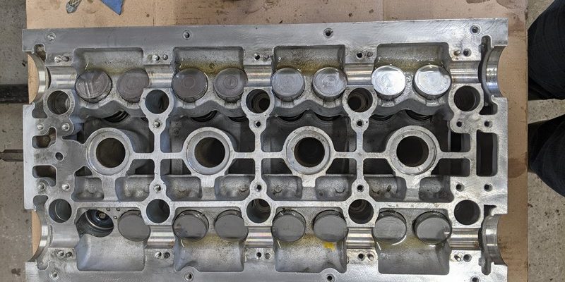

Re: BX Project
I'm surprised, given the cost, just how accurate at diagnosing the leakage it has been.
I've had the head at a machine shop and their findings have matched my leak testing. Both a good and bad result

Re: BX Project
CITROËN BX – CYLINDER HEAD OVERHAUL
Can I find the reason for the leaking pressure previously found? Can the leak be fixed with a cylinder head overhaul?
https://bxproject.co.uk/blog/citroen-bx ... -overhaul/
