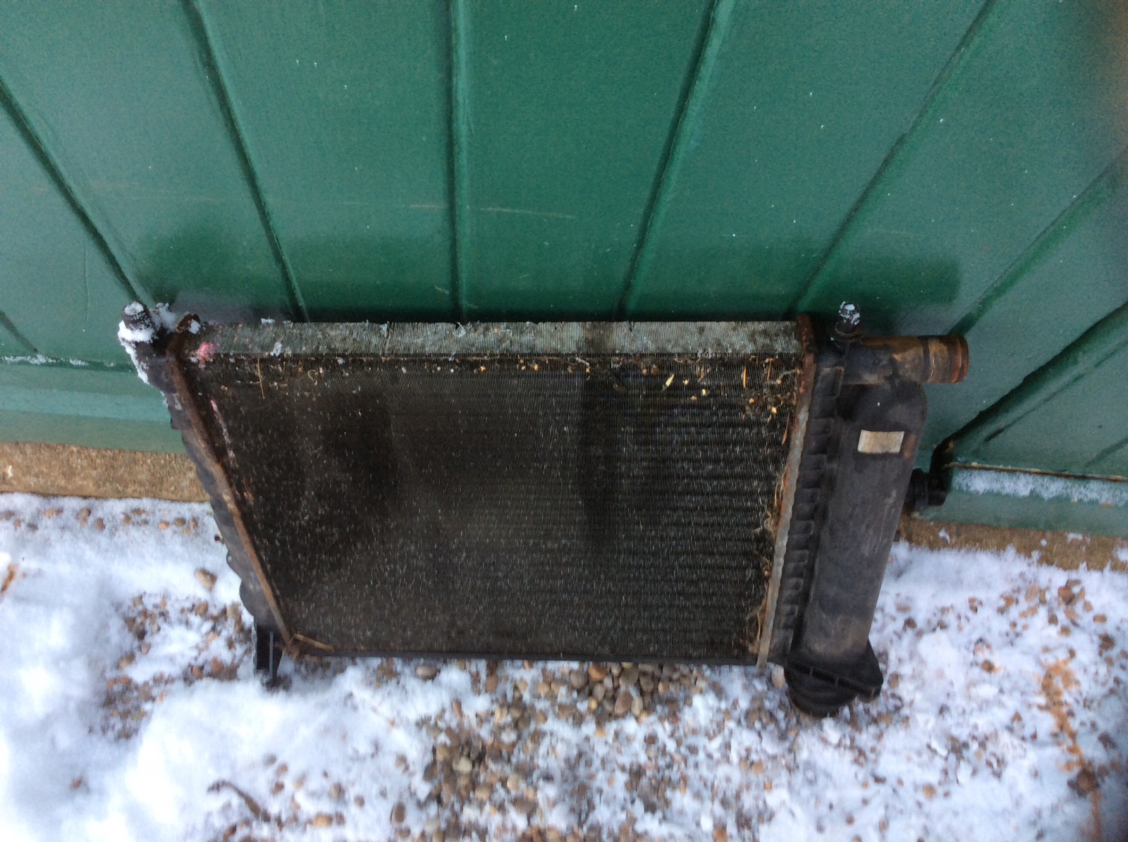

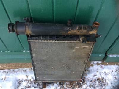

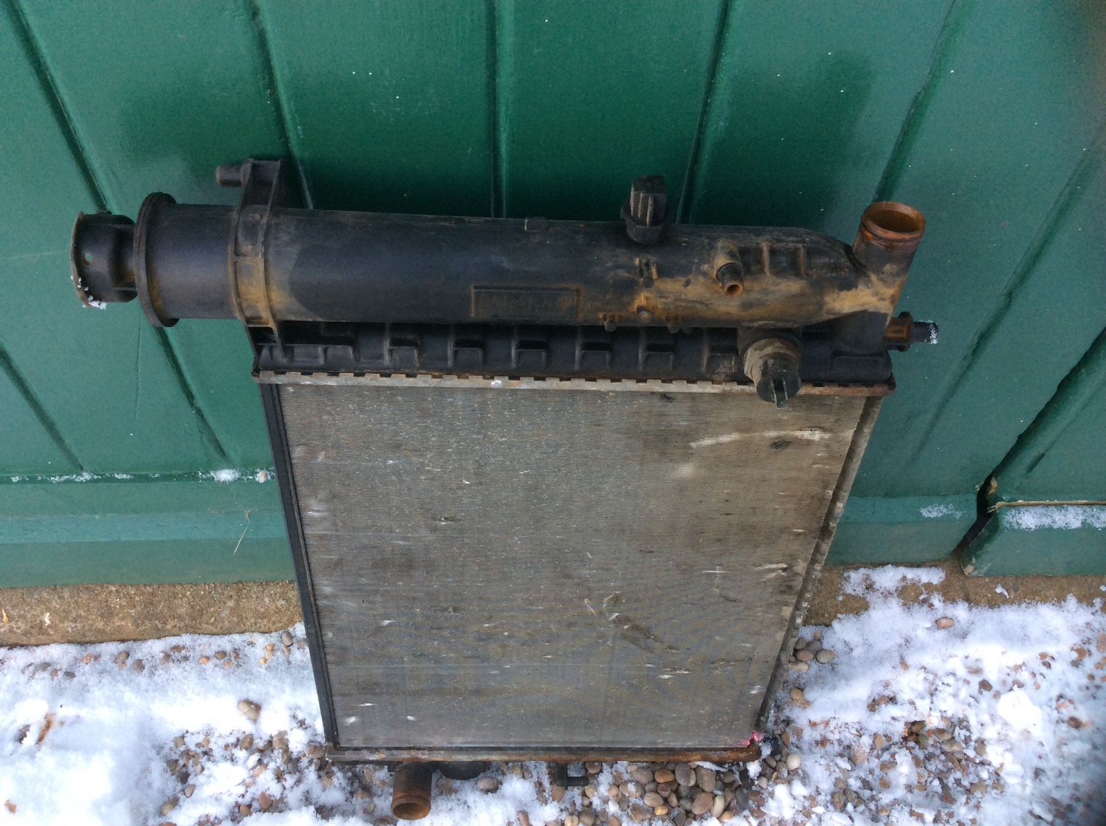

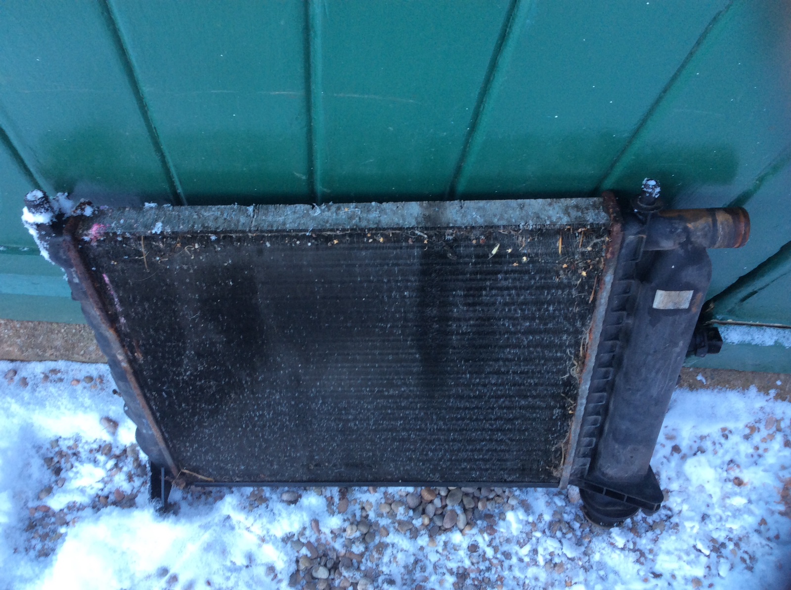

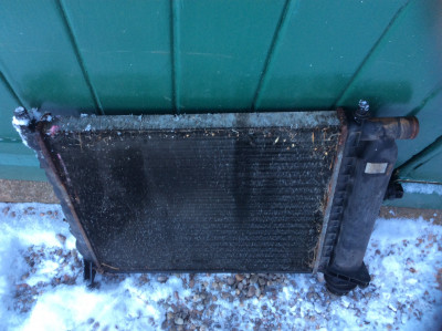

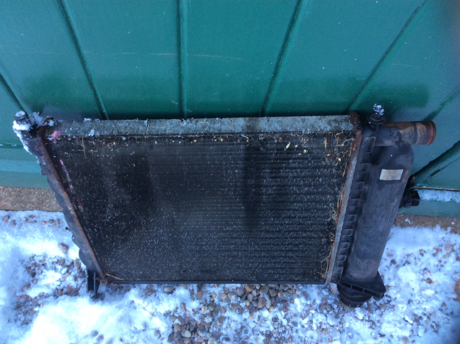

If you need more help, can you post a photo of your existing rad (particularly to show the top of it and filler) and check dimensions of it?
BX 1.6 TGS Athena rad.

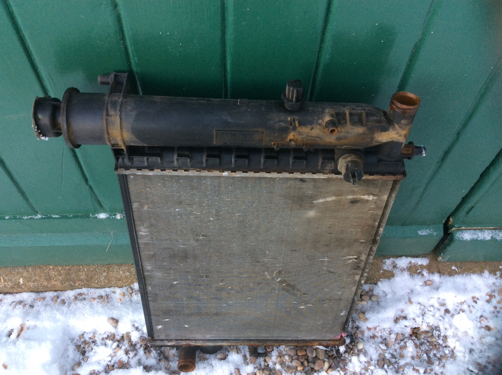

The one I have is 440x600x32 with mounts at 650 centres, it's a bit battle scarred but no leaks when it was removed
Has side header tank
Could prob be adapted to fit if Yr stuck
From a 90 gti8v
From a 90 gti8v

No evidence of A/C ever having been fitted I’m afraid.

Looks like the same rad as fitted to 19D.
Either of those Mister Auto items would do. You could ring them and check stock/delivery situation. They might be able to pull stock around between warehouses.

It will be the same rad with or without A/C. There is plenty of choice available to you.

Thanks, have found correct radiator at Mr Auto but the website is down and they are unable to take telephone orders meantime due to restrictions. It’s NRF part no. 58678.

Many thanks all, I’ve located the correct one(I think) in Denmark so it will take a week or two but should fit perfectly when it arrives. 'KMS parts online say it’s not the listed one for my BX but it matches the measurements on mine so fingers crossed.
