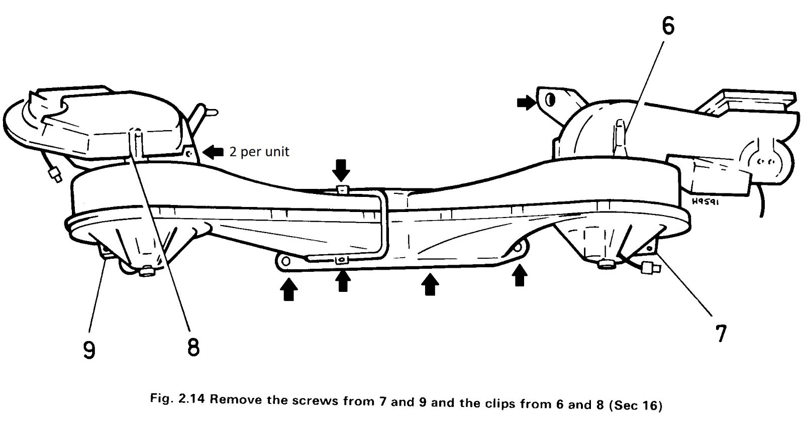

Haynes diagram, with additional fixing points arrowed
Removal of the blowers
As per earlier posts, followed the advice there, but found a bit more dismantling was needed to get the blowers out:
- remove windscreen wiper arm
- remove air intake grille/panel (two plastic fasteners and the large plastic nut around the wiper stalk)
- lift out the central rain shield (the rubber seal secures its forward end)
RH "upper" (on the left as you stand in front of the car) fan needs to come out first. Unscrewed and unplugged the unit, but really struggled to lift it out without needing to lever the fresh/recirc unit backwards, to allow it out. The LH "lower" blower proved impossible to lift out like this, so found that it made sense to
- remove both screen washer reservoirs
- slacken the 10mm nuts holding the fresh/recirc units, to allow wiggle room, or better (for the LH one) removal. This LH one is designed to be more easily lifted out (it has a slotted mounting hole).
- the RH blower unit should be removed first, as it sits on top of the LH one's flange
- unbolt the bulkhead relay bracket, and move it to one side (no need to disconnect)
- remove the LH blower unit as well.

Re: Twin blower removal and inspection (AC)
Post by Vanny »
I actually made a video on just this topic!
Well the wiper motor change, but the first step is getting the additional blower motor out.
The haynes manual image looks wrong compared to my Mk 2, wonder if its the Mk1 system.

Agree about the Haynes drawing, where the recirc/fresh air diverters do not look like the mk.2 items, although the blowers themselves do correspond.
