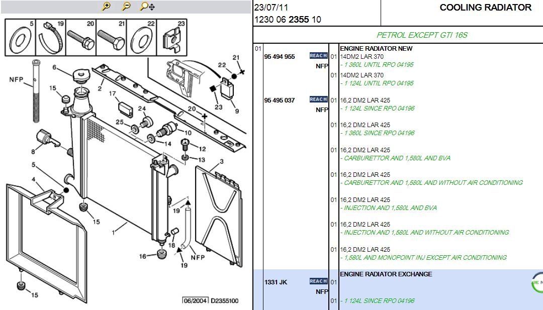

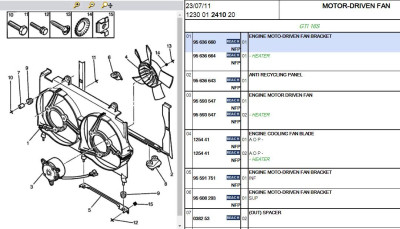

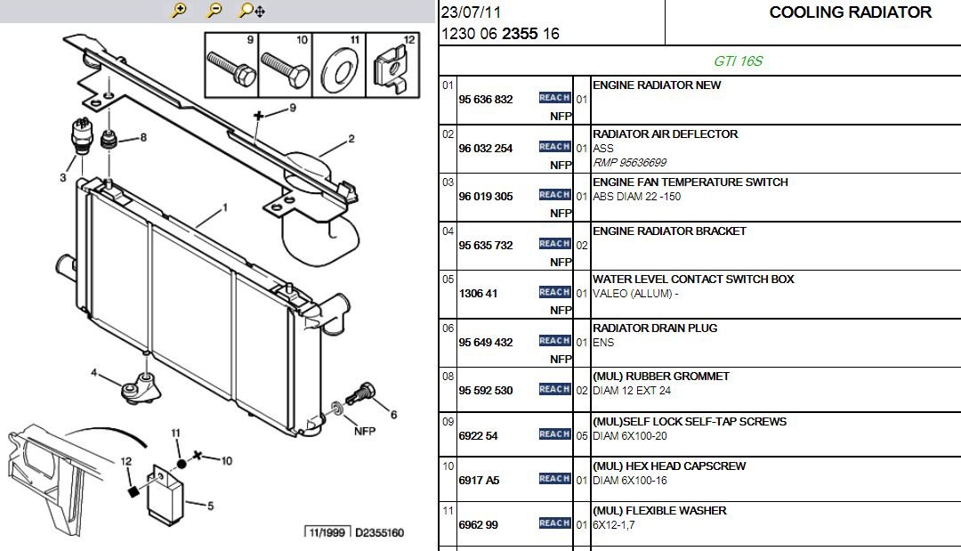

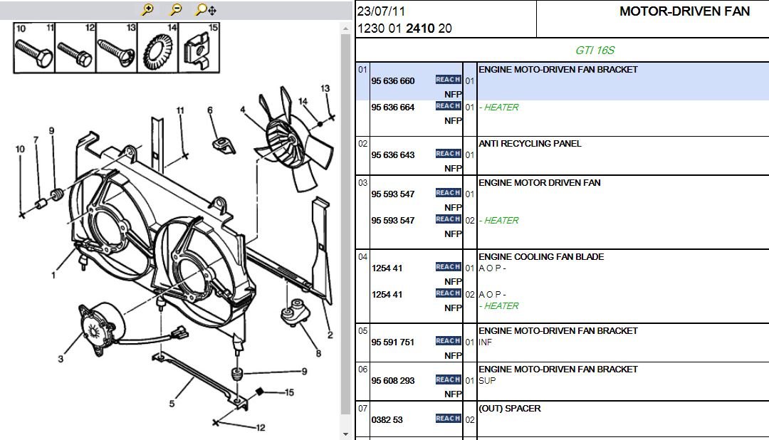

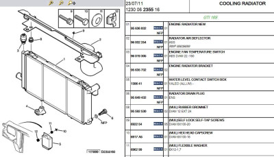

Went back to Parts, and 16v models are shown as having wide radiators and twin fans:Dave_16v wrote: Sat Oct 30, 2021 11:55 am With regard to two fans being fitted, the 16v's with air conditioning have two. Not sure about others, never delved into it.

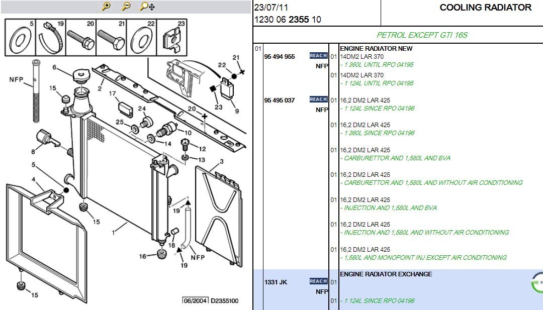

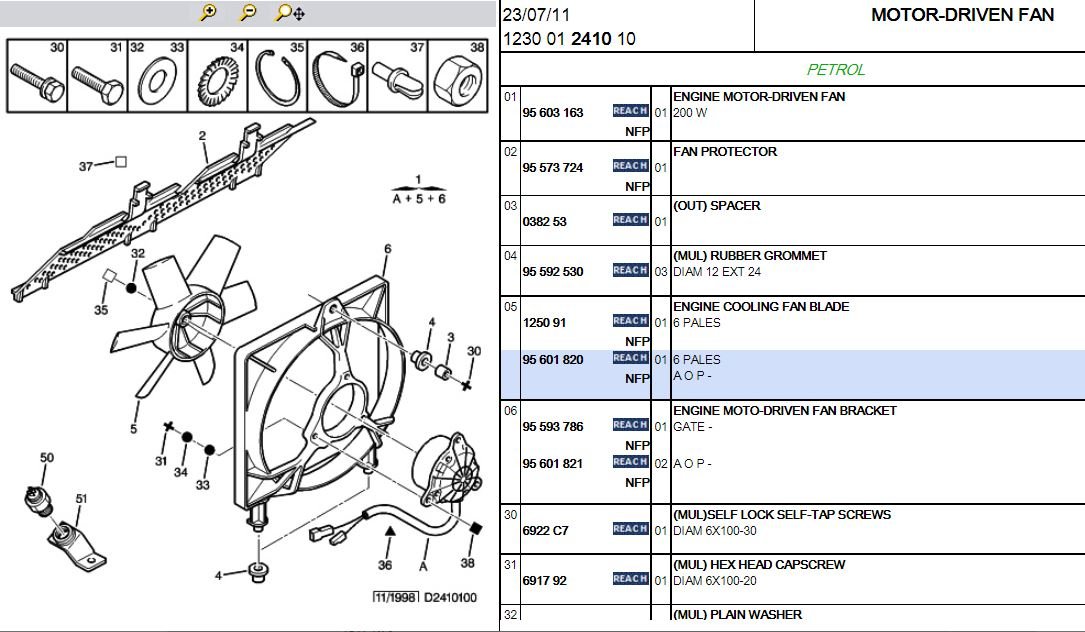

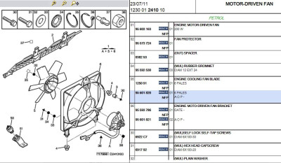

Other petrols (so that would include GTi 8v) shown with narrower radiator and a single fan:
. . So, to find a GTi 16v with only a single fan is odd, and doesn't seem to make much cooling sense.
There is no mention in Parts of anything different for early models, or RP changes.

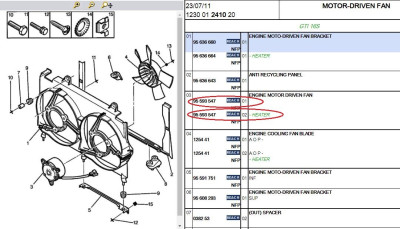

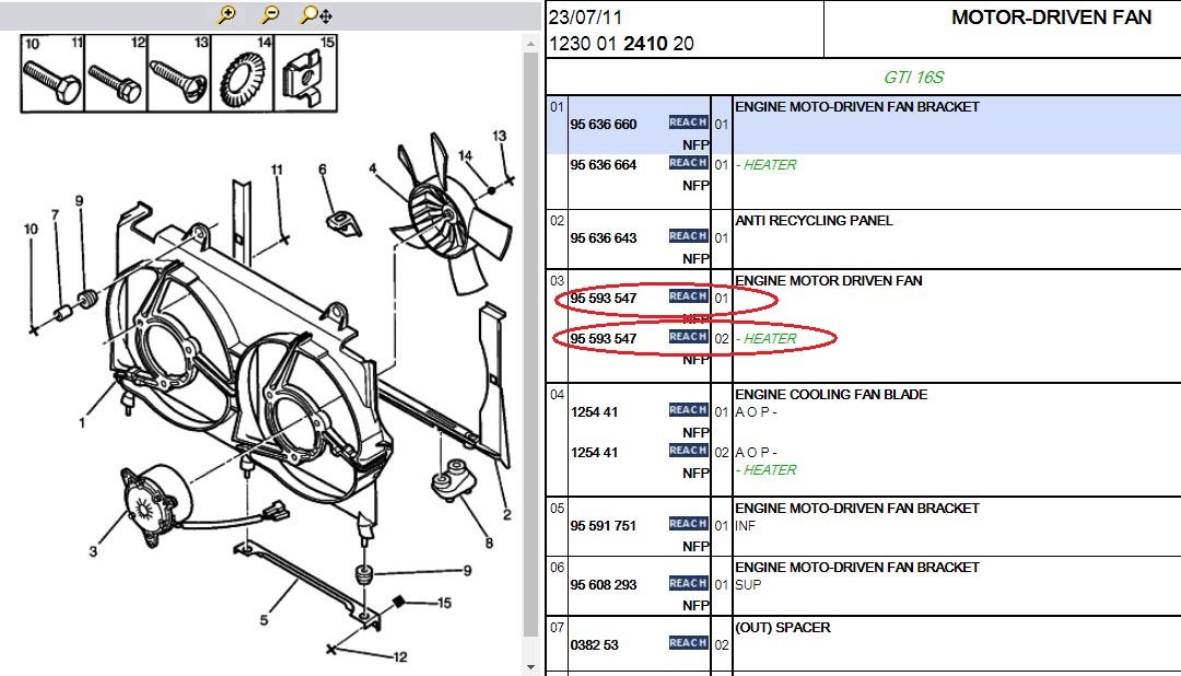

Just noticed that the same part number (for the fan motor) is shows as qty.01 or qty.02 in the parts listing.
Flipping the Parts page into French shows "Heater" as "Climatiseur", so that would be the AC option.
