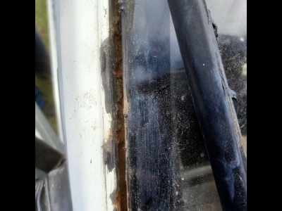

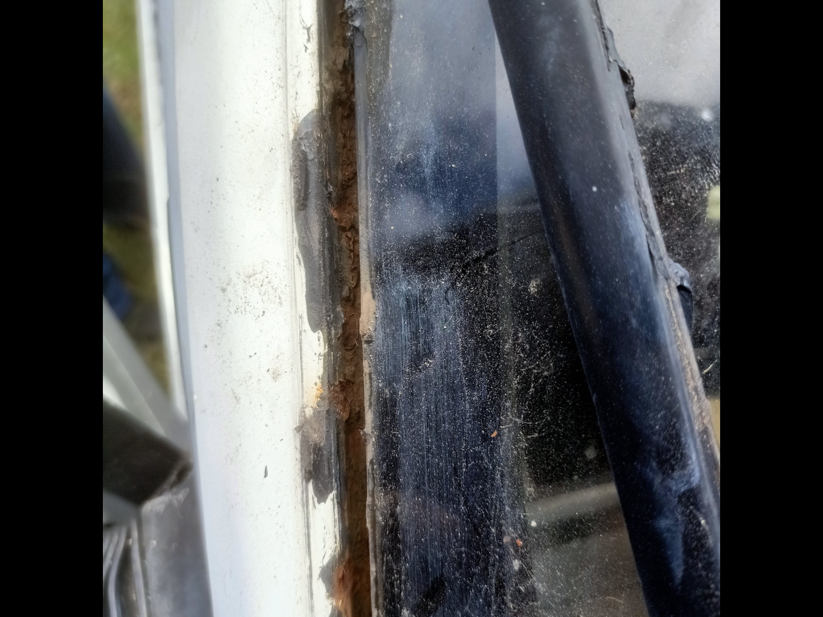

Today I had a better look at the 16v in question. It’s a project, that’s for sure!
One of the areas of concern is that I can see some signs of rust forming around the window frame A-pillars when I peel the rubber seal away. The seals across the roof and base of the windscreen were glued down so I couldn’t see under those, however there is no obvious signs of bubbles emerging in those areas. The dashboard is out, and so I can confirm that the frame on the inside up the pillars and across the firewall all look very sound.
My question is: is it more common for rust in the pillars to emerge from the inside of the hollow pillar and by the time it is visible under the rubber seal we are only seeing the tip of the iceberg, or do they tend to rust on the outside / under the seal first, and therefore could possibly be cleaned up and repainted? The windscreen is cracked, so it would need to come out anyway.
Photo shows visible rust up driver A pillar.
It has had both front door hinges repaired, and there is minor rust under both washer bottles which would need to be sorted.

Re: Looking at buying a 16V
Yeah that's fairly common rust around the windscreen, you'll prob find more once the rubber is out, it's a tricky repair as you will have to fabricate some new sections or cut some good ones from a doner, usually goes hand in hand with rusty a-pillars and bulkhead which again is a tricky repair as it's triple skinned along the lower bulkhead seam and will need to be repaired in sections.
At least the dash is out which makes things a lot easier there.
The a-pillars tend to rust from the inside out, this can also be caused from rusty inner wings esp under the splash guards that you can't see, have a good poke all along the inner/outer sills and the underside of the sill at the rear, and if it has a sunroof check the frame as they rust quite nicely too.
Hopefully your not opening a whole can of worms. I'd guess rust was a major contribution the the demise of many a bx in the uk Inc my own which was very rusty when I saved it from certain death 15yr ago.
There's two things you need with a bx. A lot of patience and a welder.
And the strips on the roof don't come off easily as they're bonded on I managed to cut the first couple of inches off with a dremel and bonded it back on after repair.
