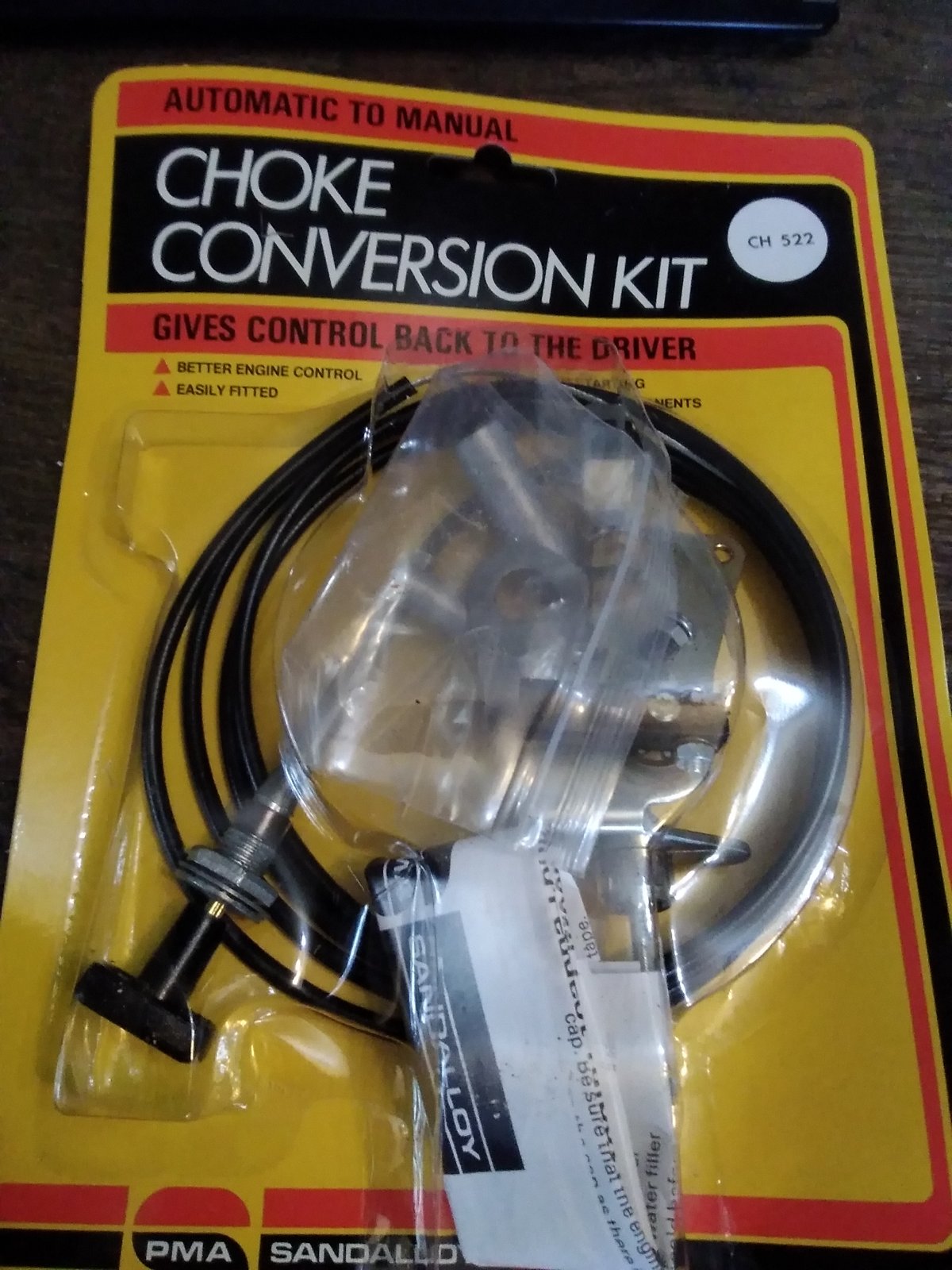

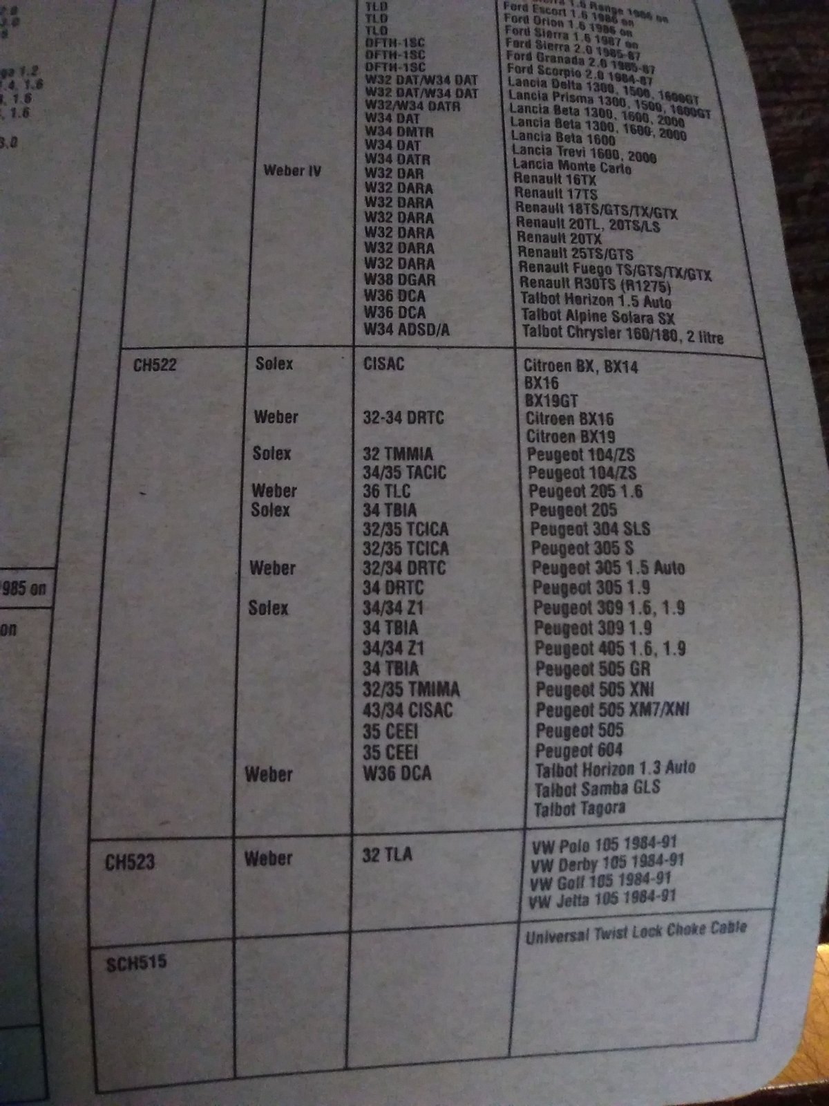

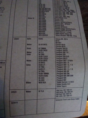

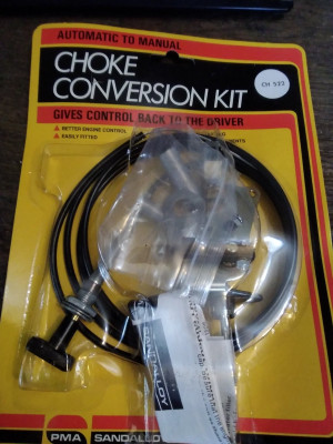

sleepy0905 wrote: Sat Oct 07, 2006 8:25 pm Hi does anyone know if there is a manual choke conversion for a bx 1.9 either solex or weber.
The reasons being my auto choke takes far too long to come fully off and i would prefer to have a manual choke.
Yes, i have one Sandalloy CH522. £95
