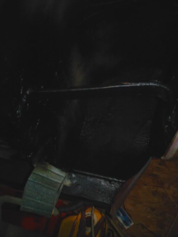

All repairs now primed and sealed, and I'll be spraying the inside of the wheel arch with underbody wax tomorrow.

Wheel arch now coated in underbody wax.
Wheel is now back on, and interior trim refitted. On to the next area for attention!

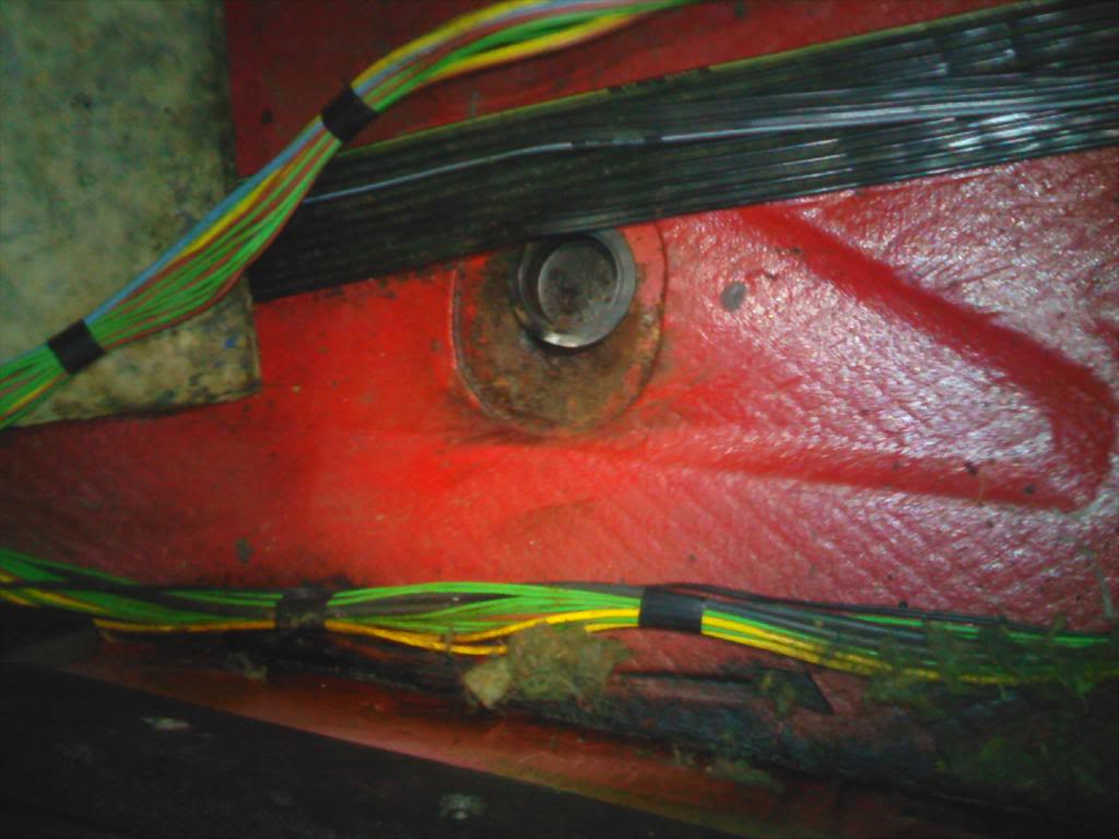

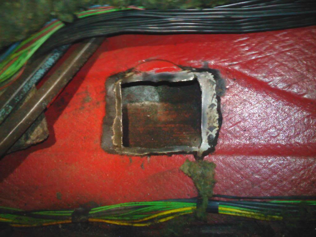

Had an enjoyable day out in (relative) civilisation. Getting a lift in Vanny's 16v was fun, and was the first time I've been driven in the back of a BX for about 20 years! Once I was back home I felt spurred on to actually do something on mine, so decided to take a look at the passenger footwell.

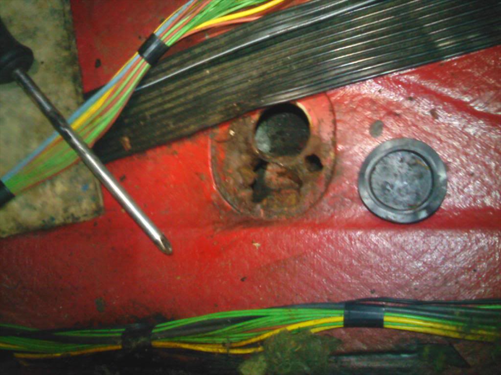

When I'd dried the carpet after the roof leak I noticed the area around the bung was rusty, and although not holed was fairly flaky.
Sure enough, once prodded it soon became holed.
I assume the only purpose of the bung is to drain out coatings when the shell is dipped during manufacture, so figured it would be no problem to cut out and just replace with a simple plate.

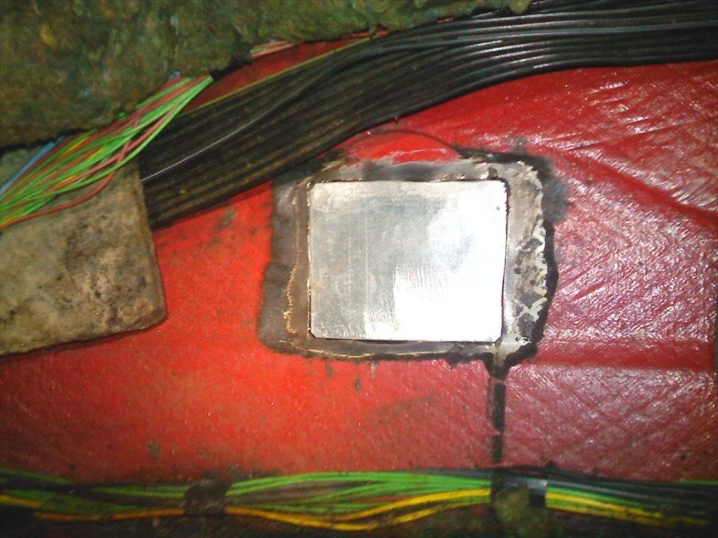

So a suitable piece was cut from my rapidly dwindling stock of galvanised sheet...

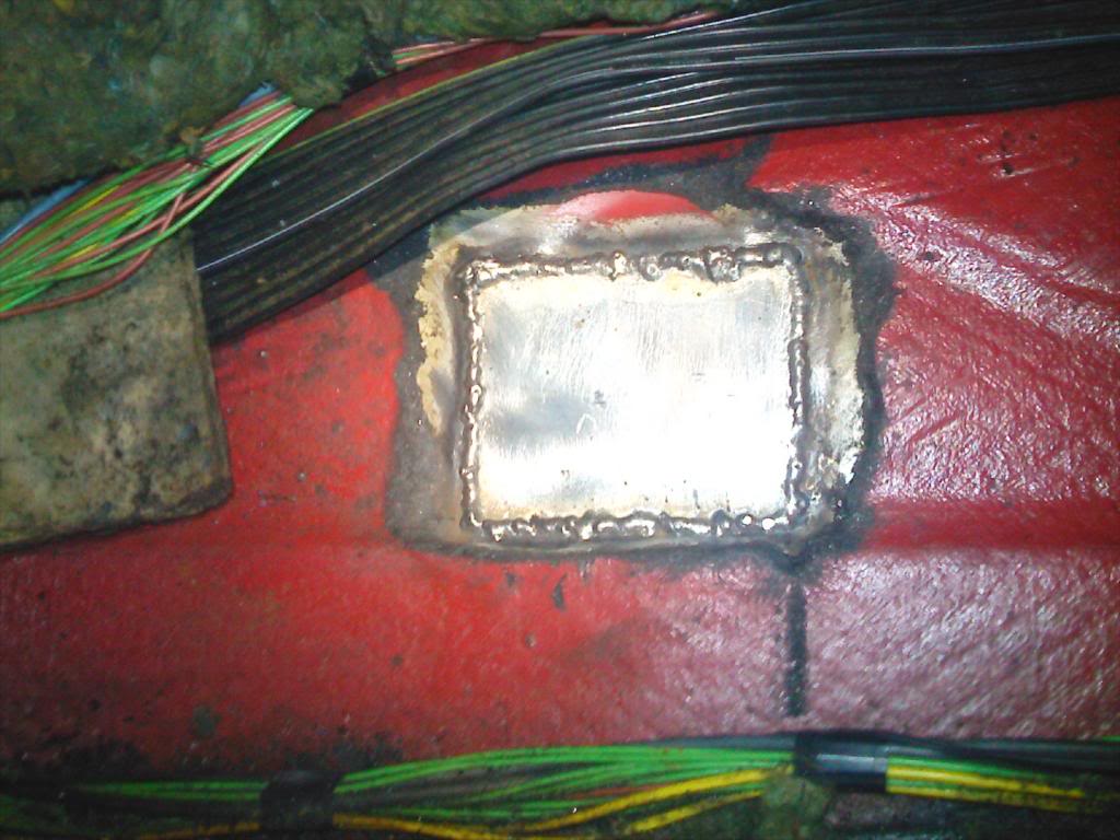

...and welded into place.

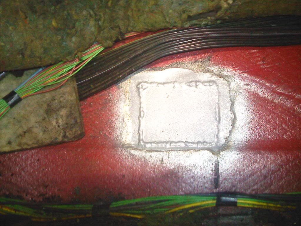

Followed by a coat of paint, and it's time to call it a day for tonight.
