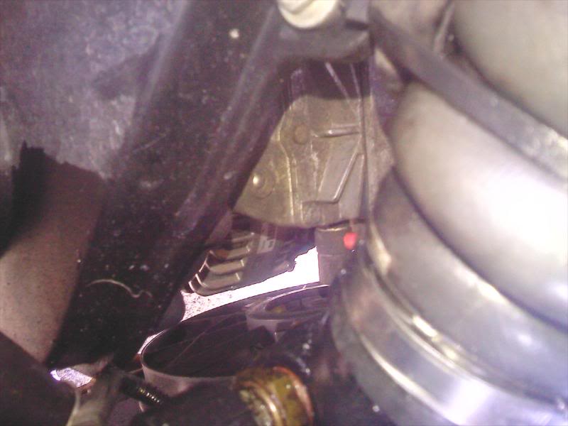

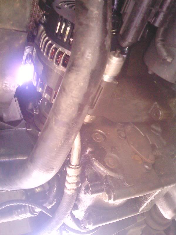

D'oh! NOW I read this...£90 odd later. Lucas LRB00359 on the side, but please don't say what you could have got one for! TBH, I needed it to be mobile straight away - the only other fully working vehicles are the Disco (needs MOT) and the van (prepped for paint) so I had to bite the bullet and buy it. If I had a spare car on the road I'd have had a go at repairing the old alternator, but I just needed a quick fix. A couple of weeks later and both the van and the red BX would probably have been finished, but that's life.Vanny wrote:On the alternator front, see if you can get a part number off it, I'll see if we can find something to replace it with.
Access wasn't ideal from the top...
...but slightly easier from underneath.
Only took half and hour to get it out, and same again to put it in - took longer to get to the motor factors! Now charging at ~14.5 volts.

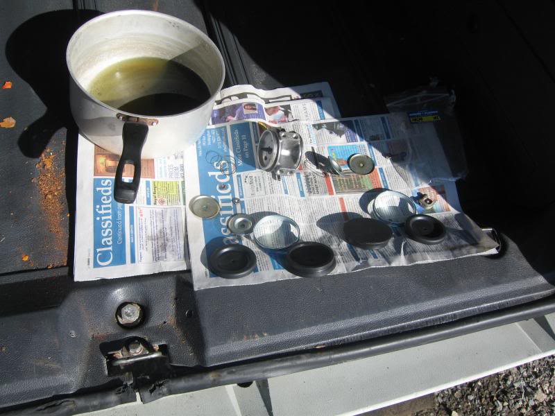

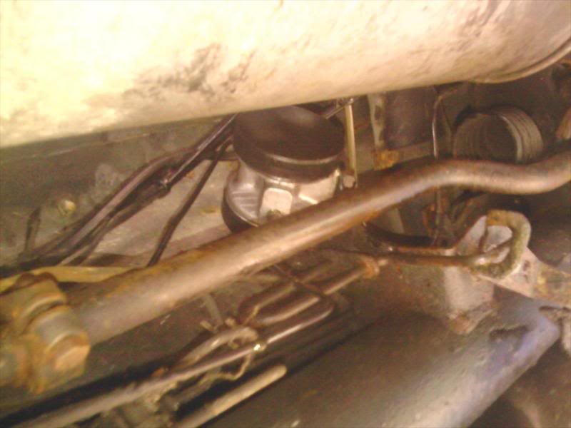

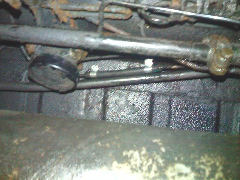

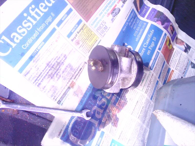

Most of the rest of the day has been spent chopping firewood, so am aching slightly now. But I did get chance to sort out the height corrector on the white one. Here it is stripped down a bit:
I did take the slide valve out and clean the internal passageways (in the saucepan full of murky looking petrol). Then back together with new diaphragms...
...and back on the car.
Time to see whether it rises, and it does!

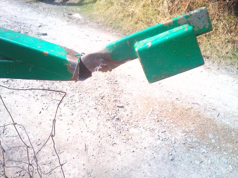

And now time for a grumble - the logging trucks have been trundling past for the last few weeks, fairly uneventfully. Until this.
It seems one of them has hit our gate, and buggered it fairly impressively. I did wonder about trying to weld it back straight, but the difficulty would be getting power to it. We've reported it, but aren't holding our breath they'll replace it any time soon

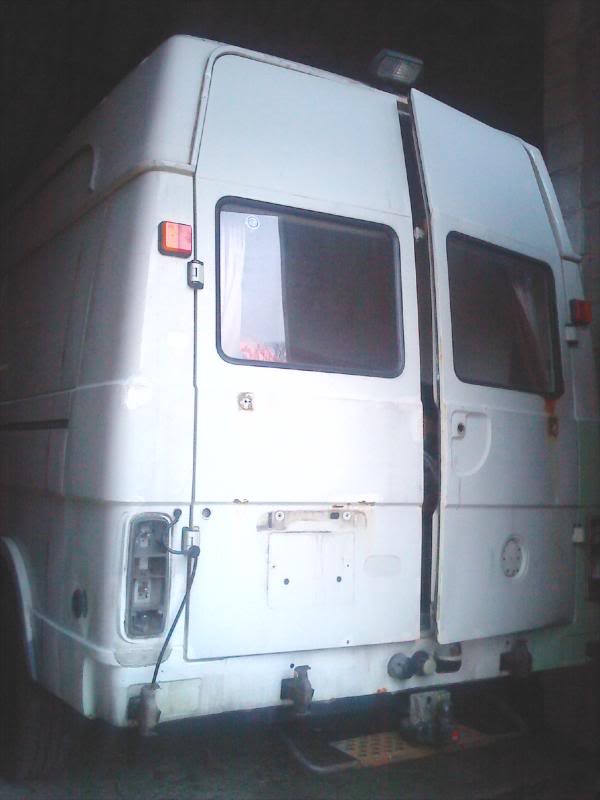

Also did some paintwork on the van, although the flatting back took longer than actually applying the paint!
The colour hasn't come out true to life in the second photo, as daylight was fading - it's less 'in your face' than it appears. I'm really pleased with the colour; just what we wanted and although it's hardly a concours job when you apply it with a roller, I was pleasantly surprised how the marks disappeared as it dried.

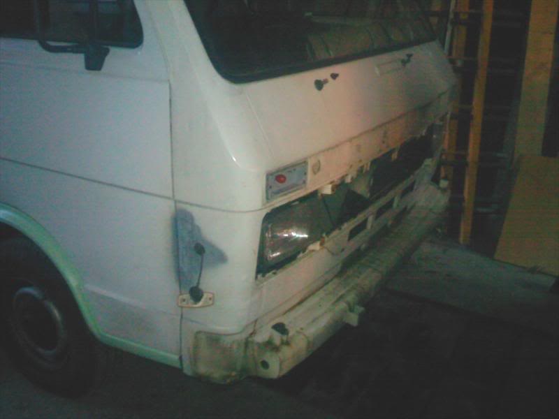

Tonight saw me stripping stuff off the van ready for paint:

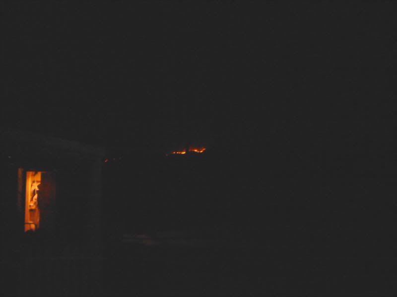

Still no rain, and a glow in the sky alerted me to the fact the forest had caught fire!
Fortunately the wind is taking it away from us, so we can sleep relatively easy tonight. Unless of course another one starts the other side of the house...

Hmmm, famous last words.mat_fenwick wrote:Fortunately the wind is taking it away from us, so we can sleep relatively easy tonight. Unless of course another one starts the other side of the house...
Another fire on the opposite hillside

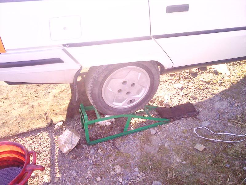

Looking on the bright side I then managed to repair the LHM leak on the red BX as this (fuzzy) photo shows.
The true test will be dropping it to low and having the fluid return back to the reservoir, which I can't do as the back end is in the air. Seems dry so far though!
