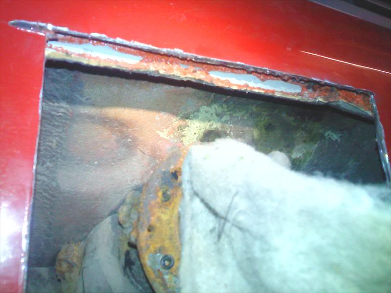

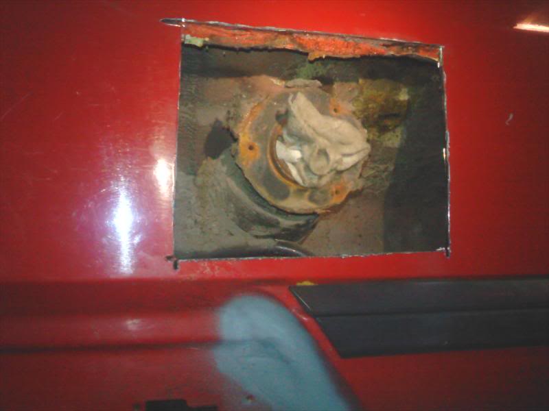

Back to the rear wing rust now - as the panel is on its way I could set about hacking into my rear wing. Here's what it looked like before:
Notice how the filler neck appears to be fine, which pleased me. Fast forward a couple of months to now, and I attacked the panel with the angle grinder.

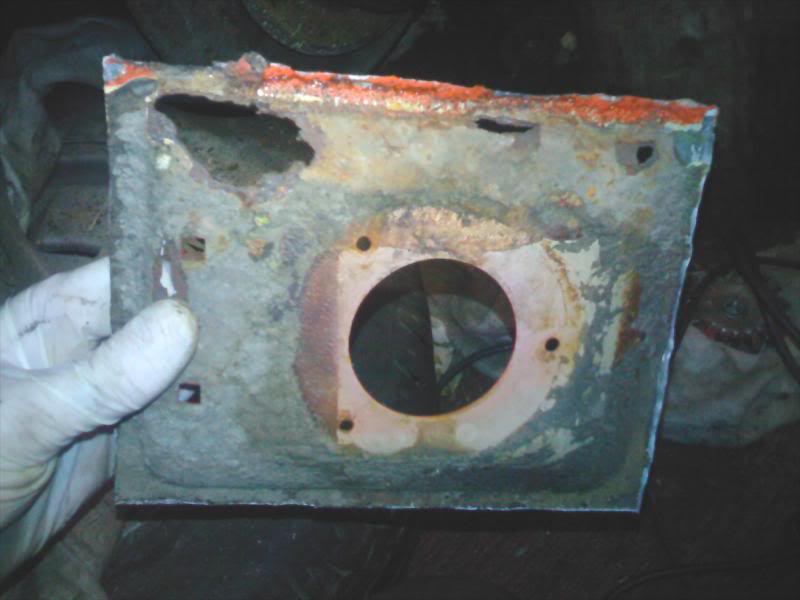

Lots of mud present, despite regularly hosing out and a thorough pressure wash before taking it off the road. The mud was all slate dust and pine needles (i.e all stuff from our track), so a city car would probably not suffer so much. The reverse of the panel shows how much the rust extends, so trying to butt weld in a couple of patches from the front would have been tricky to weld to the weakened steel. Plus, I would never have been able to clean up the rear face satisfactorily.
After cutting away the seam sealer no rust was present on the inner wing :)
...but let's have a closer look at the filler neck.
:( Bugger. Although the neck itself is OK, the flange which the flap engages into (no smutty remarks required please [-X ) has corroded away. It's another one of those jobs I haven't done on a BX before, so I'm unsure whether that is available separately from the neck (it's riveted together so doubtful). I'm off to trawl the forum as I'm sure my question has been answered previously. I know Chevronics have some new necks in stock, but would rather keep costs down if at all possible after my recent eBay antics!

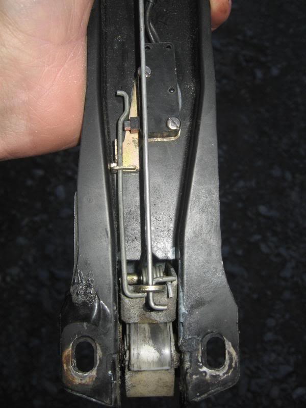

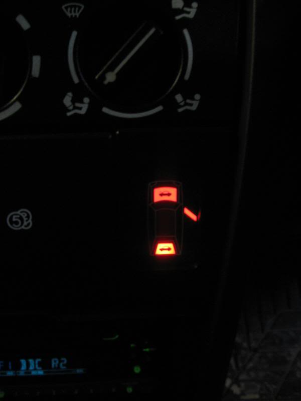

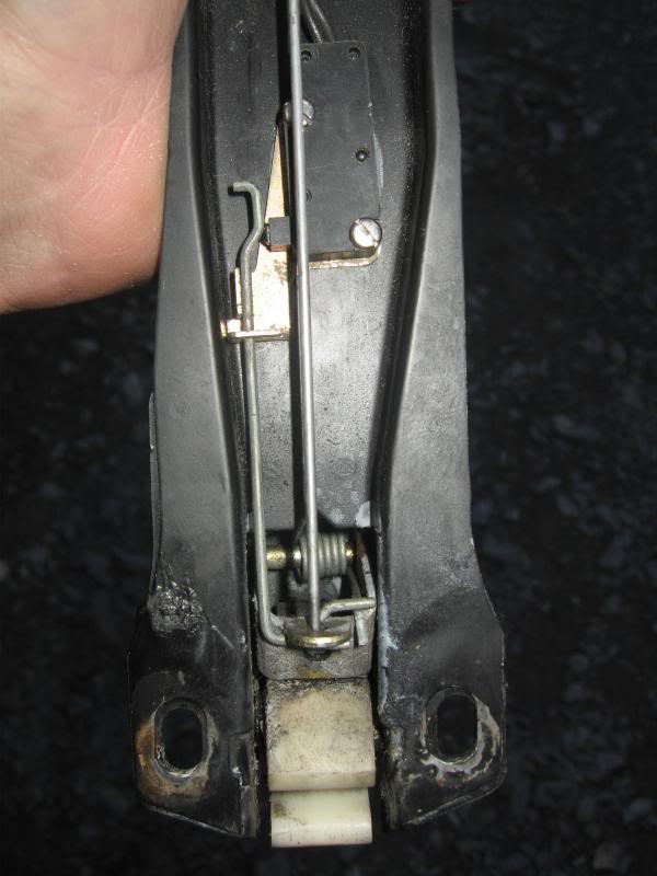

My tailgate latch mechanism arrived from eBay today, and depite being listed for an estate, was clearly for a hatchback. It mattered little, as all I was after was the switch mechanism to trigger the tailgate open warning light on the dashboard (were any estates fitted with this - I've only seen it on hatchbacks?) With a little bit of modification I got it to fit the estate latch. I also had to glue in the captive nuts which secure the latch mechanism, as 20 years of use has caused a couple of them to loosen.

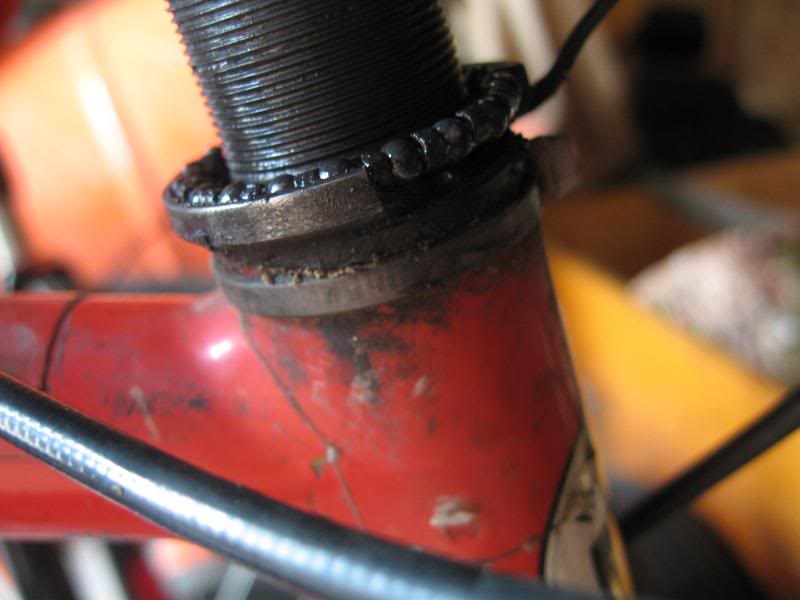

Another thing that has seen 20 years of use is my mountain bike. I was out on it at the weekend, and noticed some play in the headset bearings. On stripping it down today I found that the upper cup which sits in the frame had shattered! I suppose it's done getting on for 10k miles, most of them off road so I can't complain.

Here's a photo of the remains of the headset on my bike...
...although nicely greased, obviously metal fatigue has taken its toll. Still, not much demand for one of that size any more so picked up an identical replacement for £15 delivered :)
Back to the BX, this is the switch added to the estate latch mechanism. Tailgate open:
and closed:
OK, I admit that I'm sad but little things like this are important to me!
