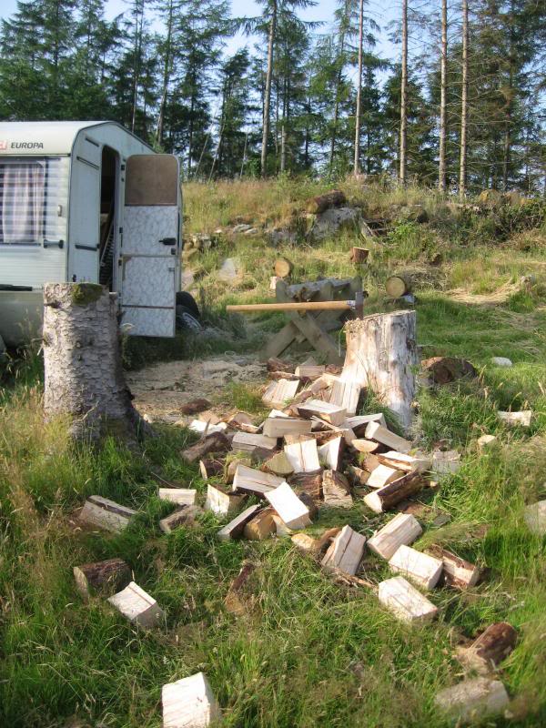

So this is how I do it with my manual firewood processing machine!
The splitting doesn't always go smoothly, as the spruce we are using is very knotty.
It is SO hot working in this weather, but I shouldn't complain as it's one job you just can't do in wet weather. I'll be glad when we've built up a decent stock and I can actually enjoy the sunshine though.

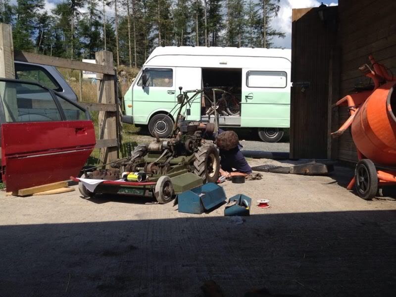

Today saw some fettling to the mower (not used for a few years so I needed to clean the carb out and also the points. It started first pull but annoyingly it's still not running 100%; fine at idle and low revs but about half throttle it just coughs and misfires.

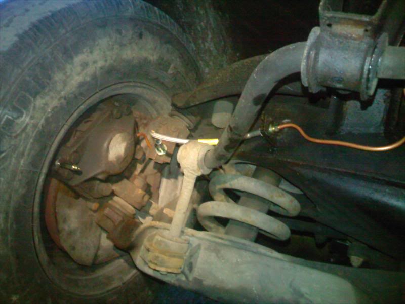

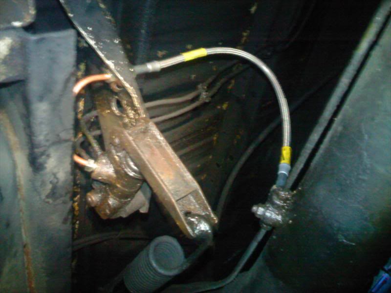

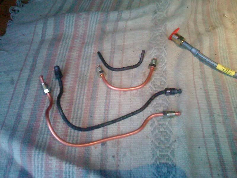

FINALLY, the hoses for the van arrived today - so much for next day delivery! Some of the steel lines looked a bit fragile, so while I'm replacing the hoses I thought I'd put in new copper pipes:
Rear hose in place...
...and the fronts, complete with new bleed nipple which was an absolute bastard to get out!
Should be able to bleed it tomorrow evening and take it for the retest Thursday. Sorry for the poor photos - my camera has developed a lens fault, only about a week or so after I had it in bits replacing the LCD screen which I'd cracked. Never had these problems with a film camera...

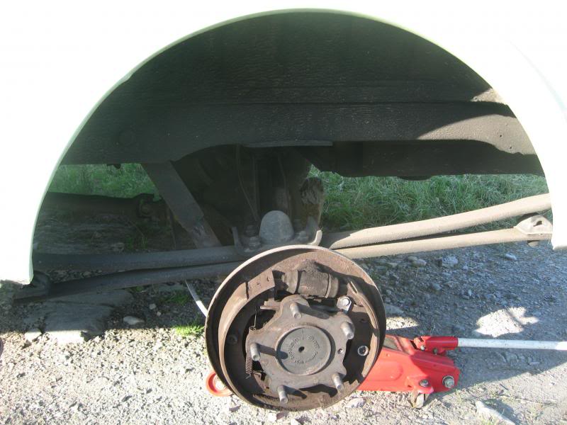

Well kind of. The van now has a fresh MOT, although there is still air in the system somewhere. I reckon one of the rear wheel cylinders, as the bleed nipple had crumbled to dust and was impossible to undo. New cylinder should be here by the weekend.

Then came back and fitted electronic ignition to the mower - result! Starts and runs beautifully. I suspect there is a little bit of wear to the points pushrod hole after 40 odd years, allowing the timing to alter at high revs. They're now done away with, so problem solved!

I fitted the new wheel cylinder to the van on Friday and bled it but to no avail. My next thought was that it was trapped in the front calipers, as they had two bleed screws and I'd only been able to loosen one on each of them. The others had pretty much crumbled away, so I set about trying to remove them.
The first side I hammered a Torx bit into to try and turn it. My mistake was to use a cheap bit, which snapped off and was too hard to realistically drill. On the second side I progressively drilled out the screw with larger drill bits, however my mistake on this side was not realising the original hole was drilled at a slight angle. Once the remains of the bleed screw came out I could see that the threads on one side were damaged, and even if I drilled and tapped the next side up the hole was no longer central to the sealing face so wouldn't have sealed. Another fail!
So new calipers on order, which is a little bit frustrating for such a small problem. I'm not sure there would be enough material to put a helicoil into as it's quite close to the edge. One corroded ferrule on the rear flexi hose has turned into almost a complete re-pipe of the entire braking system, two new calipers and one rear wheel cylinder!
