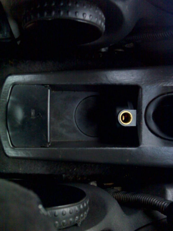

But priorities first - making it more like the BX! I needed another power outlet, so I've put in a DIN 4165 socket on the centre console.

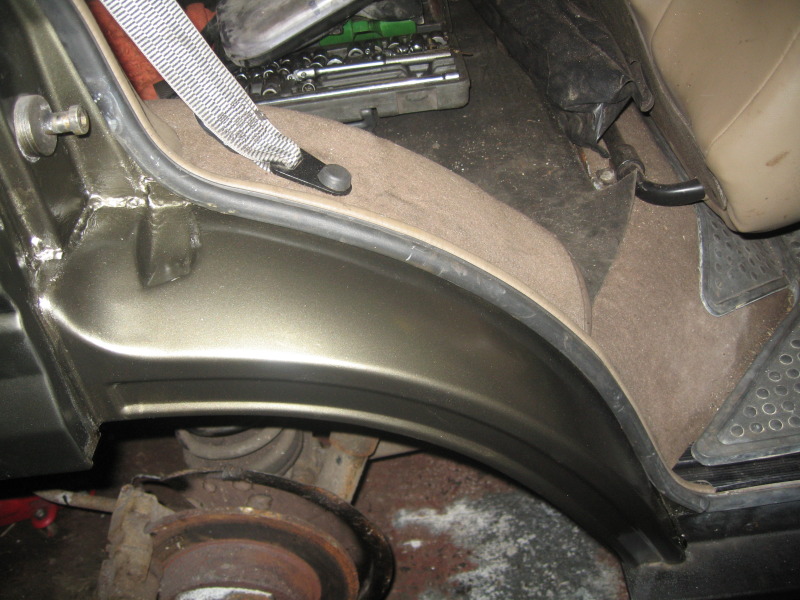

Finally finished the welding on the Discovery now, at least in this area. I've been painting the last couple of nights, and now it looks like this!
I think I will take off the sill covers on the other side, as although I know the top end of the wheel arch is fine, there may (will?) be rust behind the plastic. Hopefully if it's not yet thin or holed I can get away with removing the rust and protecting the good metal.

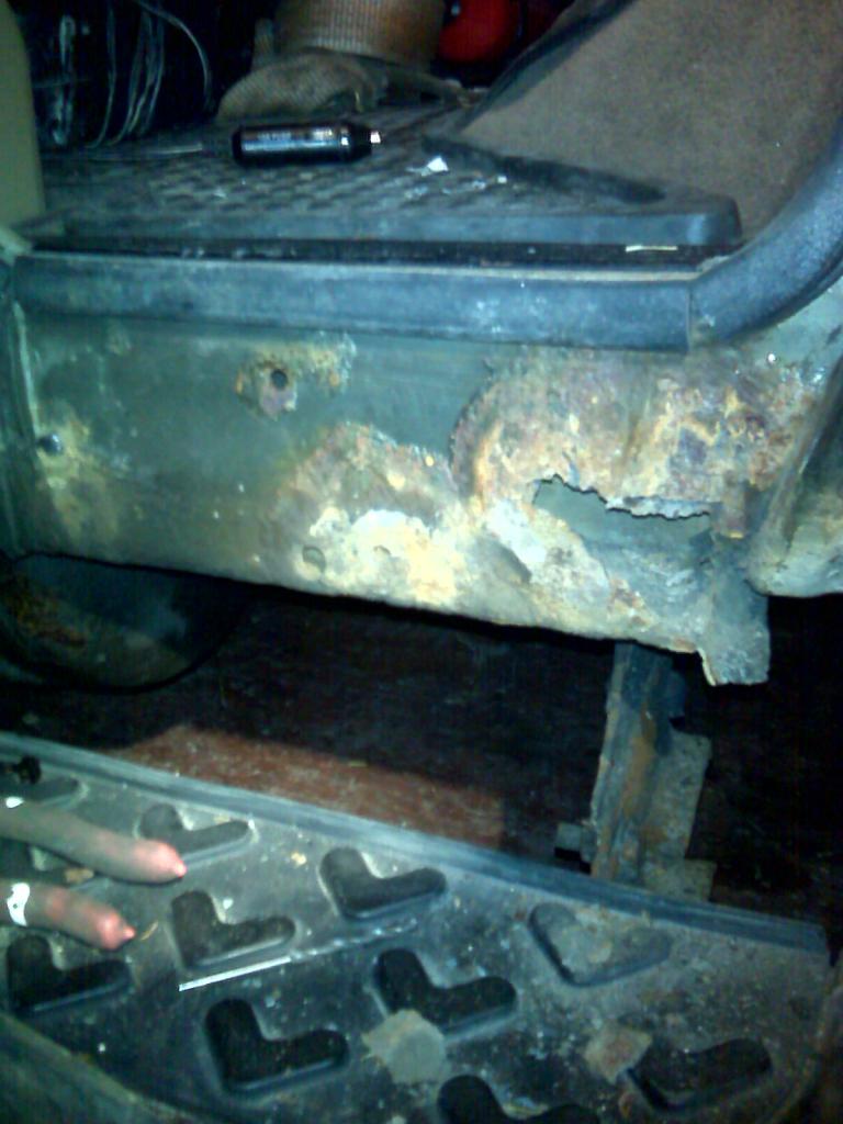

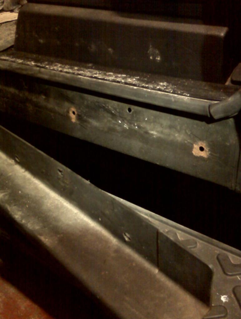

Last night I took the sill trim off the Discovery, to check for rust. At the front I found this:

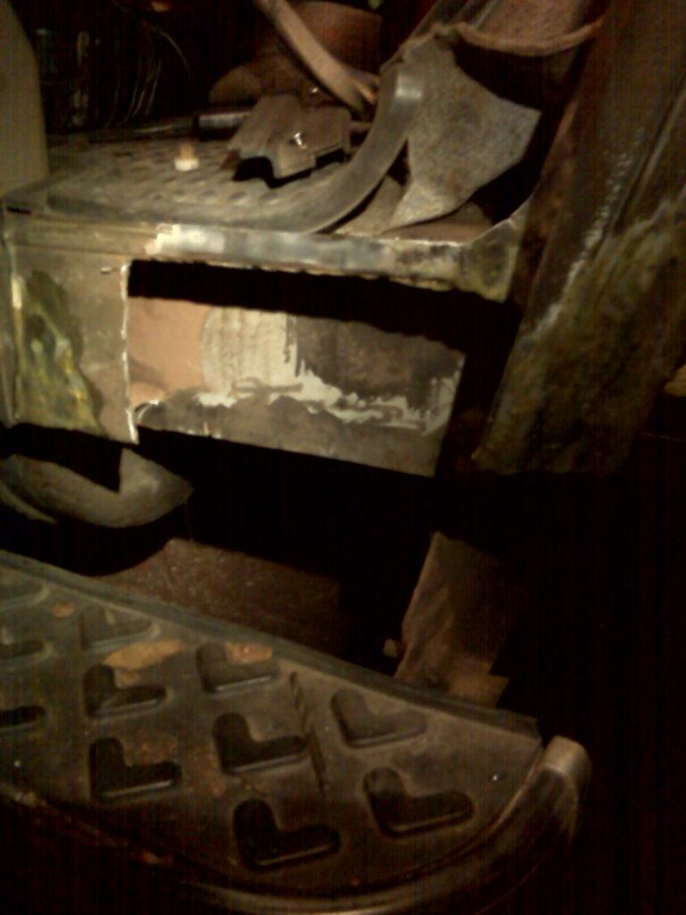

Not bad at all...but then at the rear there was this:
So that all had to be cut away:
That's how I've left it now, with a coating of rust remover on the areas I couldn't get a grinder to. Tonight's task was to change a front wheel bearing on the Focus. I'd bought a new hub with a month old bearing in it, for the grand sum of £15. Unfortunately I fell at the first hurdle - getting the hub nut undone

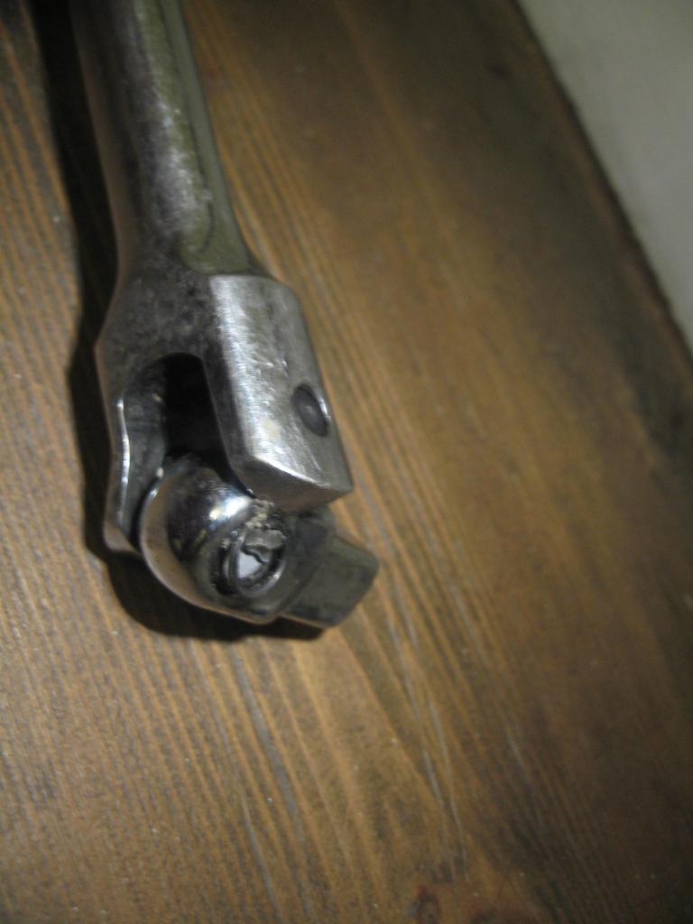

The first casualty was my trusty breaker bar:
Working it out with hindsight, I was using a tube approximately a metre long on the end of it. Standing on it with my body weight (80 kg) would be approximately 800 Nm, which had no effect. I can extent slightly more force by heaving on it than jumping on it, but it would seem that the breaker bar wasn't up to the task
Then I remembered I had a 4:1 torque multiplier. Tried that - still no joy. Using a metre extra leverage on that I estimate I put 3000+ Nm through it, and still didn't budge. Fearful of breaking it (there was a LOT of stored energy in it!) or me - I was straining quite a bit - I've called it a day for now, and will try getting a garage to loosen it tomorrow. Hopefully they've got some 1" drive sockets, and can safely exert more force.
