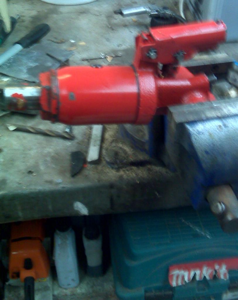

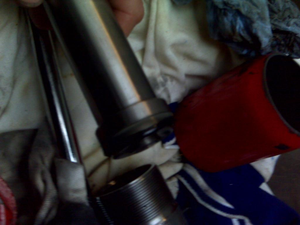

Stripped down the trolley jack ram today - you might be able to make out in this crap picture where the problem may be.
The O ring on the bottom of the piston seems to have popped out of its groove. I could have just popped it back in but seeing as I'd just spend almost £2 on a set of seals for it I put a new one in. Reassembly is almost complete, except I have one small fat O ring left over (maybe it's to do with the overload valve, which I’m leaving well alone?) and a conical gauze filter that must have dropped out from I don't know where. Anyone every stripped one down before? Logic says it would probably go between the hydraulic reservoir and the small cylinder, but I can't see where :( The oil was very dirty too - surprisingly for a closed system.

All fixed now, and holding pressure :)
I tested it this weekend by jacking up the Discovery, in order to change the gearbox oil filter. I didn't actually go underneath it whilst supported by a jack, but just used it to lift the front end up so I could slide some ramps underneath (meant I could lift up the end closest to the garage doors and still be able to close them if needs be).

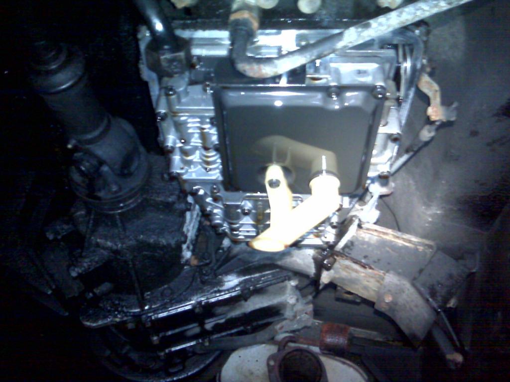

Haynes helpfully gives this job 5 spanners, followed by a thorough description of how to do it in detail:
Haynes wrote:This is an involved operation, and is best entrusted to a Land Rover dealer.
How hard can it be? Actually, not that tricky at all, but did take about 8 hours. First had to remove the exhaust system, which I managed without snapping any manifold studs (although at first glance I thought I wouldn't have a hope - they were incredibly stuck). Then had to drop down a crossmember underneath the 'box, which appears to be an interference fit between the chassis legs. I put a bottle jack between the legs to prise them apart a touch, and then dropped the sump.
Then just put everything back together! I greased the propshafts whilst I was under there - a very satisfying job but one which appears not be often missed. Talking to people about drivetrain slack in older Land Rovers they all say it's a common problem, but when you ask them how regularly they grease the sliding joints and UJs I'm often greeted with a blank look! I checked for more rust, and was pleasantly surprised not to see any, although the boot floor will need replacing I think in the next 2-3 years - the seams are swelling a little.

Nice job Mat. I did a auto fluid change in the XM this summer. One of those jobs that seems difficult, but once done is actually very easy. Dexron 2 is cheap, so I'll be doing the auto fluid at every oil and filter change. Just don't forget the magnets!! :-) :oops:

The only difficult bit was actually getting at the gearbox! Everything copper greased now, so should be easier next time.
