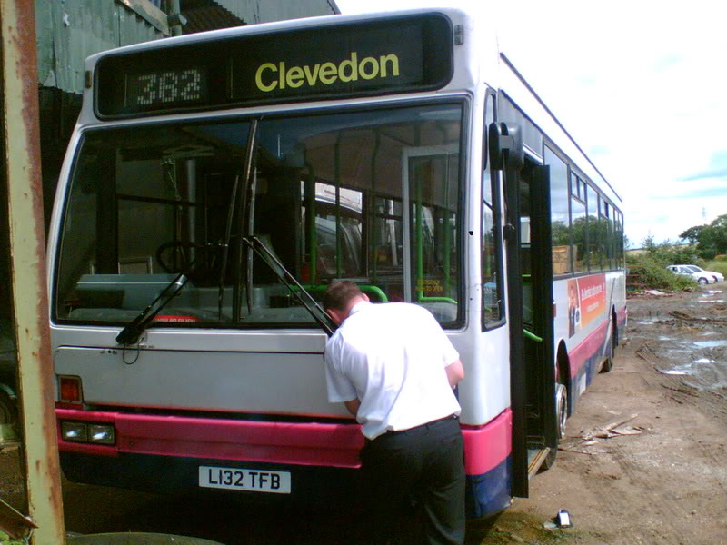

Within seconds of unloading the old girl off the truck I drove it up to the shed and my very good mate Matthew (who did alot of the leg work in me getting this thing in the first place) set about removing the various adverts and First stickers that adorned the bus:

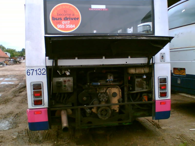

So, Saturday arrives and I set about finding out why it's only running on 5 cylinders and smoking like a northern industrial town in the thirties.

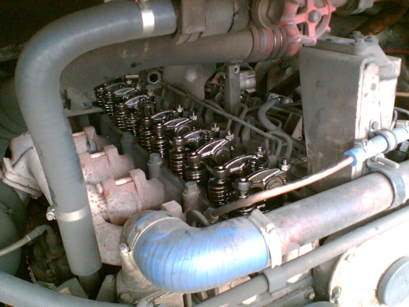

I had been told the engine had dropped a valve, but I didn't think it had. I pretty much thought an injector had blown..

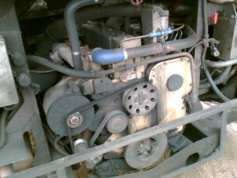

A rather lovely (and original) Cummins C series 8.3 litre direct injection Turbo Intercooled 211BHP engine!
Which is mated to this:
A ZF 5HP500 autobox with multistage hydradynamic retarder, lock up clutch and variable torque converter.
It's bloody big and very heavy!

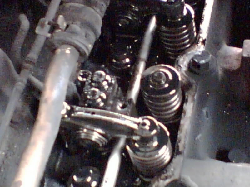

So, I ran the engine up and cracked each injector pipe off in turn, which told me Number 4 cylinder was not firing.
By now I had really convinced myself the injector had failed, but I pulled the rocker lid off (no easy task in itself on these) to check the tappet clearences and just to ensure it actually hadn't dropped a valve.

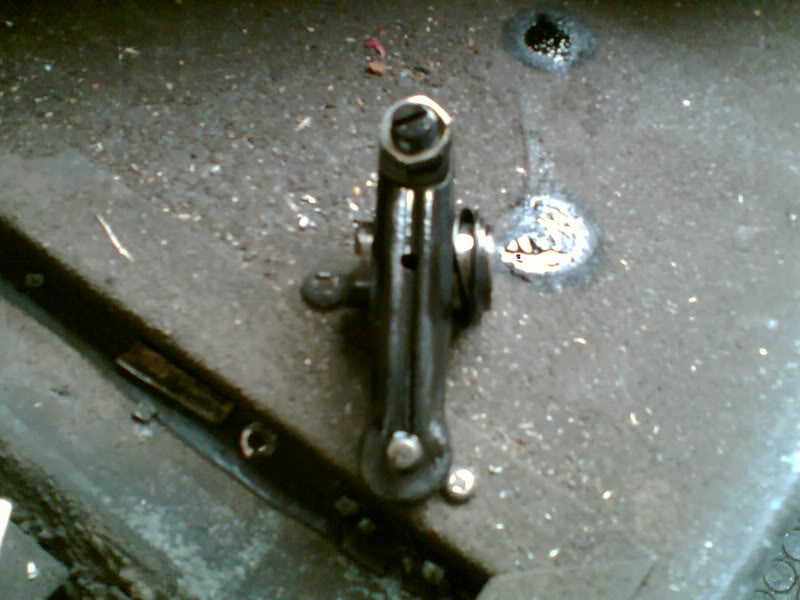

Once the lid was off the actual problem became apparent:
The rocker shaft on number 4 cylinder has failed. The entire inlet rocker was sat on the cylinder head still with the remains of the shaft in it.
Looks like metal fatige and everything else seems fine, so a new shaft will be ordered and fitted this week which should return it to 6 cylinders of diesely greatness!

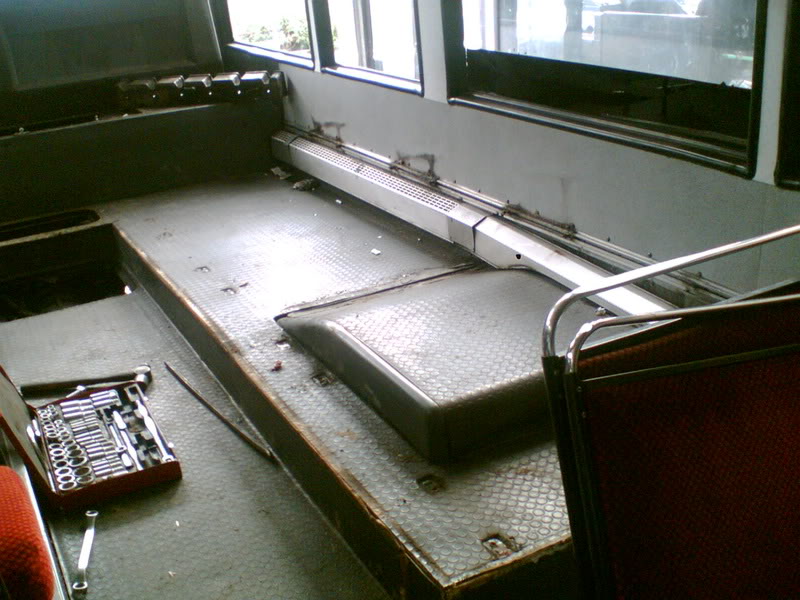

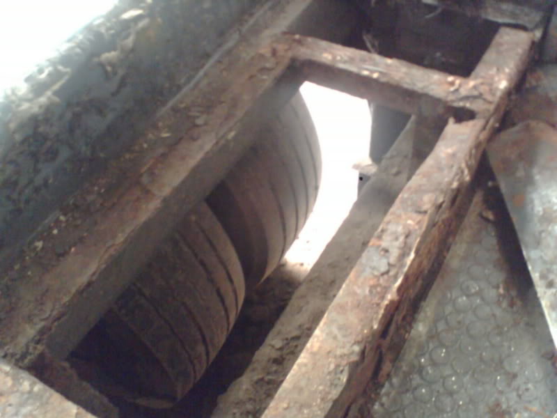

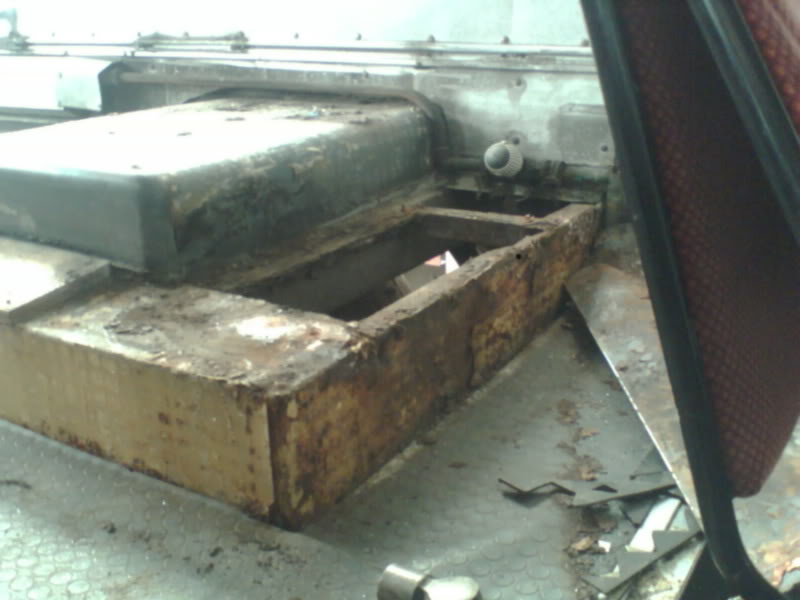

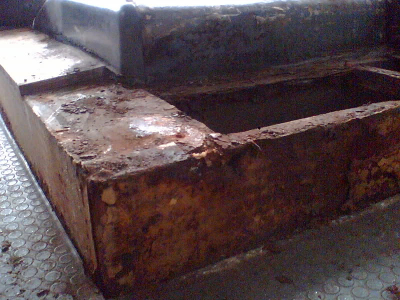

Since I cant do much else to the engine until I get a new shaft I turned my attention today to the floor and chassis at the back end:
Sadly, like all Verde Lances of this era it's as ripe as a pear:
So plenty of sutting and welding to do, but I'm not at all disheartened. All of the fleet are exactley the same or worse, and once I've got to grips with making up new stress panels, floor bearers and repairing bits of chassis here and there it will be better than new.

CitroJim wrote:Shocked at the corrosion though. How many passengers have you lost through holes in the floor?
None yet!
It's actually not as bad as 134 and 121 were. Both of which got scrapped recentley because of the corrosion.
134 was so bad when one of the bodymakers at work was walking up the gangway to the back of the bus the N/S front wheel arch was moving! It got binned the same day.
But there's still quite a number of Lances in the fleet, all the P1 Lances are as bad if not worse, and most of the P2 Lances are almost as bad. And they still ply the streets everyday with paying punters on. Scary aint it!
