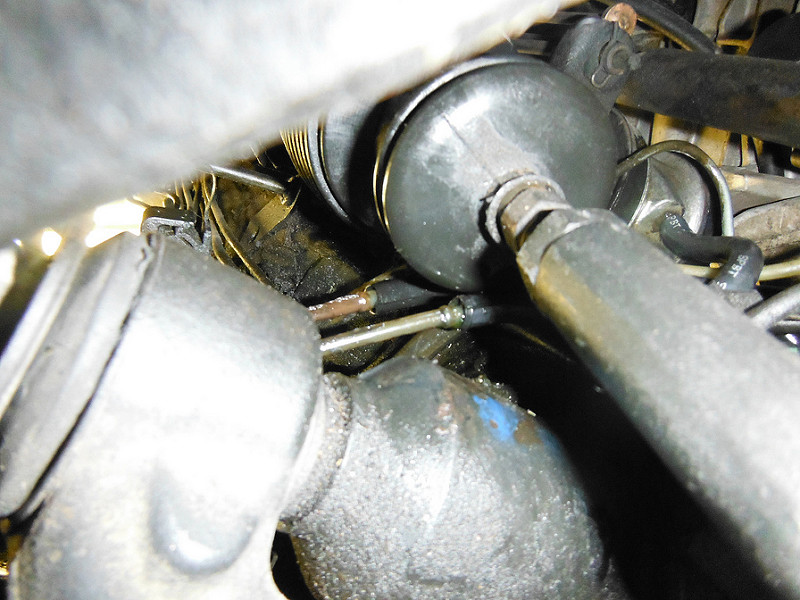

Having the same trouble, I cannot seem to get the brute force to shove these blighters in past the nipple. Thoughts? Seeing as I've already got them half way I'm hesitant to take them out and extend them as per Oilyspanner's quote below. I did a little stretching prior to fitting.
On the up side the rest of the octopus is in!
Octopus by tyro.chris, on Flickr
Oilyspanner wrote:TOP TIP there are two plastic pipes running down the chassis member under the drivers footwell area, they are different sizes, they both push into the ctopus on top of the crossmember in a totally inacessible place, cut them at an easily accessible point and once the old octopus is off plug the cut off bits into the new octopus, fit the new octopus and join the pipes where you cut them using some of your leftover rubber pipe, this will save a lot of time. especially as its easy to put the pipes in the wrong hole and get a leak.

frog wrote:Having the same trouble, I cannot seem to get the brute force to shove these blighters in past the nipple. Thoughts?
Are you referring to these two plastic returns in this picture? if so they are fully home when they fit upto the nipple not over it. This is just a guide to how far they need to be pushed on?
Re: Octopus Replacement
like he / \ says regarding the nipples
