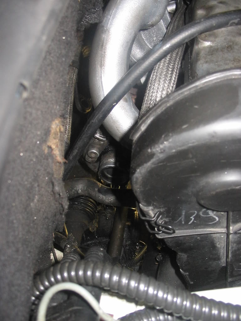

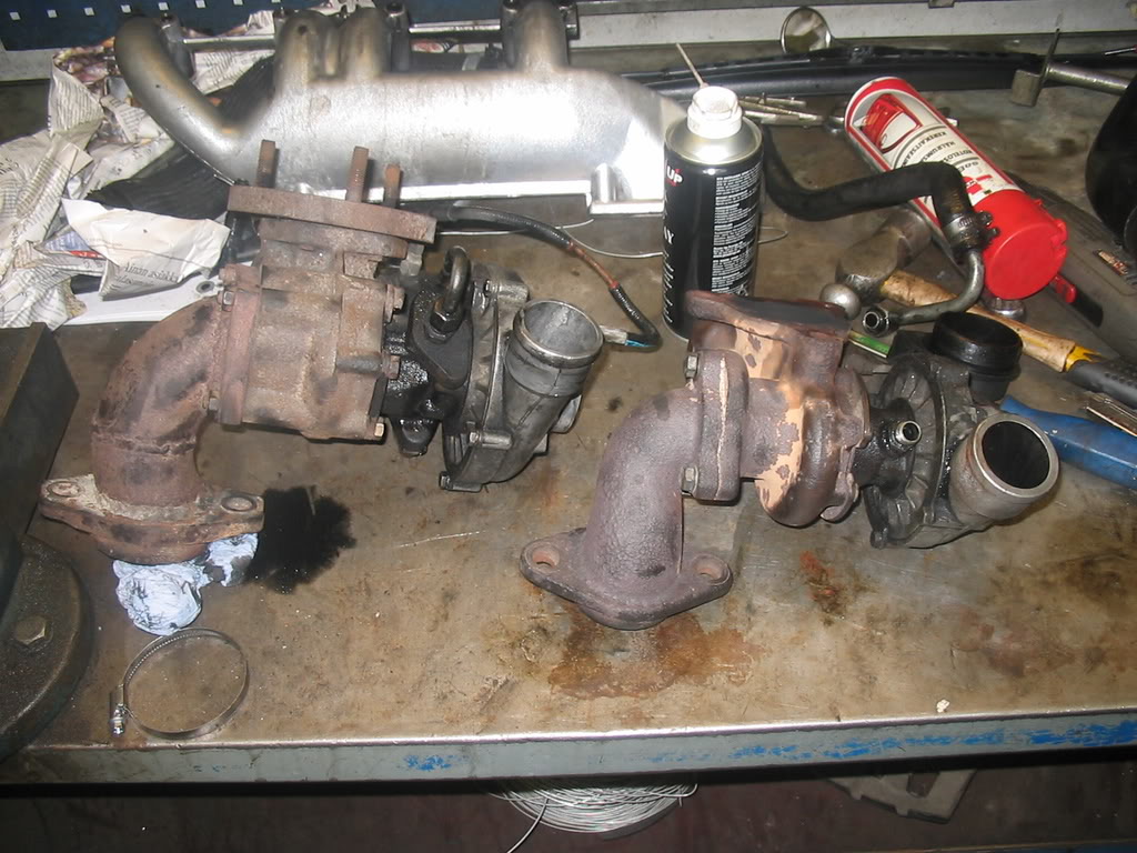

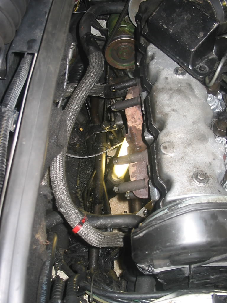

Bought a bigger turbo for this :)
Been trying to switch em, but can't say theres too much room ^^

there`s a lot of room jeth ... :D try harder ~ale~

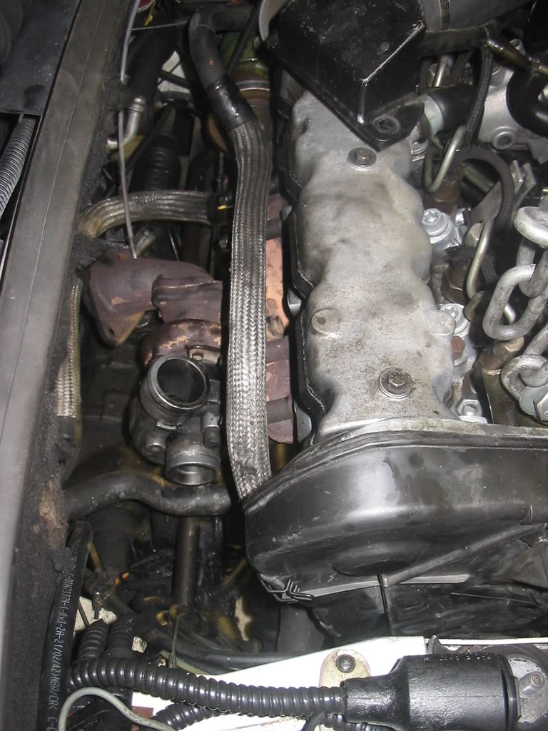

Post by Jeth » Sun Oct 19, 2008 7:55 pm
Got it done today, runs well :) Some minor tweaks left.

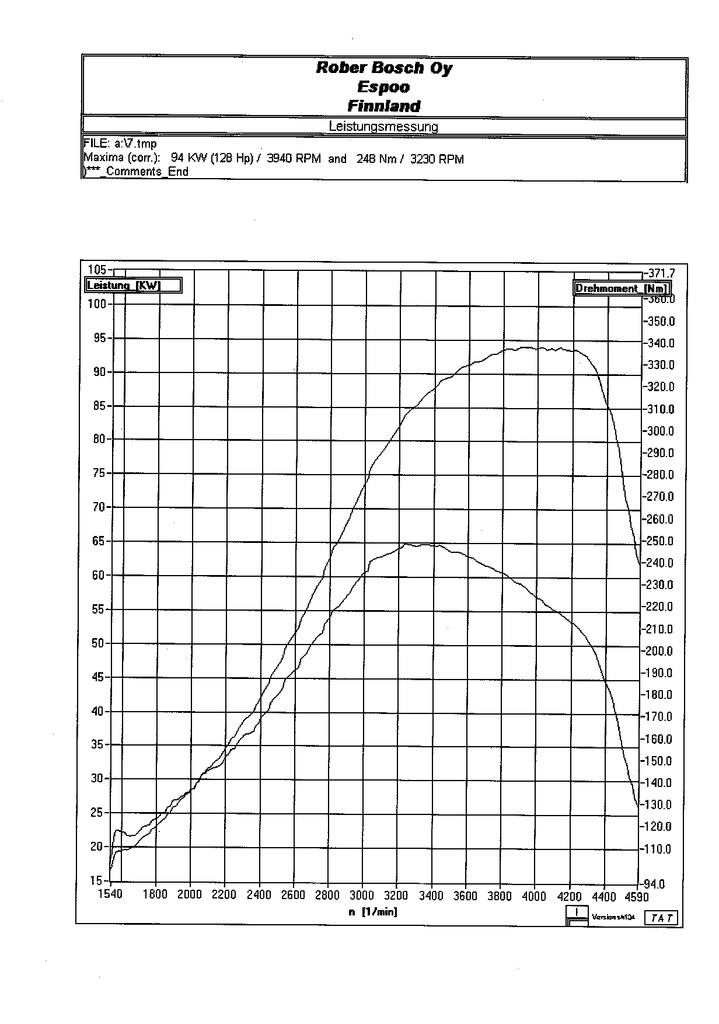

Post by Jeth » Tue Nov 18, 2008 7:36 pm
Tomorrow im taking it to rollers to see how much it has power, im hopin 130bhp and 250-300nm torque

Post by Jeth » Wed Nov 19, 2008 3:33 pm
128hp @ 3940rpm & 182lb-ft @ 3230rpm
Video will come when it's on YouTube ;)
Next thing is to take fuel pump off and change internals to bigger ones, it can't get enough fuel even on max fuel settings!

Good guess on the BHP! That's great stuff. Which pump internals will fit do you know already? I'm just rebuilding my Bosch pump but it's standard 1.7 Turbo internals. Did the re-positioned intercooler make alot of difference? I would think that the original fitted above a hot engine was not that efficient once the engine was hot!!!
So, how far are you going to go? :P
By the way, do you have a standard head and camshaft?
