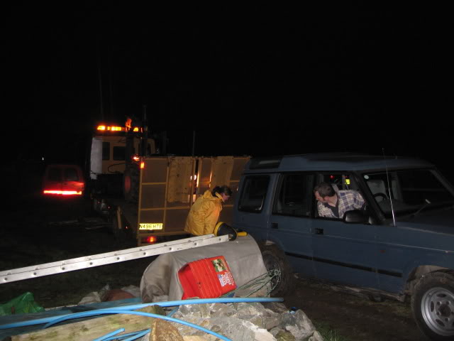

OK, I know we are going off topic, and this isn't even a Range Rover (but it is underneath), but just to prove that 4x4s DO have their uses...this is me pulling a (lightly laden) 7.5 ton recovery truck out of the mud.
It's hugely useful for towing as well, feel very stable even towing a 3 ton trailer. OK, I'll stop being all defensive now, and agree that probably the vast majority of the newer 4x4s aren't used in anger. More (IMO) for a perceived feeling of safety and pose value.
By the way, mine (and I'm sure Ian's as well) cost rather less than £40,000!
