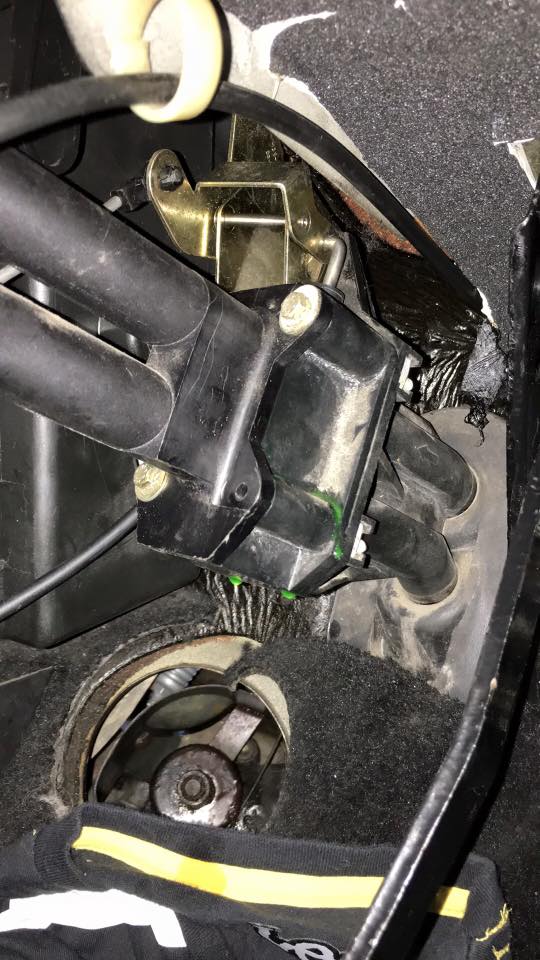

Well, hasn't gone as planned!
This tap wasn't leaking in the previous car.
I snapped that bottom right bolt trying to tighten it to stop the leaking..
So I've now got it all back in place, used some black silicone sealant and O rings from a different tap that look in a little better condition than these leaky ones.
I'll leave it all to set and report back in a few days, wish me luck!

Re: Heater Tap Replacement - How To
Ok, so back in and not leaking.
But I think the tap is slightly open as I have a little heat all the time!
Where the cable attaches to the tap must be a little out of adjustment?
Anyone have any suggestions for tackling this?
August edit: Still not leaking!
