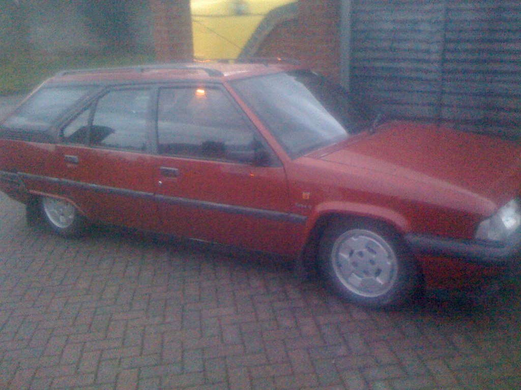

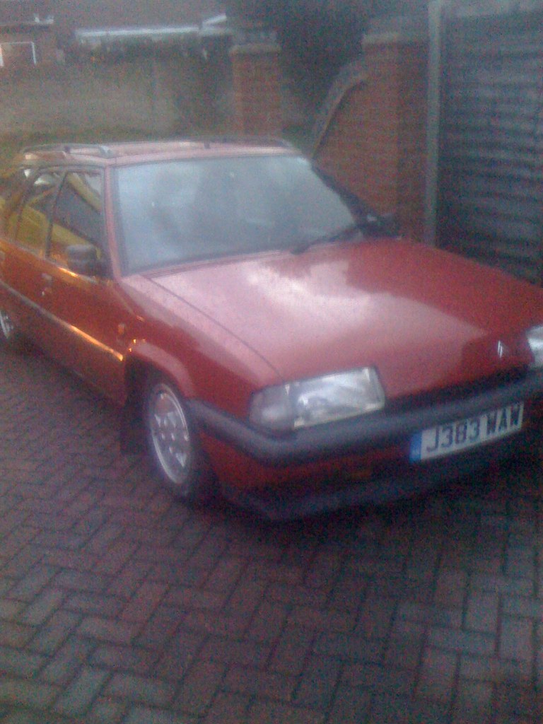

Couple of pictures taken on my iPhone, hence the poor quality. Just to get an idea.
Excellent. Looks nice in red. If you're every planning a trip to Edwards, give me a shout - I'd be on the way..

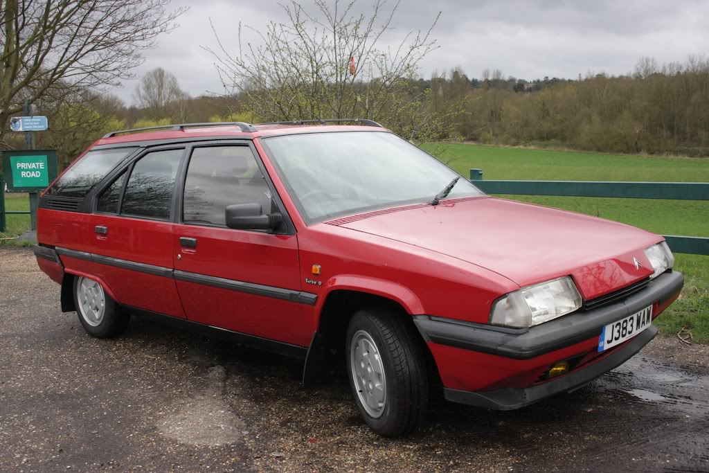

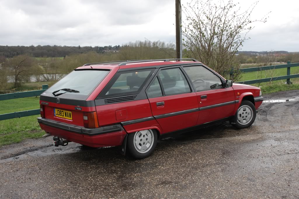

Well the BX is finally on the road after wrestling with the rear hydraulics for the suspension it now has new pipes, spheres and cylinders on the back. Also new discs, pads and wheel bearings, we also had the backing plates zinc coated and have sprayed them with hamerite.
Today managed to give it a very quick clean inbetween sudden down pours of rain and then drove it up the road for a couple of pictures and heres the result.....
Still jobs left to do, the fog lights are in but there was no wiring so I need to work out how to wire them up. Needs a proper clean, polish and wax to get it looking its best! That will hopefully happen soon if the weather clears up!

She cleans up well mate, well done! Like the Turbo D badge! 8)
