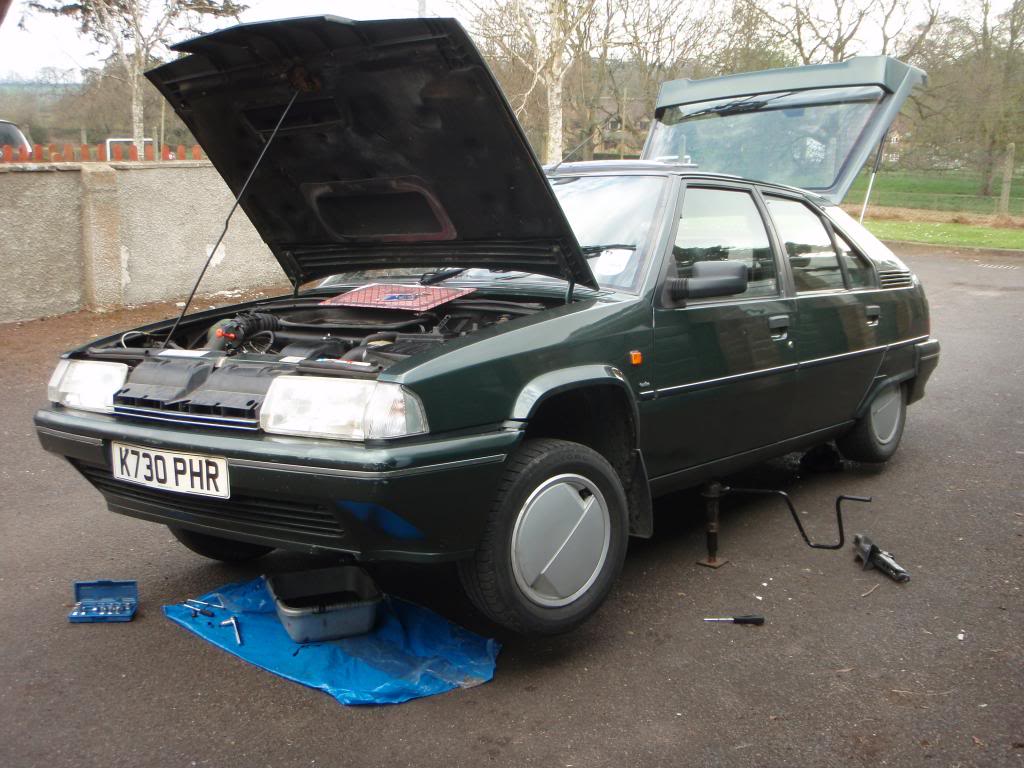

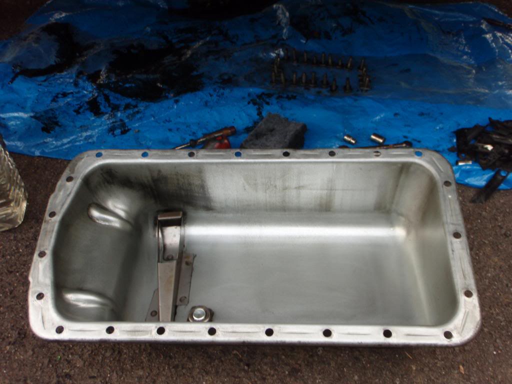

Did the sump gasket today, took a ridiculously long time, just over 3 hours. The longest bit was cleaning off all the gasket residue on the mating surfaces, it was really hard and compacted around the bolt holes, I had to use a screwdriver and plenty of white spirit to get it all off... It had been bodged in the past too, black silicone was [resent around the edges of the gasket. Obviously put some new oil in too, went for the Total brand semi synthetic for turbo diesels which was a mid range price, but apparently decent stuff - it has made a differ3ence to turbo noise, it's more audible now, whether that's good or bad i'm not too fussed - it sounds better!
From this.
To this!

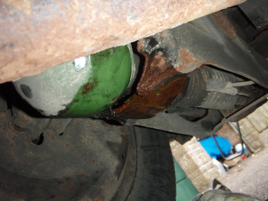

It was quite a leak, and came from inside the sphere 'cup', I could see that it wasn't the sphere seals, but a leak somewhere inside the cup, LHM was filling up in there and leaking over the edge. I jacked this corner up and put the suspension on low, and the leak almost stopped. It wasn't a dribble, it was a drip, but it was 4 drips per second or so. Not sure what could cause this? I planned on taking the sphere off to see what was going on, but I ran out of time. Any ideas on what this could be? It sounds suspiciously like Ian's problem with his TZD estate, a hole in the rear cylinder.

Re: the LHM leak, if it's not spurting out I would be confident it's not the cylinder which has developed a hole.

It was only a fast drip, thanks Mat, that's put my mind to rest a bit! I'll just have to whip the sphere off and look to see what what. Another note, it made a quite audible gurgling noise when I put it in low (whilst leaking), almost like when you pull the plug on a bath, and the water is draining out. Looked this morning, no puddle underneath but that doesn't mean it won't leak when running again...

No more leaks from the rear passenger strut, could it have leaked only because it was jacked up at a funny angle? If the supply/return pipes have holes, could the leaked LHM have collected in the boot and then just tipped out due to the angle? It's odd, but i'm not complaining that it's not leaked since!

saintjamesy89 wrote:No more leaks from the rear passenger strut, could it have leaked only because it was jacked up at a funny angle?
Hmmm, it's possible if the piston is damaged at one point along its length, it will only leak into the boot when the damaged area contacts the seal - i.e. at one particular height. See what happens when you raise and lower the car with the engine running?

I tried that afterwards, up and down with the engine running, no leaks. Did it yesterday too. When it leaked originally it was on high, then I jacked it up, turned the engine off and after a few minutes it stopped. Bit odd! It may be my imagination, but i've always thought that corner was softer than the other side at the back, that could be all sorts of things though, sphere pressure most likely. I keep meaning to get their pressures tested.
