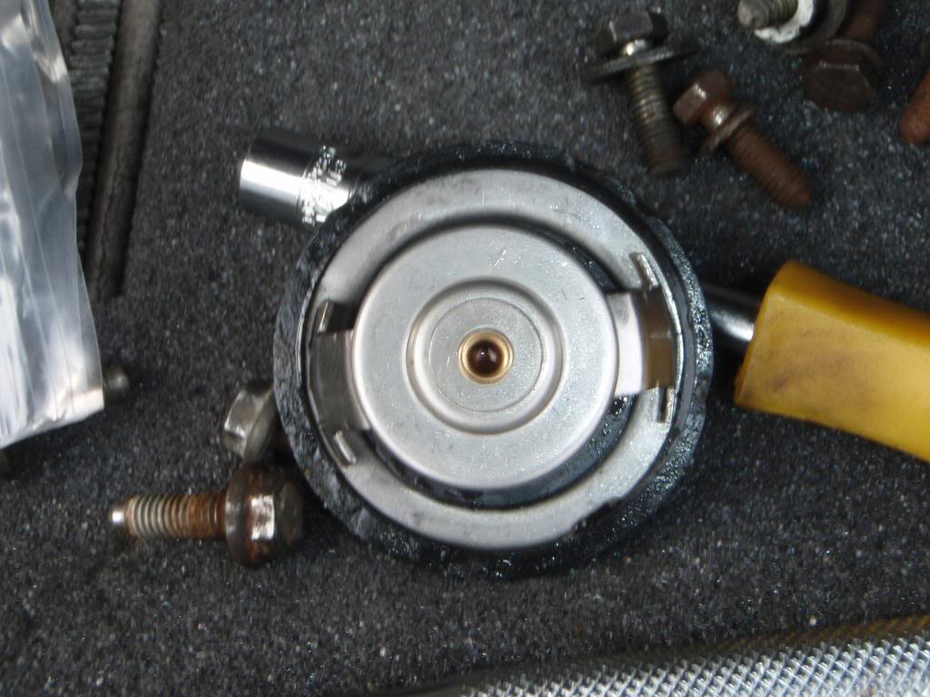

Today's tinkerings yielded a hopefully fixed water leak. I say hopefully, it's rather wet outside and I was working on the car in said wetness, meaning it was difficult to see if the hose-thermostat joint was still leaking. I needed a new thermostat seal in the end, you can see that there are a few imperfections around the edge of the seal.
I didn't even manage to burn my fingers! Quite a lot of water came out though, I reckon I must have put back in 3 or 4 liters (water and antifreeze, of course). I then waited for the stat to open and the water level dropped significantly so topped it back up, waited for the fan to come on, then go off again shortly after. Interestingly only 1 fan came on, does the secondary one only come on at a higher temp again?

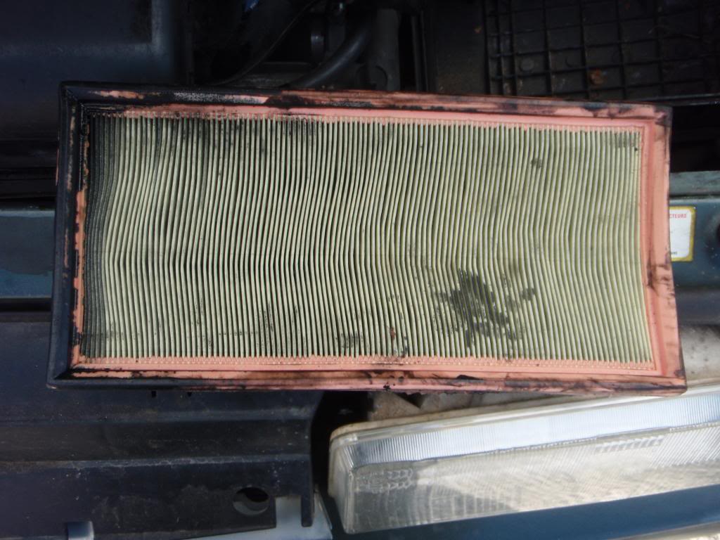

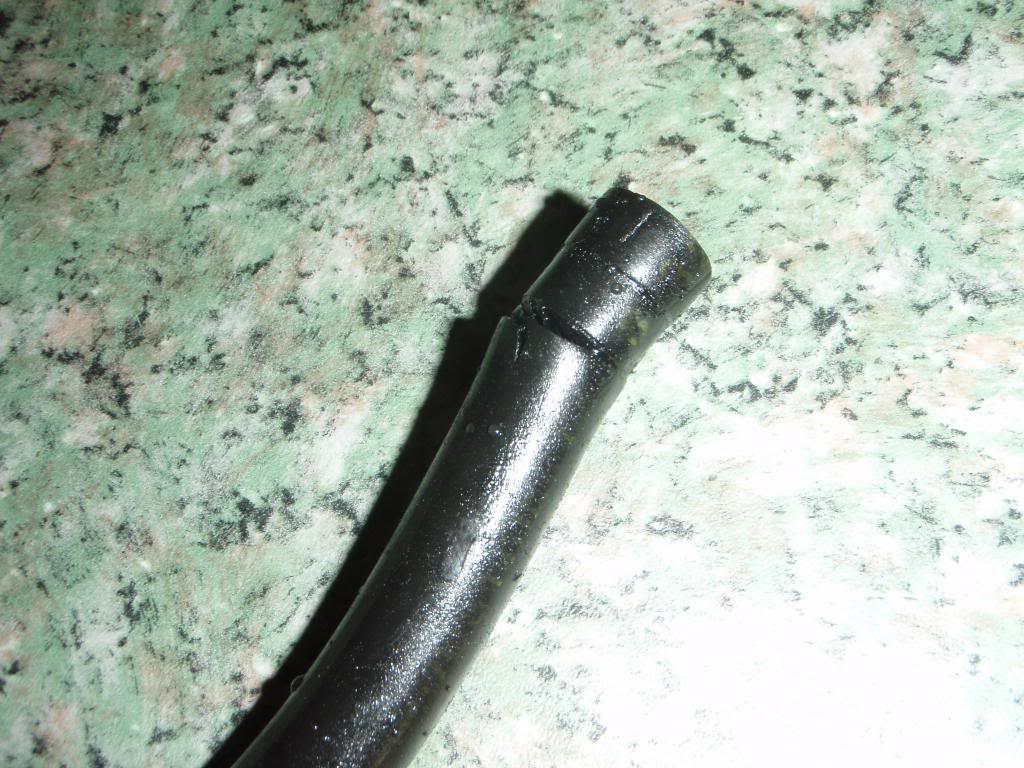

Little update, serviced the TXD today. New oil, filter and air filter. I was quite surprised how oily the air filter was, and the connecting pipework too - would this suggest a clogged breather somewhere?
The pipe photo's are of the two pipes that connect to the lid of the air filter housing. It was all quite oily in this upper part - perhaps accounting for the occasional blue smoke on startup. What are peoples thoughts?

My TZD does the same. I'm pretty sure the breather system is not functioning correctly. Might also explain why it's so keen to lose its engine oil (though it's still nowhere near as bad as our Mini was!). You may find that if you can sort the breather out, oil leaks may reduce - though I'd guess that the cam cover gasket is past its best.

Check the 'wire wool' breather pieces. In the petrols it maks a significant difference about keeping the air filter clean. As Malcolm says be aware there is a 'wool filter' in the oil filler neck, and this may apply to the diesels. Agree with you on costs, mine was £300 and will need about £500 of welding to keep her on the road for at least another 10 years. It's still good value. V similar - new sills, o/s inner wing, above rear sub frame. I'm no welder but know when it needs doing. Don't want to get it to the point like Jaba discovered! Good luck.

The turbo diesels do seem to blow a bit of oil into the air filter, i had the exact same thing on mine, although it was less than your piccy, how old is the filter? I always give the air filter box a hoover as well, its amazing how much dirt is at the bottom of it, so when you put a new filter in, it gets clogged up immediately by the crap in the bottom. Some of the dirt may be ingrained, so i just use a flat blade screwdriver to dig it out before hoovering, jobbed

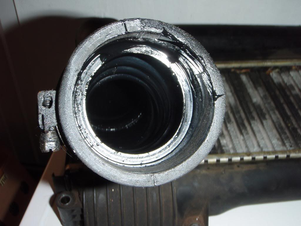

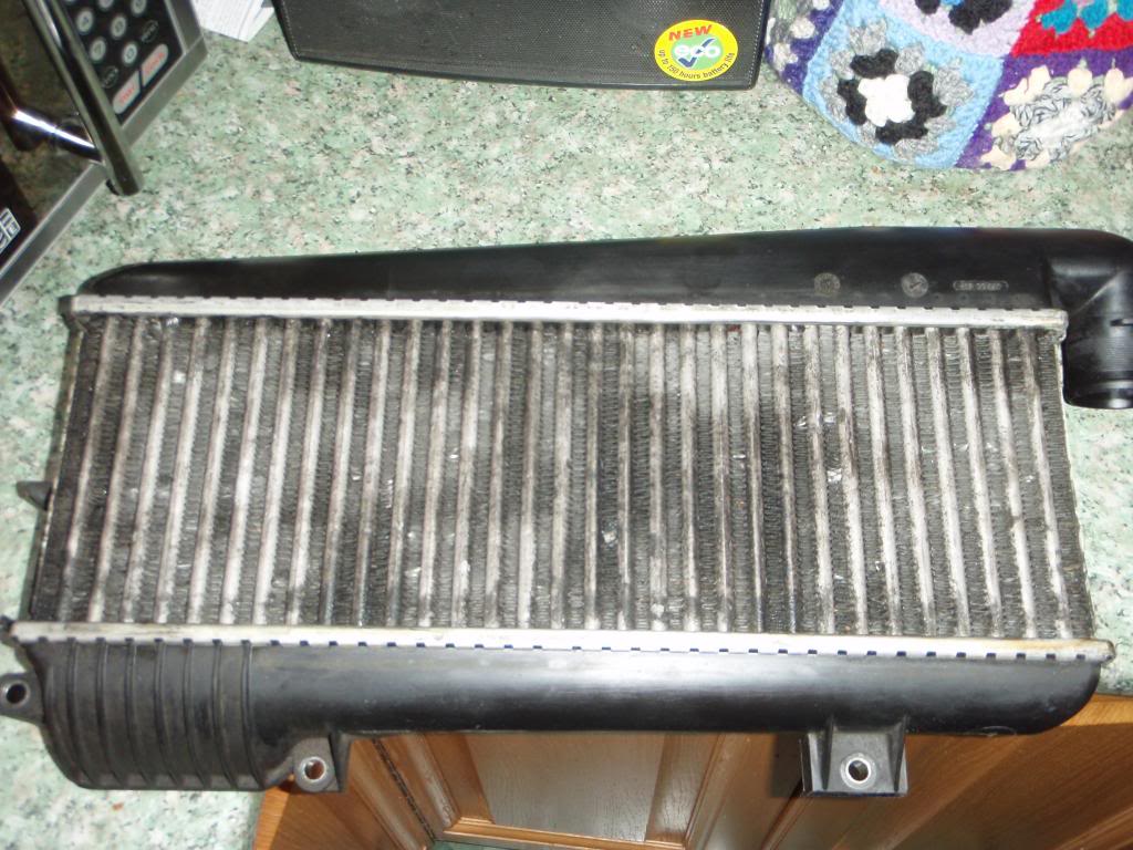

Had a little tinker with the TXD yesterday, the weather was quite beautiful down here so I decided housy jobs can wait! I thought i'd try to investigate this poor starting some of you may have read about in the technical section. Funny thing is, it has started perfectly since last Thursday, so not sure what was going on there.
I had all of the air intake pipes off and the intercooler for cleaning. Probably should have bought a new D shaped gasket for the 'cooler but the old one wasn't too bad, i've added it to the shopping list along with other GT things (poor, GT, haven't done anything with it for ages). All the pipes had some oil and grunge inside them, some alot worse than others, oddly I was expecting the intercooler-boost compensator hose to be clogged but this was the cleanest.

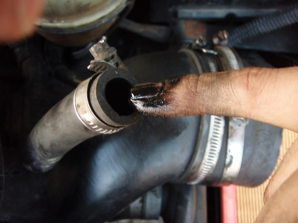

Doesn't this look bad? This is the intercooler-boost comp hose, after figuring out how to get the funny clip off (used mole grips in the end and pinched the sticking out bit) had to really wriggle and cajole the thing before it would move, hence the tear in the pipe. BUT, it wouldn't have torn if there wasn't an imperfection/split/hole in the first place, now would it? So I trimmed it back a bit, cleaned it and put it back on. Only thing is I couldn't get the funny clip done back up, so at the moment it's just sitting there - it's that tight a fit though that I doubt it'll come off. I'll have to go find a dinky jubilee.

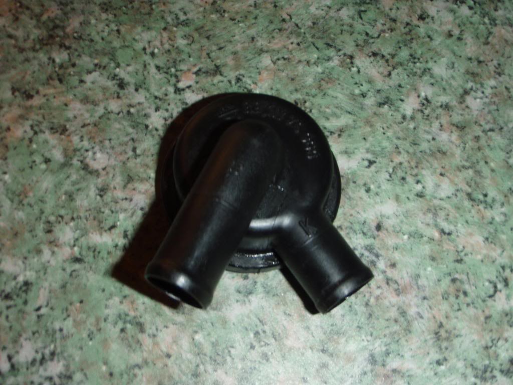

This is either the oil filler-round thingy (Mick! I have one on my TXD!) or round thingy-air box hose, very oily they both were. Anyone know what the round thingy is? When I blew through it and passed water through it something rotated when it passed through one way, but not the other.
Round thingy, mounted on the RHS of the intercooler. Slots into a metal clip and connects the oil filler and the air box.

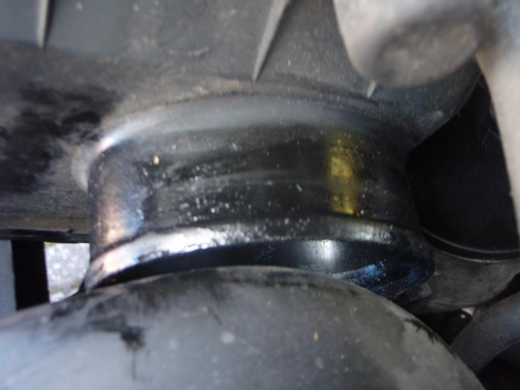

Oilyness of the turbo air intake pipe just after the flexy section, this I didn't remove cos it looked like a right PITA to get the other end off, I didn't look, but from previous endeavors I know just how limited access in the turbo area, so didn't bother! Should really have done, but I only had an afternoon and needed to use the car this morning.
Clean intercooler! Yes, I know, it's not that clean, but it's the best I could do with the materials to hand. I used the kitchen sink, fairy liquid and the hot tap. Managed to avoid getting told off too

After all that cleaning, I have noticed it's a bit perkier off boost, especially at lower revs, it's smoother too. No perceived difference on boost or top end though. Looks like I will have to look at the boost compensator unit...
