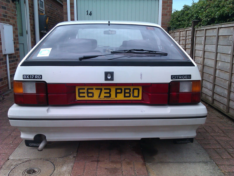

Since the rear number plate was pointed out as being slightly wonky, it's been bugging me a lot. Using the little squares that form the reflective pattern of the back panel I realigned the number plate. It required very, very minimal filing of the number plate holes, about .25mm to the top of one and the bottom of the other, and it's now straight again. This was then undone by the fact that the plate is slightly warped on the driver's side and casts a bit more shadow at the corner, making it look wonky again.
The exhaust either needs rotating or the hanger bending slightly to get the alignment improved on that, neither of which are jobs I wanted to do today. I can't remember whether or not the exhaust was wonky when I got the car, but since I've had it off and back on again it's entirely possible it wasn't and I've just refitted it slightly off. It's not difficult to sort, I imagine. The rear hanger can be got to even with the car on low, just fiddly.

Plate looks fine to me

If you are happy with how it looks then that is what really matters. But I must add that it all looks most acceptable to me and a credit to your work.
I would say the hanger on the EXHAUST BOX just needs bending down slightly which should tilt it up, you may need to loosen the clamp holding it to the centre cross box to allow this.

Had a look at this and while I've not had chance to actually fiddle about with it, seems I've actually just put the backbox on rotated a little too far around. I'll loosen the clamp, rotate the box around, and tighten it back up again, should sort it.

Try not to bend the hanger too much as this is a notorious rust spot it may break off unless you have already attended to this area, the hanger is only held to the boot floor with a couple of tack welds.
