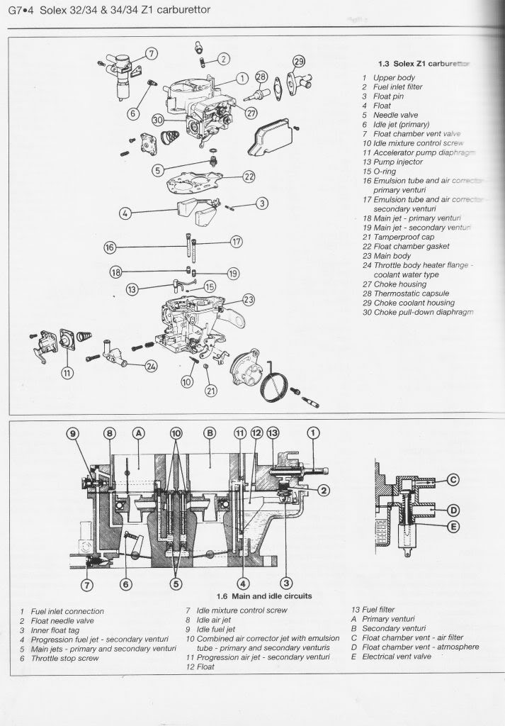

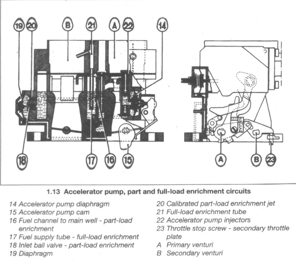

OK - to start while my scanner has a hissy fit over the next page.....
And the diag from the next page until scanner behaves... can add text, scanner allowing.

Thanks DLM that looks like the Standard Carb on the 19TRS but still dont show that thing I am after. :cry:

Yes, I know it's the standard BX19 Solex carb but thought I'd post the diags anyway so other minds can chew on it. At least it's possible to make a better guess about the significance of the points where extra pipes leave/enter.
