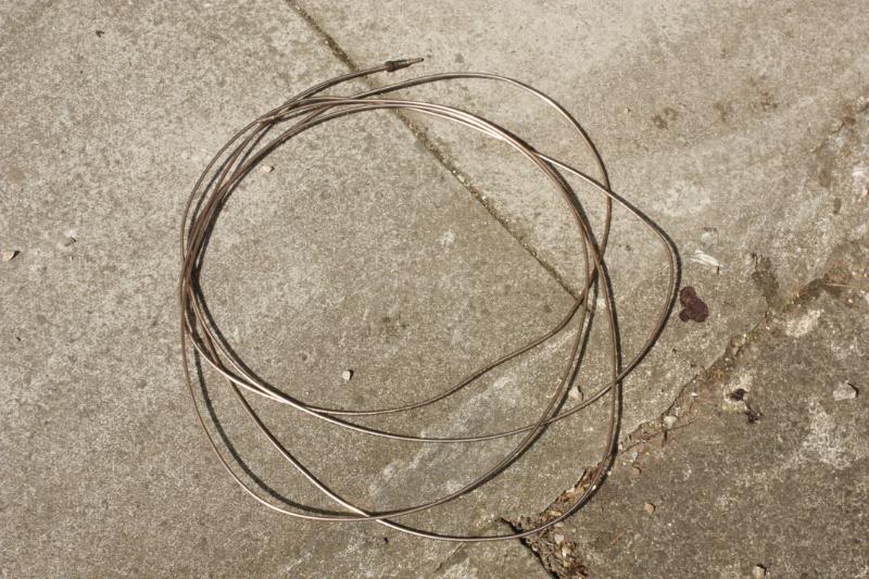

Inspecting the bust pipes, they were each completely rust free from one end to the other apart from the single rust area (less than 1" long) at the turn at the wheel arch.. Seemed such a waste that there was so much good material left.

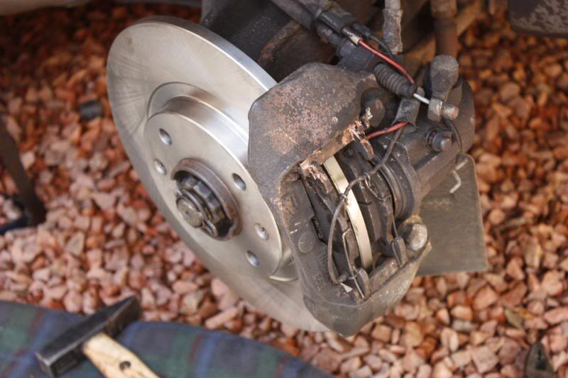

Right so I take it for an MOT and ...... FAIL
Both front disks are excessively pitted and N/S headlight aim too high.

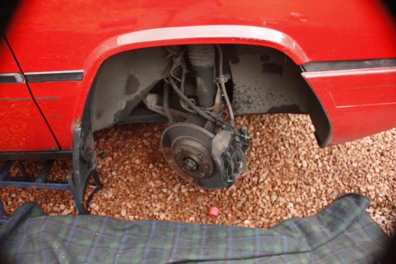

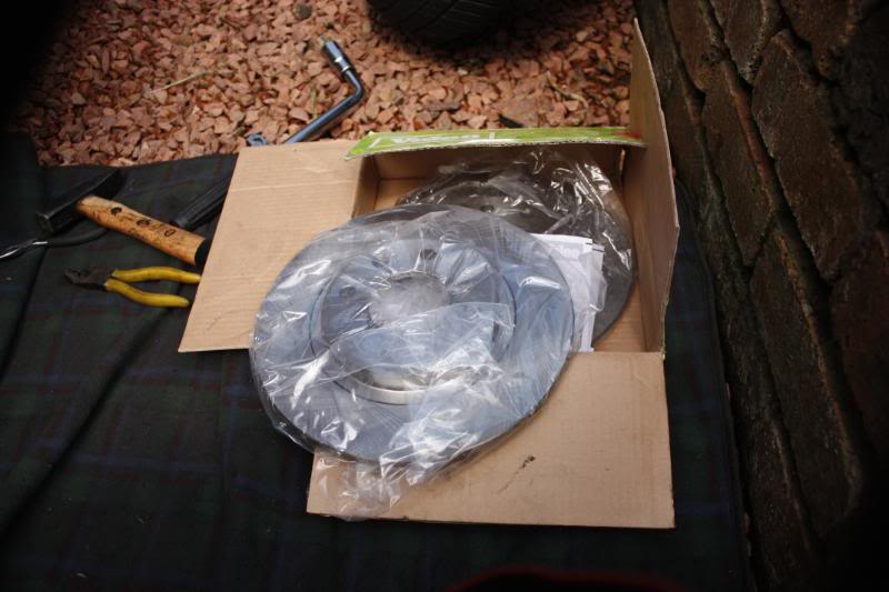

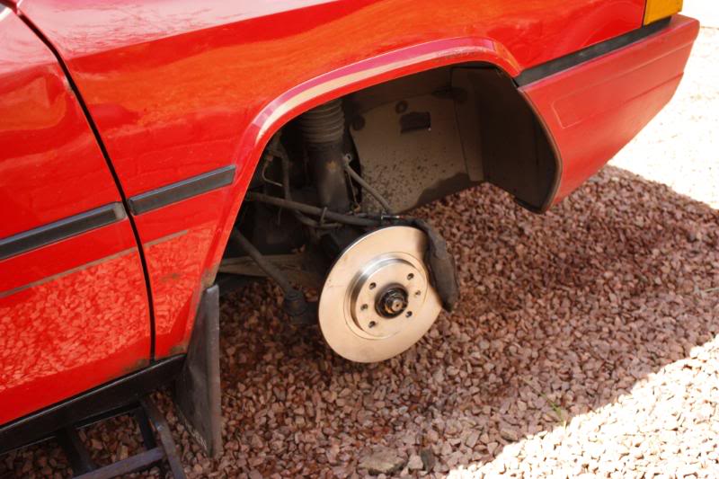

After getting the car there for 08:30am I was told there'd been an error and a car was booked for then - it would be done at 09:30 instead... Hmm. OK well I collect at half ten and off tho AEP to get a pair of disks £11 ea + vat and went back to fit them
Things going back together with new disk.
I love shiny new bits on old cars for some reason
