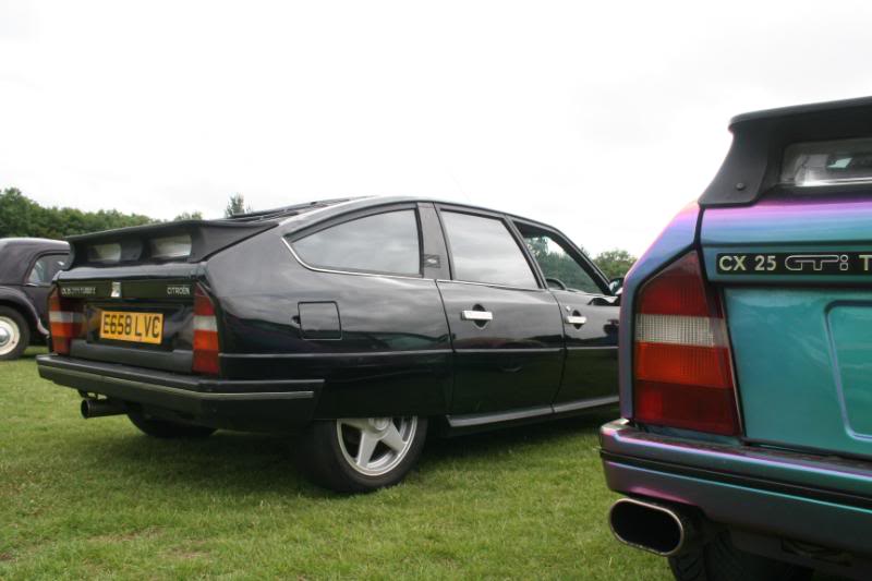

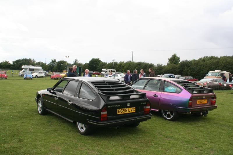

blink wrote:My first preference is Azev type A
I cannot say about Azev type A's on a BX, but i can on a CX :D They are very good wheels and look very good.
Azev A's FTW ^^ ^^ !!!
