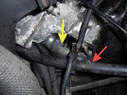

Poured some water in and found that whilst lying on the floor, I could see water dripping from at two places. One from the rear of the engine and one from the sump. Traced back to the same source.
Red arrow was where the water was leaking from in a steady trickle. Yellow arrow is where I picked at the hose with a finger nail and managed to remove a lump of rubber.
Went on a mission to AEP to get a 1307J4, came back, hacksawed the rusty clip off, mangled the shiny clip with a big screw driver off and cut the old hard disintegrating pipe off with a Stanley knife. Managed to squeeze the new pipe in there and get two stainless Jubilee clips on (that were fortunately the right size and in my toolbox there) Topped up with anti-freeze and no sign of water loss anywhere else.
