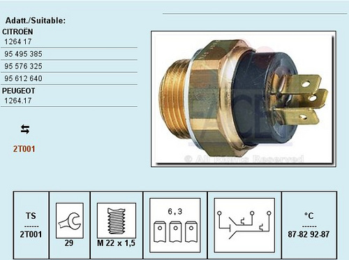

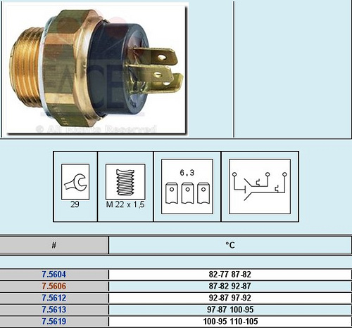

I would have thought it should have come on at say 85C slow then at 90C still be on but faster until it drops to 85C when the it goes slow again and cuts out when it drops to 80C. I wouldn't have thought there should be a wide gap in it.
Here is a typical BX thermoswitch:
Temperature variants available (depending on model) of that thermoswitch:
(The rest of that catalogue is at www.facet.it :wink: )

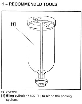

There is always the home-made version of this:
(Plastic bottle with bottom cut off and old radiator cap)
to help with bleeding the cooling system.
Makes the radiator filler the highest point in the system, thus making bleeding easier.

whats that pic ?
