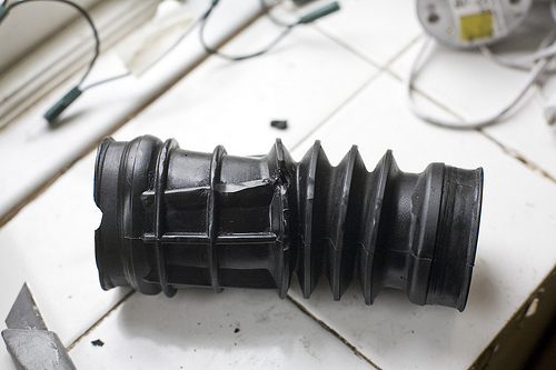

On the way back from our recent trip to Berlin, we missed the ferry so had to wait for two hours. The sun was shining, so I thought I'd have a poke about and see if I could find what was causing the noise once and for all.
Happened to look closely at the pipe pictured below (it's the one that provides a flex link between the big pipe from the air box to the turbo(!?) (Dead technical me). It had some kind of putty/filler on it, which I gave a little tug to, it all came out in a big lump and revealed a hole. I thought this might be the perfect answer to the noise, so taped it up as best I could on the spot and then once home araldited it as a temporary fix, which hasn't stopped the noise. So I now don't know if I should get a new one, or check for more holes? Argh!
5 by Wooscary, on Flickr

The accelerator pedal keeps coming loose and actually pretty much fell off recently. The nut on the end doesn't like being done up too tight however, as this puts too much friction on the pedal for it to return after being pressed. Could this have anything to do with the noise?
I'm running out of ideas, as filling the hole in that rubber section has made no different at all. Hmmm.

Can you replicate the sound when stationary or does it only happen when accelerating under load? What RPM does it kick in? Is it restricted to a certain rev range? Have you tried (i)operating the accelerator cable while listening with the bonnet up, or (ii)pressing the accelerator pedal with one hand and looking underneath while crouched beside the car?
Mine does a ringing sound at 2100 RPM which I can hear from under the car when I do (ii) - which I assume is a heat shield vibrating against the exhaust at a certain sympathetic frequency, or coming from the downpipe that's nearly had it.
Your sound file does sound like something blowing/leaking to me...

Yeah, I've tried operating the throttle with the bonnet up etc. It happens while stationary the same as moving, but does seem louder when moving, and only becomes audible at say 1500 to 1700 rpm I would think. (It's such a tractor that it's hard to tell).
Blowing/leaking is also my feeling on it. I just spend hours taking things off and reseating them, one day I'll find the right bit, and in the meantime I am learning a lot.
Cheers for the thoughts.
