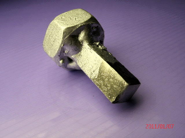

The sump plug with a square hole in the centre is the most usual one.
I have previously used the square shaft that links domestic internal door handles.
Easy to find, and with an ajustable spanner fitted as close the plug to eliminate twisting the shaft, works very well.
I have also made a tool with a short lengh of the shaft, welded to a large nut,
works a treat.
works a treat.
