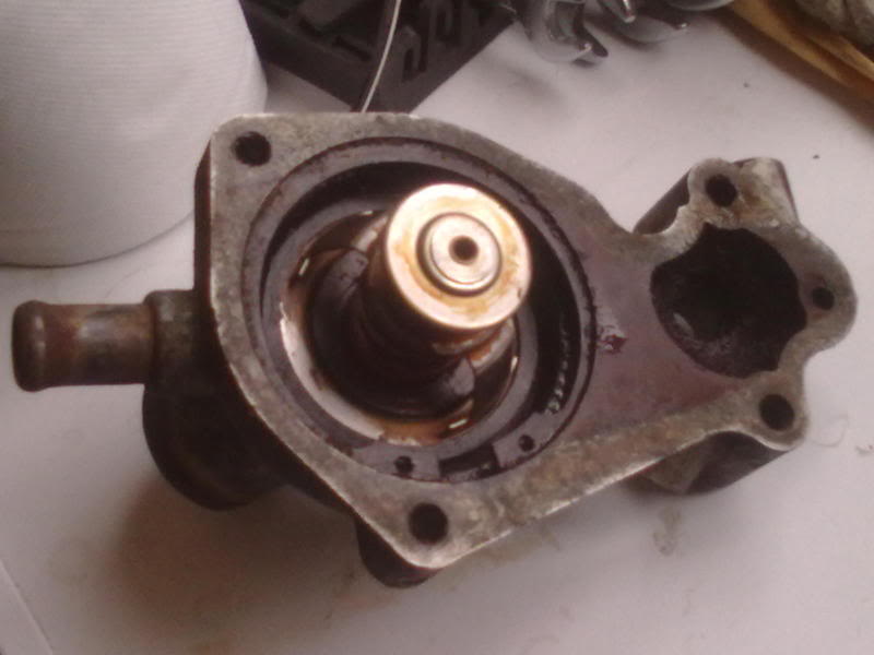

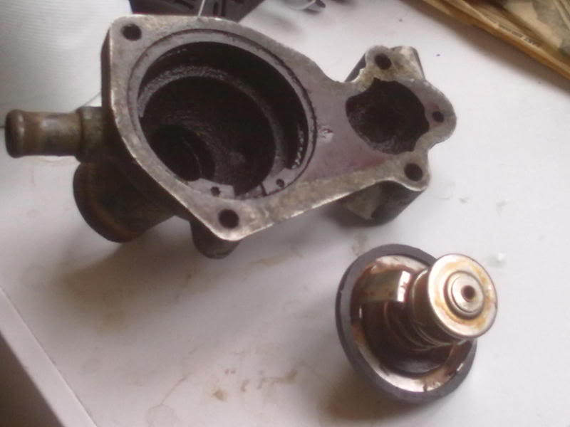

It is a bit of an effort to replace the thermostat. I did mine just as the really cold weather started before christmas. I had to replace the stat housing too, because the circlip had corroded into the housing.
Some clown had put a small stat in it, which was free to float about....it might aswell not have been there.
Gah! BX has been leaking coolant since the 'stat change, so I pulled the housing off, destroying the new gasket in the process. Balls. Tried bodging it up, but no joy. Naturally, I need the car tomorrow - will have to use the 2CV instead. Again. Has not been a good winter for the BX!

I didn't have a new gasket when I did mine, so I took the housing off VERY carefully, with the aid od a stanley knife blade.
for re-fitting, I coated each side of the gasket with a smear of blue Hylomar, to help it seal.

It's peeing out, so I think this gasket is a gonner. Anyone had any joy making their own? Cereal packets don't seem thick enough...
Or is it possible to get new gaskets somewhere?
I didn't use blue Hylomar first time around - which I'm now regretting.

Hylomar lets you get away with engineering murder! :lol:
FWIW, a cornflake packet gasket's holding just fine on my stat housing - after a year of hard use. All the gasket needs to do is take up any minor machining imperfections in the two faces of the block and the housing. In emergencies, I've done away with the gasket and used silicone sealant until I could do the job properly.
Provided the mating faces are clean, you'll be just fine with cornflake packet for your stat gasket. However, be careful with All Bran packets - as you can easily wind up in the du-du! :shock:
Thanks. I'll give that a go then. Shame the recycling's just gone...
