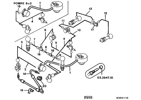

here are two pipes trade price and part No. that come up with your chassis/VIN No.
hope your sitting comfortably
95496828 HYDRAULIC TUBE 151.85 GBP 182.22 GBP 182.22 GBP
00004020XA HYDRAULIC TUBE 36.91 GBP 44.29 GBP 44.29 GBP
the second one is for cars fitted with 6+2 pumps which i dont remember ever being fitted, but thats what it comes up with,

Isn't that the special pipe (with the rubber parts etc.) between the flow distributor valve and the accumulator (#14 in the figure below), not the feed pipe between HP pump and the flow distributor valve (#2)?citronut wrote:95496828 HYDRAULIC TUBE 151.85 GBP 182.22 GBP 182.22 GBP
Isn't the broken one #2, not #14?

yes sorry pilot era try these
96034027 HYDRAULIC TUBE 12.84 GBP 15.41 GBP 15.41 GBP
95596564 HYDRAULIC TUBE 27.55 GBP 33.06 GBP 33.06 GBP
got you going there or it did me
the first one is for a GTI i dont know why it still comes up with two opptions even with chassis No. enterd,

That looks better.. at least it matches with my previous list:citronut wrote:95596564 HYDRAULIC TUBE 27.55 GBP 33.06 GBP 33.06 GBP
(Looks like johnbird's BX is not a 4x4 diesel after all..95 596 564 Diesel (1,769 and 1,905 l) WITH power steering (pipe length 565 mm)
95 596 541 Diesel (1,769 and 1,905 l) WITHOUT power steering (pipe length 975 mm)
96 113 764 Diesel (1,769 and 1,905 l) WITH power steering, 4X4 (pipe length 592 mm)

So it seems. I would still measure the broken pipe though and check that the length (565 mm) matches.johnbird wrote:ok chaps,does it appear that the part no i need to ask for is 95596564 ?

I have ordered. This part from a company called chevronics. Its being posted straight to my home. Part no matched a pipe so let's hope its right. Ordered four rubber inserts too so I will have some spare. With vat and postage with the inserts 50.40 so its not something I want to fix regularly. Chevronics said the lack of the nut on the mounting bracket of the pumpalmost certainly caused the fracture. Of the pipe. I have already found a new nut in my boxes of bits!
