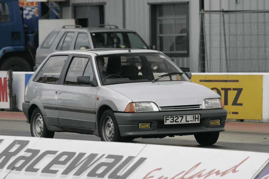

I bought a pot of water based transparent yellow paint, and it seemed to do the trick, on the fog lights anyway... I always wanted a set of those 309 GTi driving lights, with the yellow reflector behind clear glass.
This was the stuff: eBay link

That's the stuff I used on mine, and it's fine. Probably easier to remove if you need to.
I initially thought that it would start flaking off or not last too long, and regular applications would be needed, but 2 coats, leaving a day in between, and six months later it's still holding up well.
Water based paints have come on a long way since the '70s :twisted:
