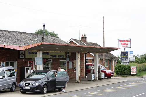

Thats what bullwinkle said. When i took my car in and told him about the steering. The first thing that he said was the hp pump might be going.
The thing is if the frount ones needed doing he would have done them. When i took it in last. But i could have a go see if it make any differnce It might do

They replaced the accuminter. It said on the recite x 1 accumintor spher
When i come up ill come with the papers on what they did.Theres alot been done to it. But still needs sorting out.
Put it this way ill reather go to bulliwinkle. Then medway any day.
If i could put down what hes done i would. But his writings all small joint up.
