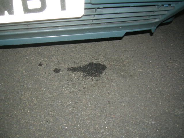

The BX has sat unused for a week on my Father-in-Laws drive whilst I attended the 2CVGB national. I went over yesterday to collect it and it started after about 6 or 7 seconds of churning and no pumping. After running for about 10 seconds it started to smell of fuel and chug as if it was being over choked. I managed to keep it going and drove the 3 miles home with no problems. However on slowing down outside my house, it started to smell and chug again, then died.
On walking around the front to open the bonnet I found this:

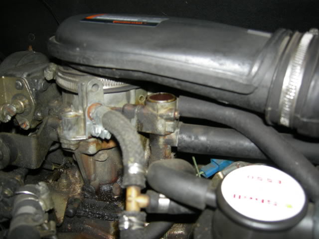

A growing pool of fuel that was dripping from the vent pipe that runs from the side of the carb here (the lower pipe)...
...and exits beside the rad.
On removing the air cleaner from the top of the carb I found that the front throat was flooded.

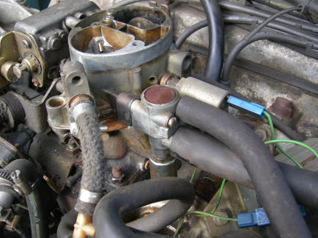

Firstly: What does the cylindar type thing do that the two pipes connect to? It has a spade connection on the underside.
Secondly: Are there any other reasons why the carb might flood.

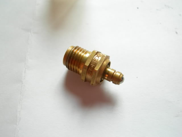

I removed the float needle valve and found a definate wear line on the sticky out bit...

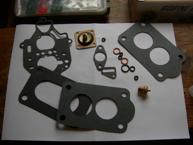

I hopped in the 2CV and went to see if my local motor factor could help. Unsurprisingly they didn't have anything in stock but they did tell me about Northampton Motor Sport Services who used to be Northants Carb Services. One quick phone call to a very nice (and knowledgable) chap named Steve and I was on my way to collect a service kit for my Solex carb.
Half an hour and 20quid latter I was the proud owner of this lot...

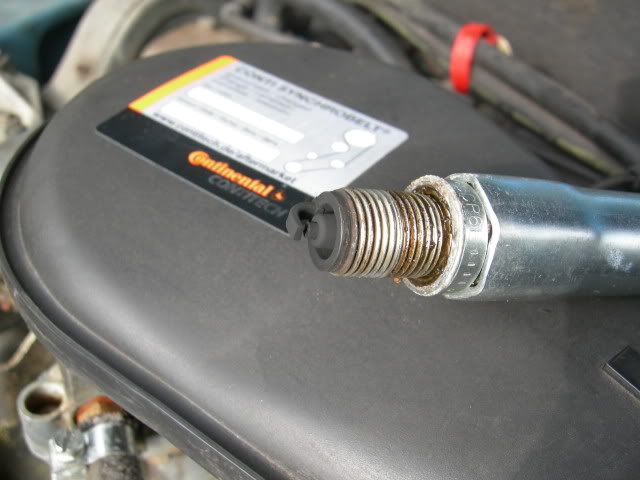

I put it all back together and after yet another plug clean to sort this out...
