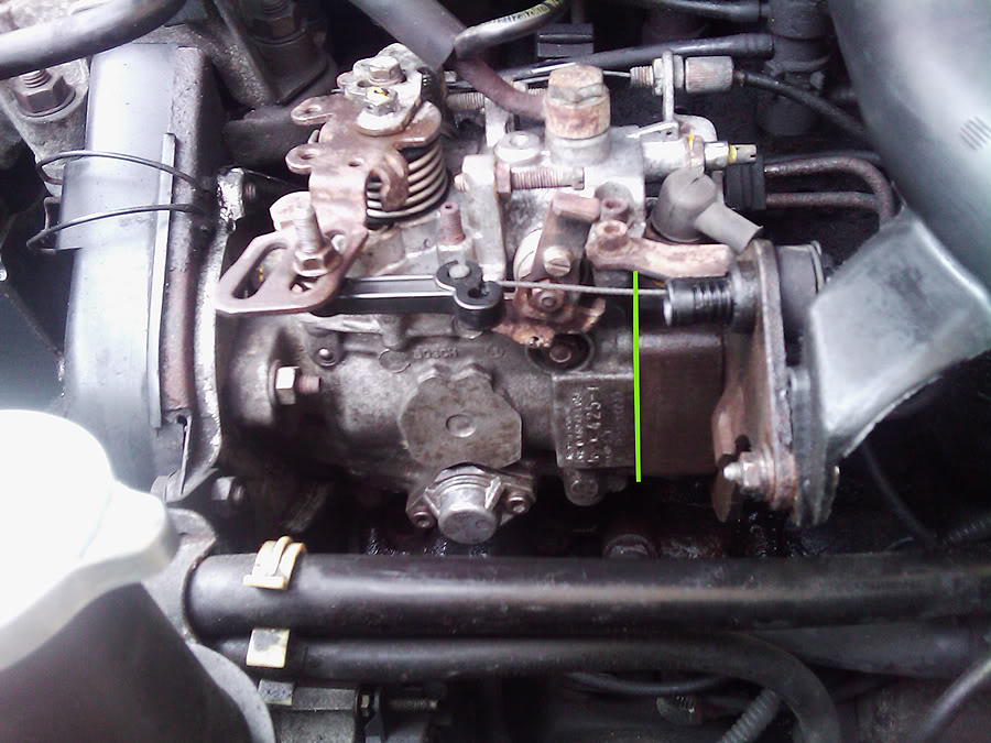

It's hard to tell, especially as normally it's parked with it's nearside up on the kerb, so a leak will naturally drip from the offside quarter of the sump. I still haven't discounted leak off pipes but once I've parked it on level ground for a while and run the car until the problem manifests itself again (it didn't last night), I should have a better idea.docchevron wrote: I assume it's dripping down the front of the sump? Or the cambelt cover end of the sump?

Transpires the leak - and it is minor - is from the rear area of the pump and not from either side. The cambelt isn't being contaminated and the pump doesn't appear to leak noticeably (it certainly doesn't drip) when it's running. But stopped, after a few seconds you'll get a few drips from the front of the sump adjacent to the filter/alternator.
Taking it down to Kermit on Friday where hopefully we can effect a repair. Fingers crossed. Kermit certainly seems confident it's not too serious.

Sounds like it might just be a seeping injector pipe, I find a cure for this is just to slightly undo the offending pipe before re-tightening which normally reseats the pipe curing the seep.

There is a little cover low down (both sides) on the Bosch pump covering the timing mechanism. It's possible that is leaking - I've had that before. I had to take the pump off to replace the O ring though.
EDIT - when you say the rear of the pump do you mean as viewed from the front of the car or from the cambelt end? If the latter I would be inclined to agree with Kevan.

A bit of both - it's behind and possibly to the right - as you face it from the front of the car. Anyway, it certainly doesn't leak enough to make me a menace to other road users (especially bikes) so I'm off to Worthing on Friday morning and let's see what the Green Frog can do

i have been told by a diesel fitter that if the one way valves at the feed and return banjo unions stick, this can/will cause presure build up and leakage from any seal/s,

Well, we have located the leak, and not been able to fix it. The leak's not bad - leaving a drip here or there, but it is a problem.
It's at the back of the pump - facing it from the front of the car - where the two bodies of the pump meet. Kermit (Phil Boxall) checked, cleaned and tightened what he could, but we need to remove this pump and fit another (a better option than repairing the existing for us). Although Phil has at least one spare Bosch pump these are from turbo diesels - will that make a difference?
Alternatively can anyone please help if they have a 99% known-decent pump from a 1.9n/a? If you can get it to Kermit he can get it cleaned and checked over by the local marine diesel place, and assuming it passes the test, it can be swapped with mine (which will then be offered for refurbishment if anyone wants it).
