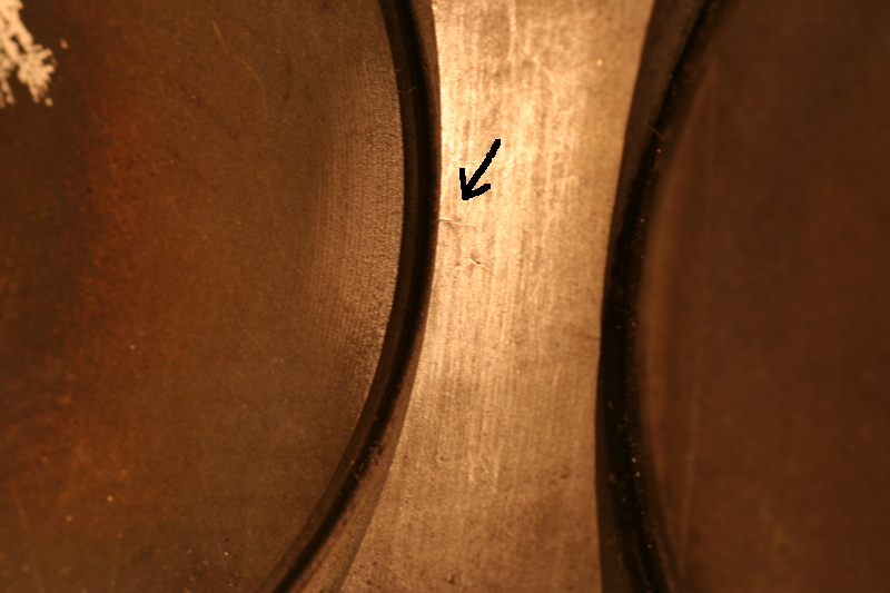

2) I dug up some of the photos I made when the head was off and re-discovered that indeed there is a very small crack between two valves as seen below. I suspect I was over-confident or naive enough to think that it wouldn't be a problem (after all the guy that skimmed the head said it was in good condition). What is your opinion on this crack?

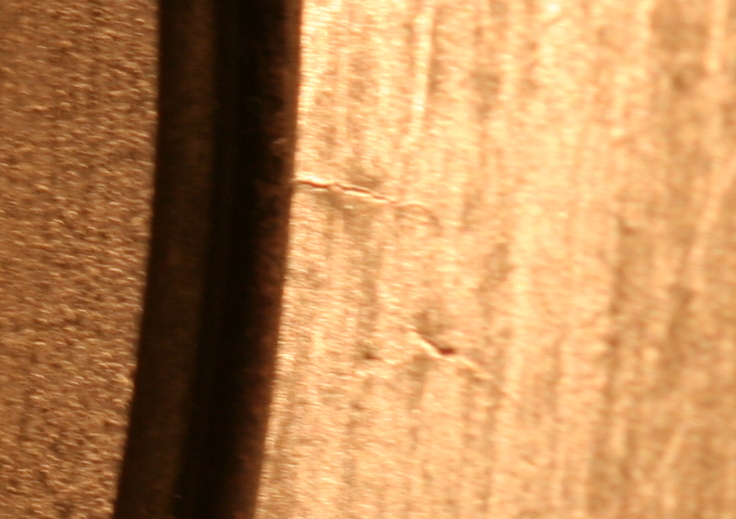

Closeup:

Hi just to settle things a bit, get to a garage which has a gas analiser and get them to 'sniff' the gas bubbles in the header tank. Any combustion gas will be identified and will denote :-
crack - most likely looking at the picture.
head gasket maybe.
warped block face.
but what ever a definite leak from a cylinder into the coolant system.

A good test for an external cooling system leak but if that pictured crack is responsible then its going to be harder to force water at low pressure through it than the ease with which hot gases at higher pressures will go the other way.

From my experience with xud engines cracks across the valves are quite common and i regard them as normal and usually ok. I've refitted many heads with quite deep cracks across the valves with no problems. One of my own cars used to blow the head gasket approx every 35000 miles (3 times) until the last time my friend who assisted noticed there was damage to the block in between cylinders 3 and 4 . He smoothed the damage with an oil stone so that it was an undulation rather than a pit. The head was refitted without skimming and it lasted another 6 1/2 years until the car was scrapped because of rust. I agree with Andy just take the head off again and check the block with a straight edge and if ok i'd source another head to be on the safe side. I'd say the crack in your picture is ok but there may be hidden cracks in the combustion chambers.
